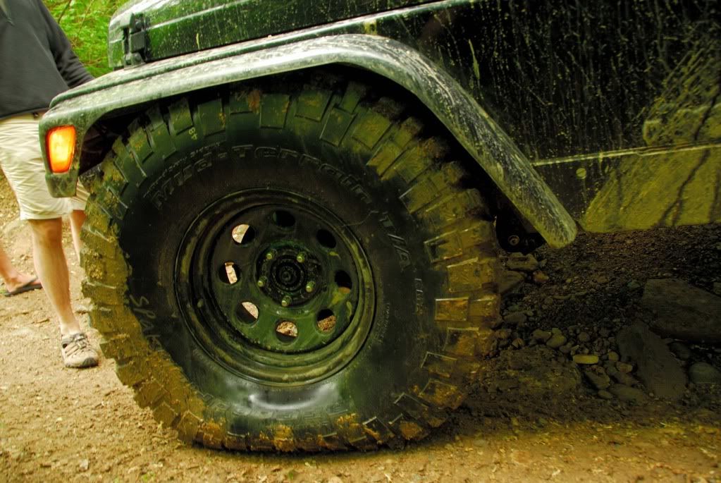

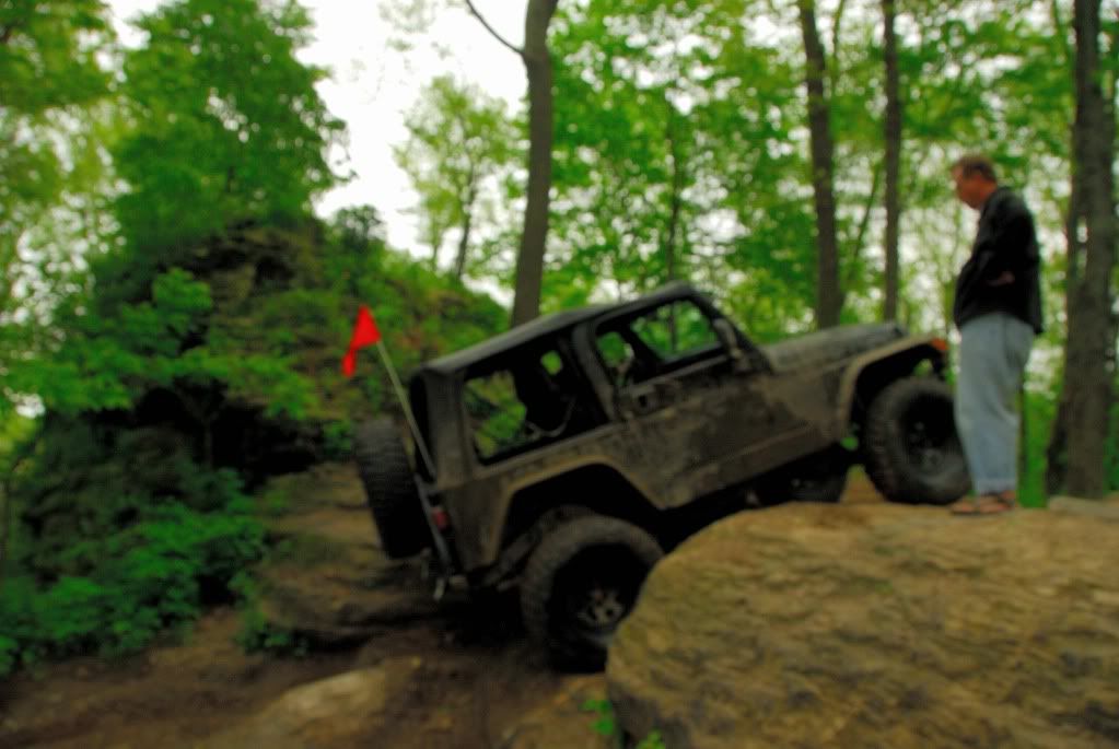

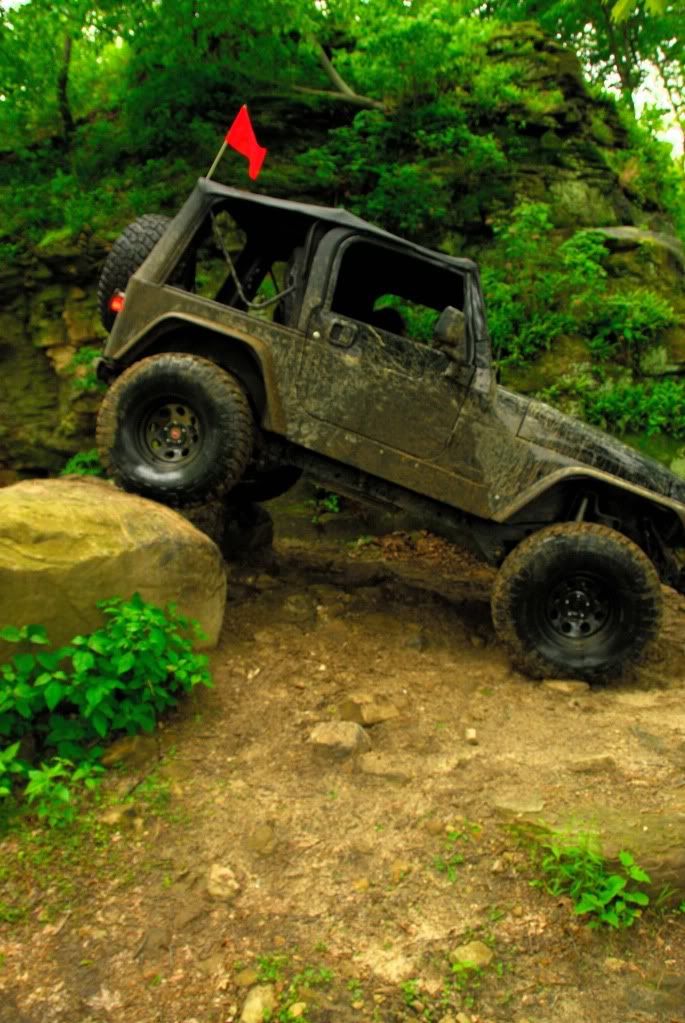

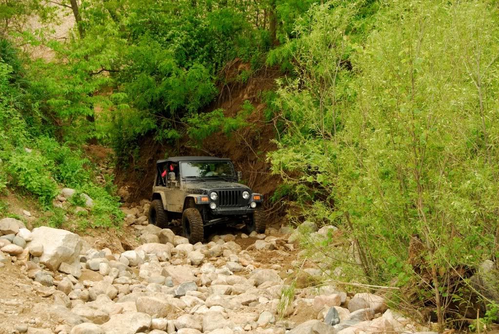

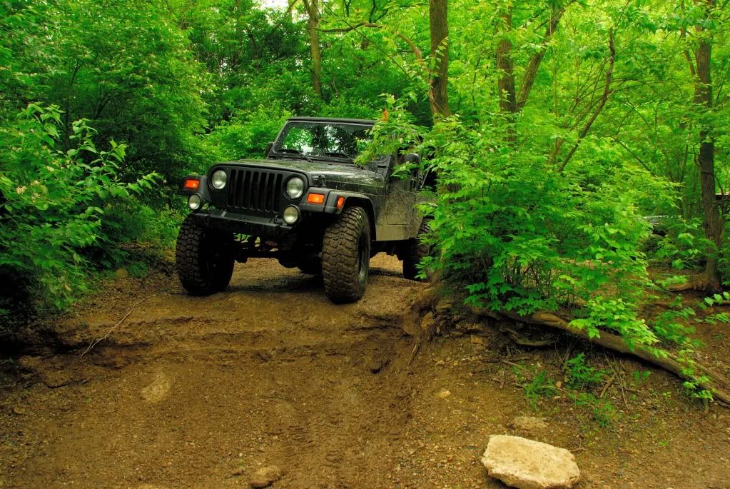

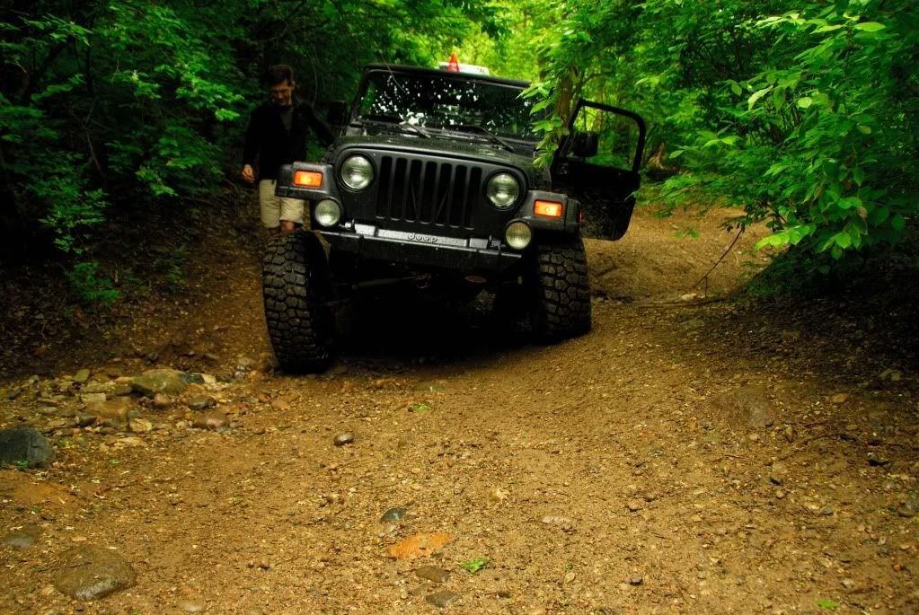

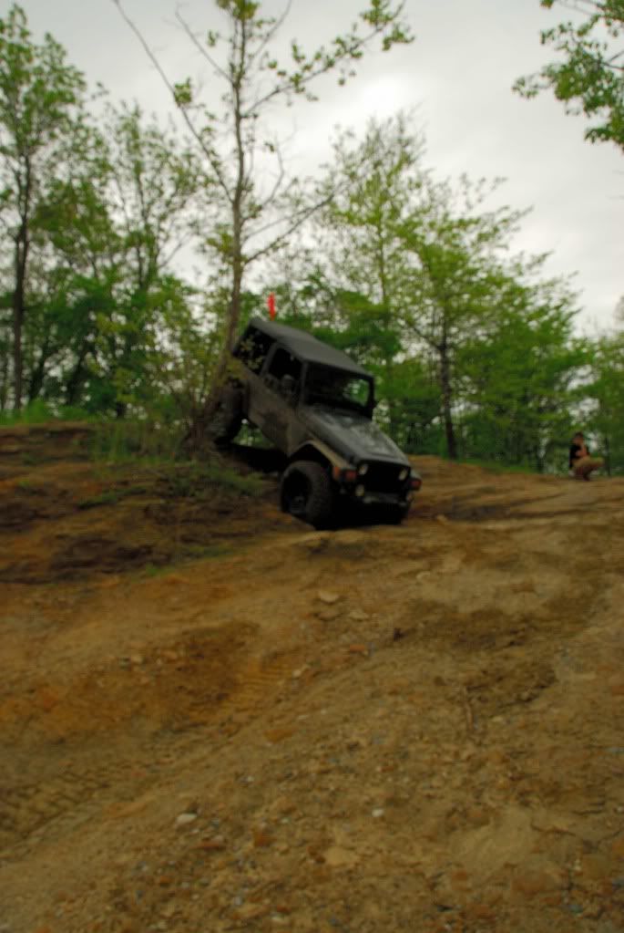

Took her up to the Badlands on Friday with some IndyORV buddies....performed awesome. Tons of belly and diff clearance, bump stops were PERFECT (as you can see)....couldn't even fit my pinky in the wells. And who says under 3" can't flex with 35s....

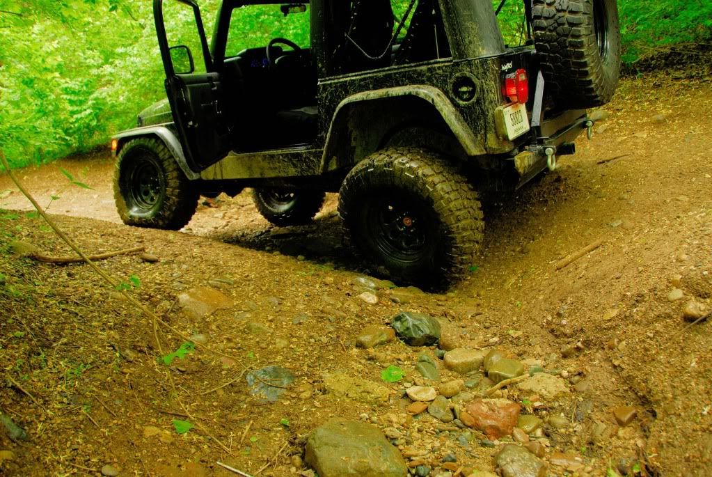

Does it look like I'm lacking in what you call "flex?"
