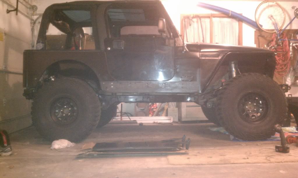

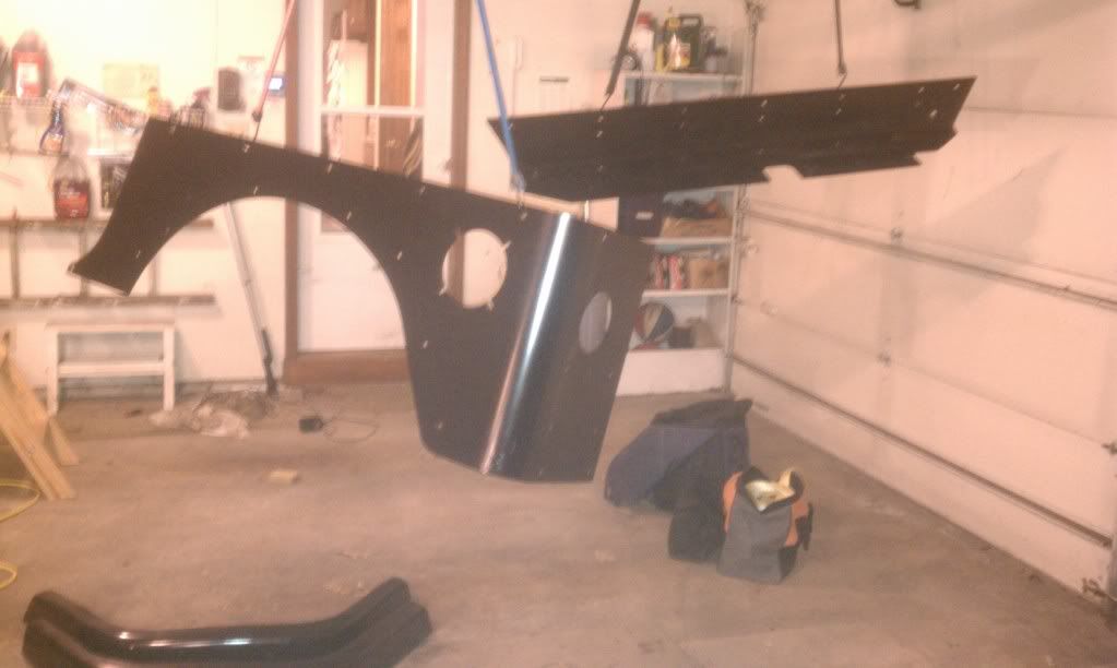

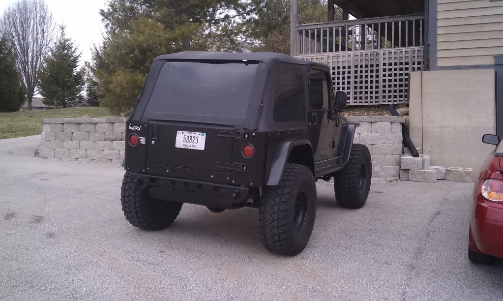

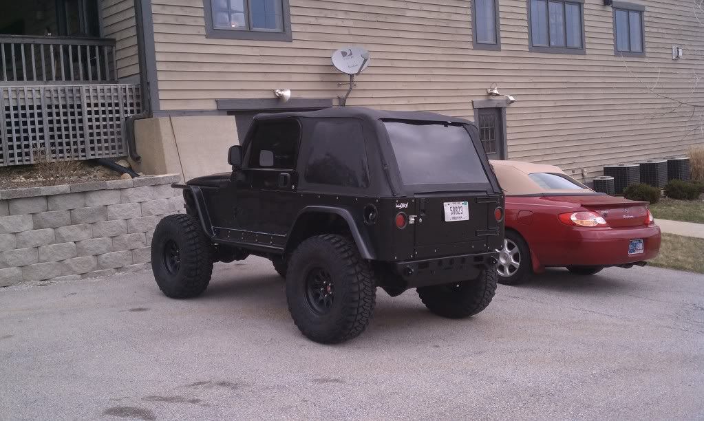

In other news, the jeep is painted and reassembled. I removed all of the armor (including tailgate), cleaned up the tub and painted it with Rustoleum semi gloss. I did the same with the armor. Everything is dry and sealed up and turned out really nice. I also put my trimmed Rubi rear flares back on just for something a little different.
Armor off, tub painted:
Corners and a rocker guard:
Finished:

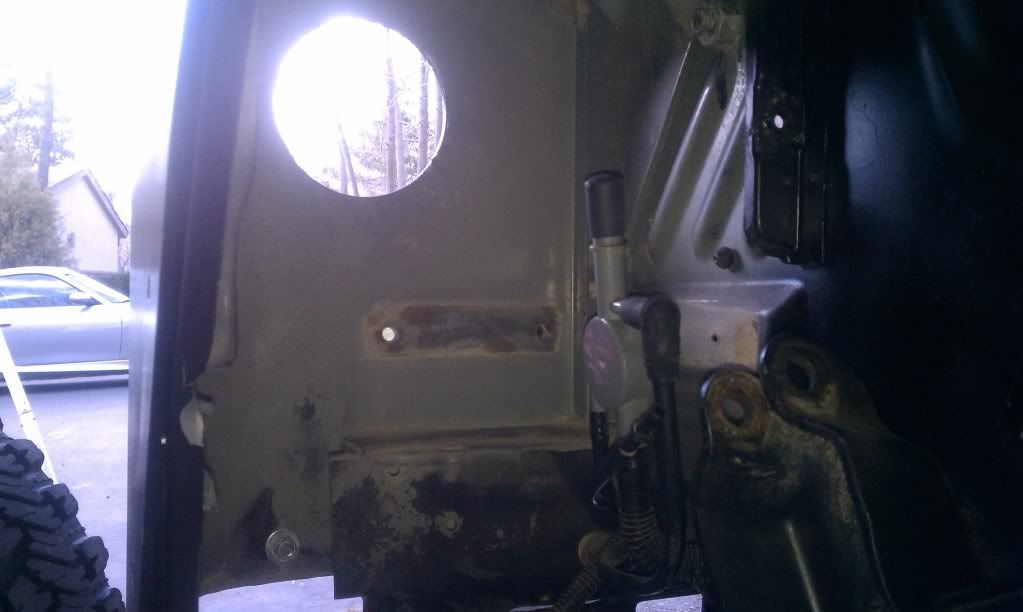

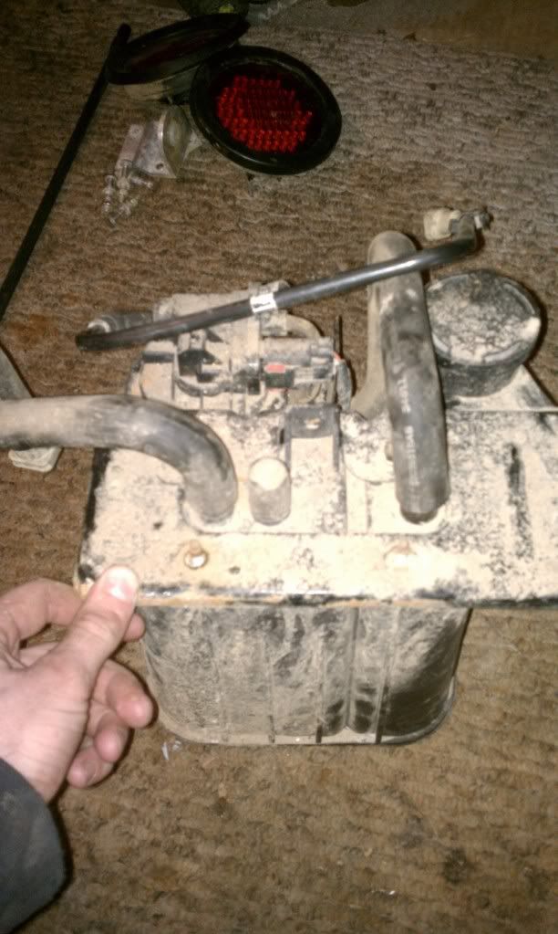

While I was at it, I wanted to get rid of the charcoal canister and to simplify that passenger rear corner. I took out the whole assembly, removed the canister, ran the single hose, and then started thinking of the best way to mount it. I ended up scrapping the assembly bracket alltogether and also removing the shelving in the tub. The two remaining pieces of the evap system are now just bolted to the front plate. Simple, clean, and much more available space.
Before:
After:
Shelving removed:
Painted:
Bolted up:
No CEL, nothing is different. There's a ton of room back there now and nothing to hold mud. I can now easily fit the tail light in so that it fits totally flush, as well. This will make running a fuel cell and stretching the wheelbase much easier now.
