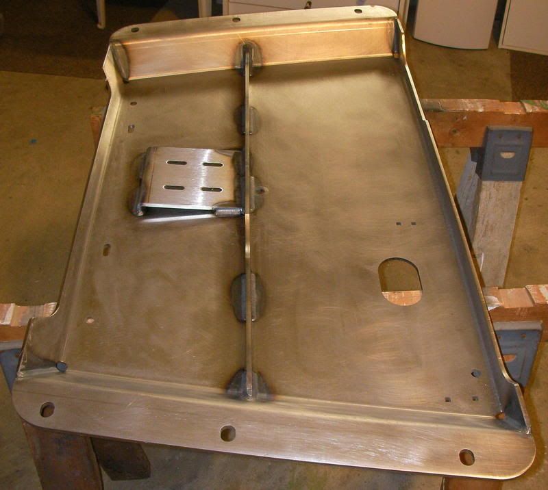

i got a skid cut from eddie(Besrk) and i was wondering how you made the center mount to recess the bolts because im going to recess the side bolts as well with a 1x2 tube.. I made a small little mount that i think will work fine just gotta drill press the holes tomorrow.

To recess, just copy the stock skid or any other skid. Large holes or slots in the skid itself and smaller slots in the center mount corresponding with the skid holes. I'm telling you, just use the stock skid as a template. I used my Rokmen skid as a template for all dimensions and surprise surprise...the new skid fit just as effortlessly as the Rokmen.

i was planning on that. Did you use C-channel for the center. I just welded up some plate to a piece of 1x1 angle iron.

No, don't use c channel.
Not my picture, but here's the Rokmen.
Just simple angle iron with one side cut down. Notice how the Rokmen piece slopes up to a height of almost 1"? Mine only comes up 1/4" over the same distance. That's 3/4". Combine that with the 1" the LoPro mount can gain and you can go up in belly height by almost 2" without raising the drivetrain at all.
