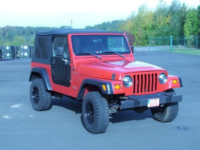

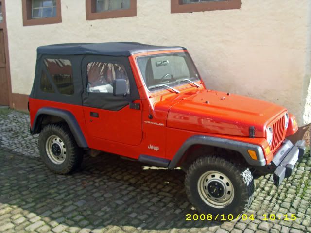

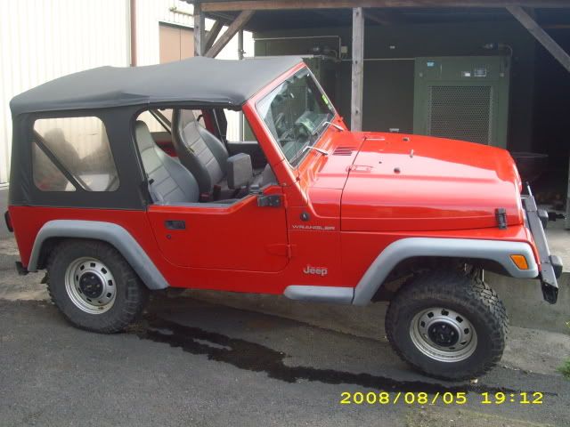

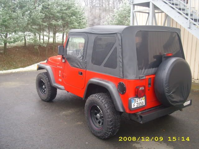

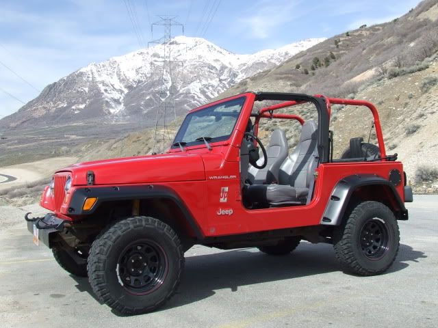

I bought Rhonda (98 TJ 4cyl) in 2008 while stationed in Germany (Air Force). No lift, stock rims, 30x9.5x15 original GY M/T's.The PO's did not take very good care of her. The stock interior carpet was nasty and stained. It had the original soft top in VERY rough condition; so bad that the rear window was nearly white, cracked and stuck in the "rolled up" position all year long. On top of that, foliage from the previous fall and some animals looking for a spot to die had made their way into the rear of the jeep, further soiling the interior carpet. Although somewhat cosmetically trashed, I thought, with a little cleaning, it would be perfect for me!
Obligatory poser pics right after purchasing:

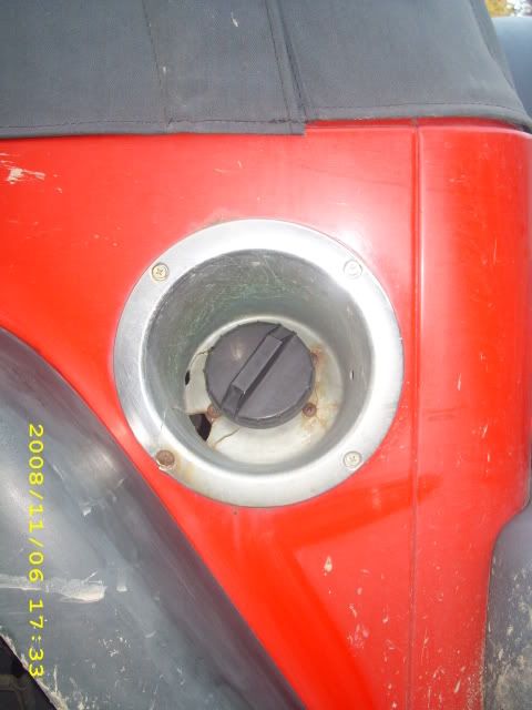

First things first: clean up the broken soft top, get some new rims and fix the fuel filler bezel:

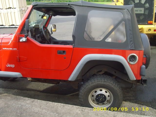

Fuel fill bezel before:

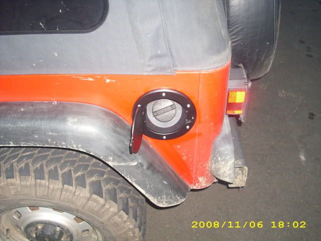

Fuel fill bezel after:

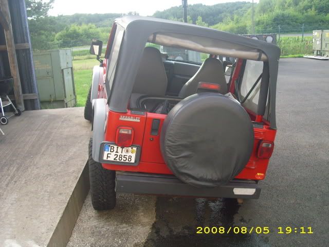

New Rugged Ridge soft top:
As you can see from the above pic, I also tried to "stain" the fender flares with some random stuff from Q-tec...it didn't come out good at all! So I just stuck with it until I could afford some better looking fender flares.
New wheels:

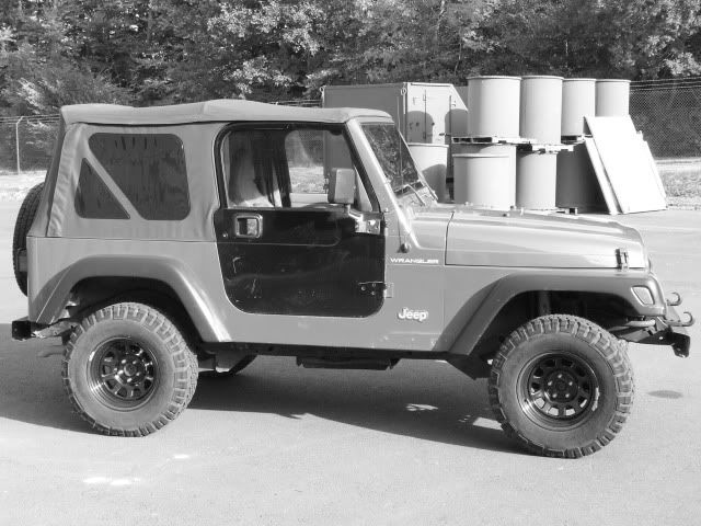

Next logical step was to lift it. I went with a 2" BB w/OME shocks from DPGoffroad.com. Being new to the jeep scene, Dirk over there was extremely helpful and knowledgable and I HIGHLY recommend them! Awesome customer service. Sorry no great pics of install or immediately after...

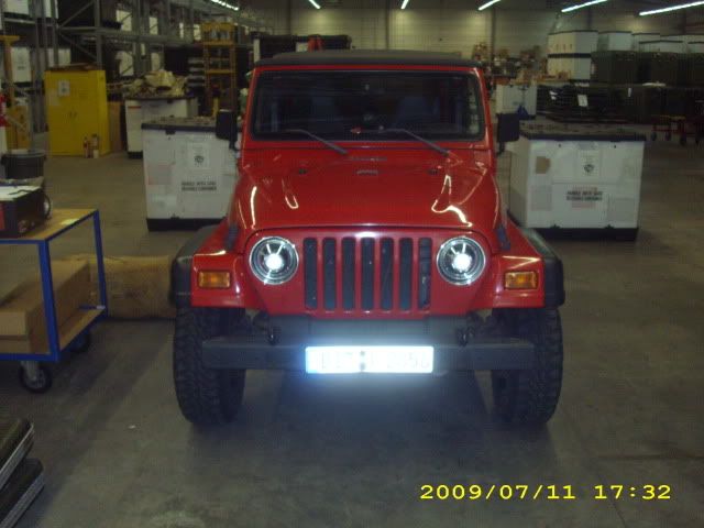

Driving around dark backwoods of Duetschland, the stock lights weren't cutting it. So I upgraded to the Sylvania Silverstar replacments. Although they were a small improvement over stock, it just wasn't enough for me (sorry no pics). So after saving up for some QUALITY HID kits, I ran across a screamin' deal on JF for some Sylvania Xe7 projector headlights. These are LITERALLY night and day difference and well worht the money. Also added Rubicon fender flares and tow hooks...
Installing:
aiming low beam:
aiming high beam:

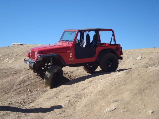

First order of business, lift and go to 33s. I chose RC 3.75 combo lift (2.5" SL/1.25" BL). Wishing I stayed w/OME or at least DPG offroad but I just couldn't afford it. Here's the 2.5" with some used 33x12.5 SS. I loved those tires and can't wait to get another set, now that it's not my DD:

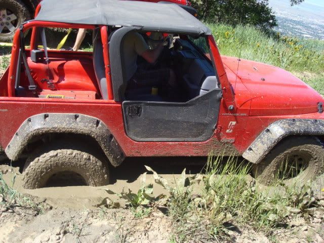

And some wheelin:

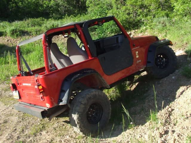

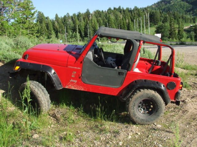

now that I was driving around on basically bald SS, it was inevitable that this would happen:
What I didn't expect was for it to happen on the highway and take out my fender flare completely...

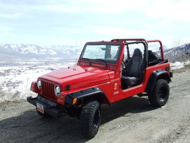

So it was time for some new tires and I decided to go fender flare-less for a bit because I liked the look. I went with 33x12.5 Duratracs--Awesome tires for a dd! I also got around to throwing on the 1.25" BL.
Also bought a homemade bumper on JF. I haven't gotten around to cleaning it up, but as you can tell, it could use a good sanding and some paint. I grabbed some grade 8 bolts and threw it on.
Time to test out the tires and get some poser shots:
Next I needed to cover up those tires a little better so the cops don't hassle me. UT vehicle regulations are pretty intense and thankfully (knock on wood), I've never received a ticket or been pulled over for my non-compliance. And some random wheelin' pictures:

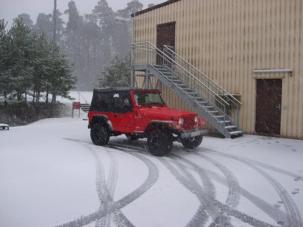

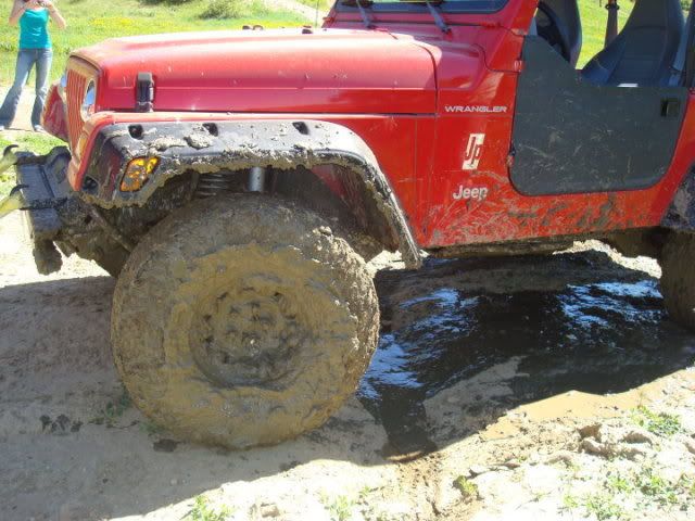

SNOW WHEELIN! I'm stuck. Funny part is I was attempting to climb a hill right behind me and finally made it up after about 10 attempts. As soon as I made it up, I sink in to about 3-4 feet of snow. Wheelin in the mountains will do that. Good times.

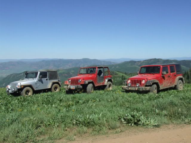

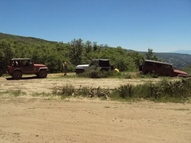

Pics from the all Jeeps event today. The pic of the yellow jeep is from some knucklehead going way to fast over the woopty dips and jump it. He got air and landed on his front tire deploying airbags flattening a tire. The part that annoys me is the guy had his kid (around 10 years old) in the back seat and apparently bashed his head against the front seat. Father of the year award. Anyhow, they ended up both being just fine.

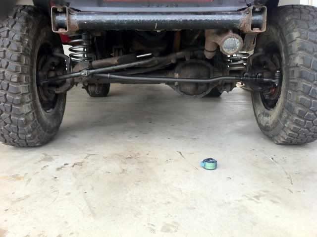

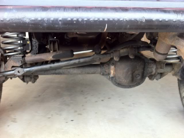

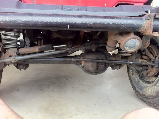

Although not much, my spending money this check was burning a hole in my pocket. I decided to do the ZJ tie rod conversion given the fact that my stock bar is bent to crap from a rock garden in American Fork Canyon. So, off to good ol' AZ I went. I picked up the part #'s identified in Stu Olsen's write up; Included the one piece tie rod/end, adjusting sleeve, and the other TRE.
With the rented pickle fork from AZ, I had some major issues trying to separate TR from the drag link. My puny hammer couldn't handle the task. So off to Lowe's to pick up a 4.5lb mini sledge. It made short work of the ball joint connections w/the fork.
When setting up the new TR I realized that the it didn't come with a zerk fitting/hole for the TRE that connects at the drag link. I did some research on here and thought it was a mistake. After wasting another trip back to AZ, I found Duralast manufactures all these part #s w/o a way to grease them while installed. O-well. looks like I'll have to remove it to grease it...
From there on, everything went extremely smooth,; I bolted up the new BEEFY tie rod and torqued to spec. Since Rhonda is not my DD, I eyeballed the alignment and called it good. I'll still need to get a real alignment before I do any type of real driving if I expect to have any tires left. It's a dam good thing I bought an unlimited lifetime alignment from Bridgestone; That purchase has paid for itself more than a few times.
