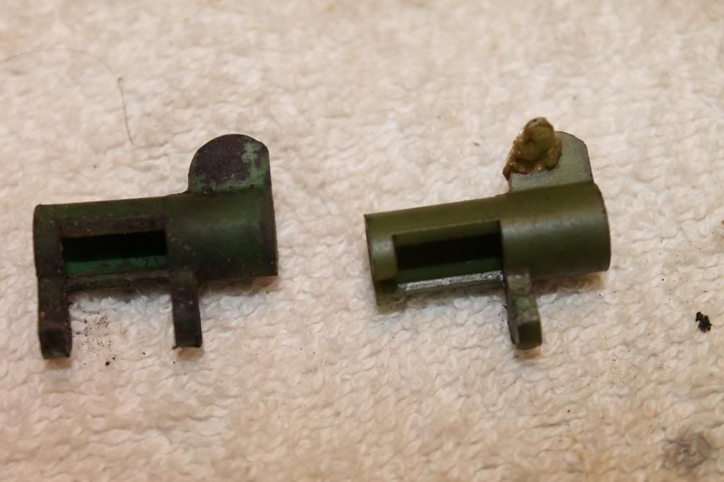

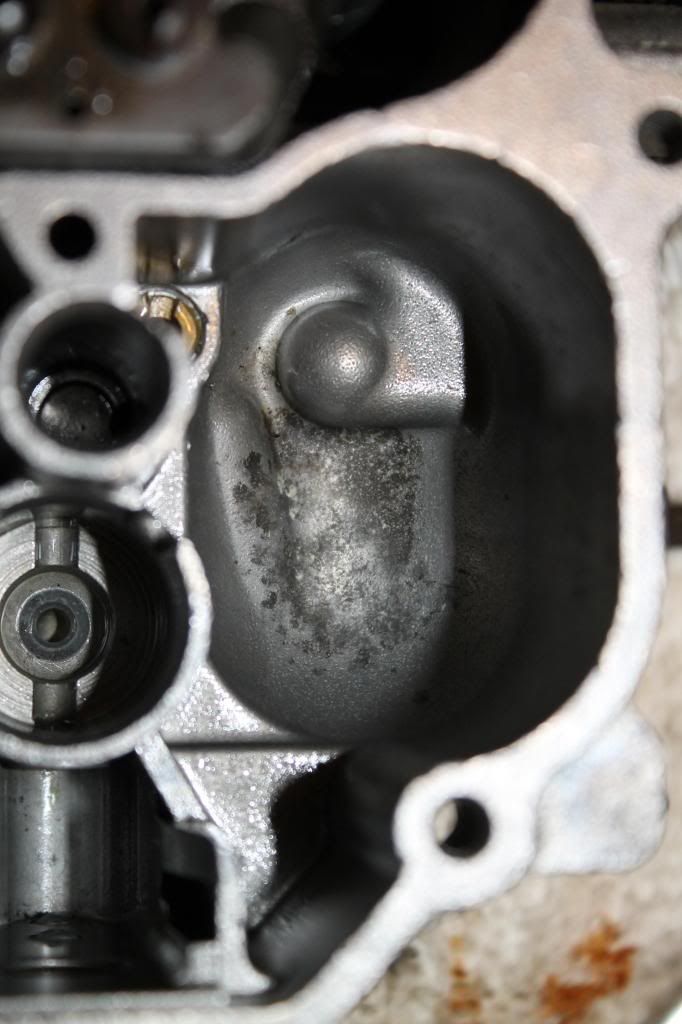

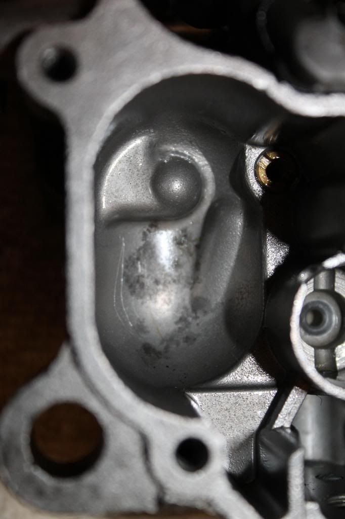

The only weird things I noticed was the small metal ball in the wrong part of the carb and a piece of the metering rod was melted and broken off under the piston assembly. Luckily, I still had my old toasted carb and the metering rod was a bit dirty, but in pretty good shape on that one. The float was also not set at the correct height. Here's a few pics:
Here's some pics of when I cleaned it a few nights ago. Those spots wouldn't come out even after letting it soak for a while. It was also smooth to the touch like the stuff wasn't even there:
Here's a pic of the metering rods. The bottom left piece was broken and the tab was melted on the right one.

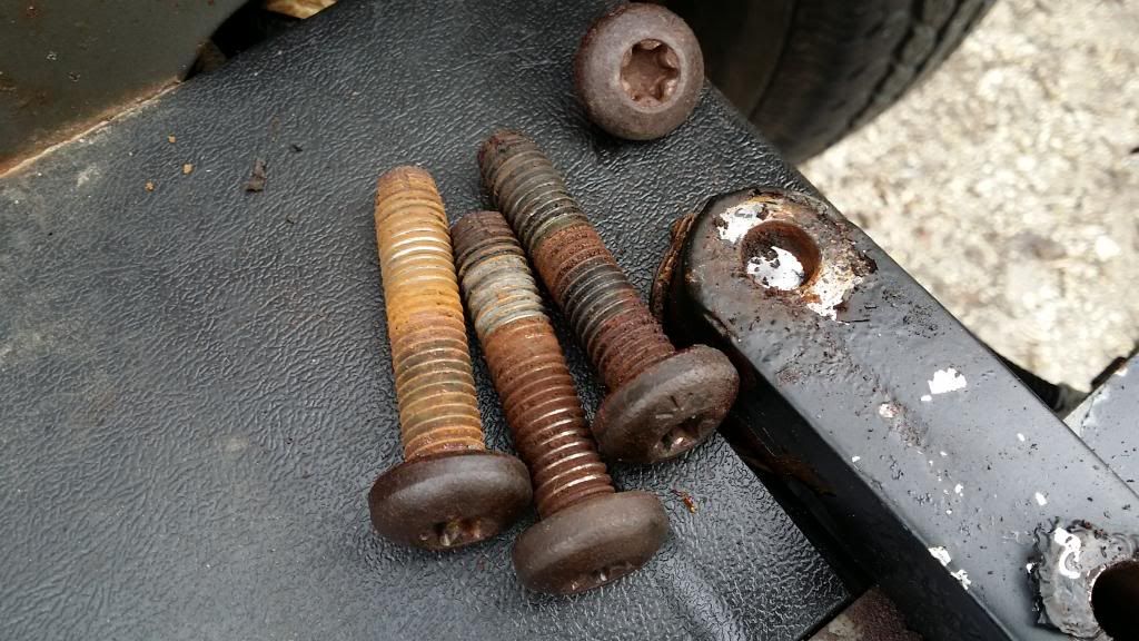

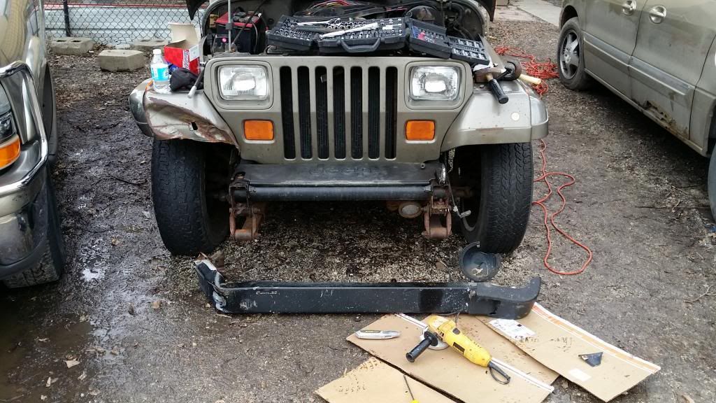

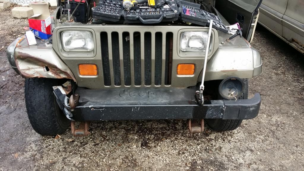

Also, today I was in the process of fixing dents and taking the front bumper off so I can get a new one ordered, but I guess the bumper had other plans. 3 bolts came out fine, 1 broke off and the other one is stripped. Great. Should I just grind it off and drill it out or what?
Edit: Scratch the bumper question. Grinder + Hammer = Win
Few pics:
Before Bumper Removed:
After Bumper Removed:
Rusted Bolts:

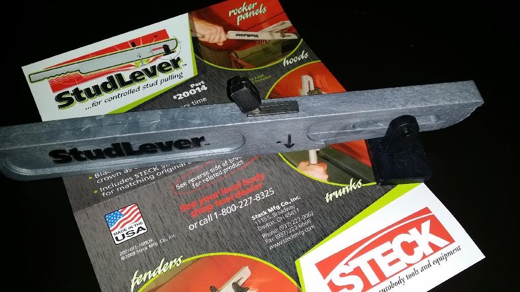

The slide hammer was a bit annoying. It kept slipping off and the studs kept coming off, so I ordered a Stud Lever. It came today about 2 days in advance. I'll try this out later on and hopefully I didn't waste 40 bucks. I've seen nothing but good reviews, so I'm hoping it'll be as good as they say.

The stud lever seems to work better than the slide hammer, but it's too cold today for body work.
