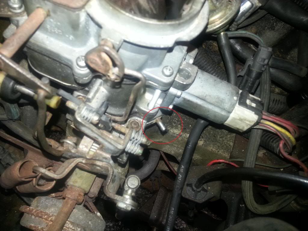

Posts: 61
Got the carb on. Had to switch a few parts around from the other one, but I guess it works now.
I've looked at the diagram, but I can't figure out which hose connects to this. Does anyone have a picture or something they could post please?

jenglish421
Location: chicopee
Posts: 97
It goes to where my hand is, it's above the valve cover on the firewall dead center of the engine compartment

Posts: 61
Thanks!
