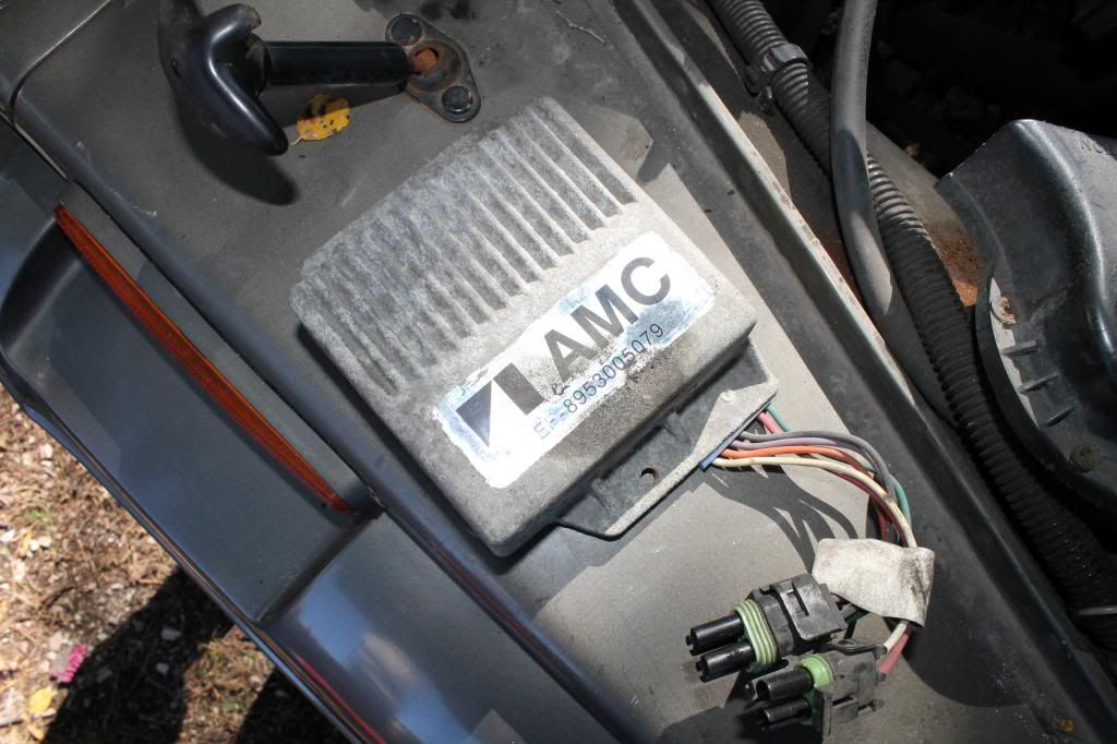

Hey, so I'm trying to get started again but it isn't getting any spark. What do you guys think it could be? I'm leaning torwards the ignition coil, so I'll test that out when I get home. Just wanted to see if anyone else had some good suggestions.
Meepz is offline
post #19 of 91 Old 09-28-2013, 12:52 PM
Michaelgoesrawr
Michaelgoesrawr's Avatar
Location: Pinion Hills
Posts: 8,809
Icms are notorious for going bad in these. That's what I'd bet.

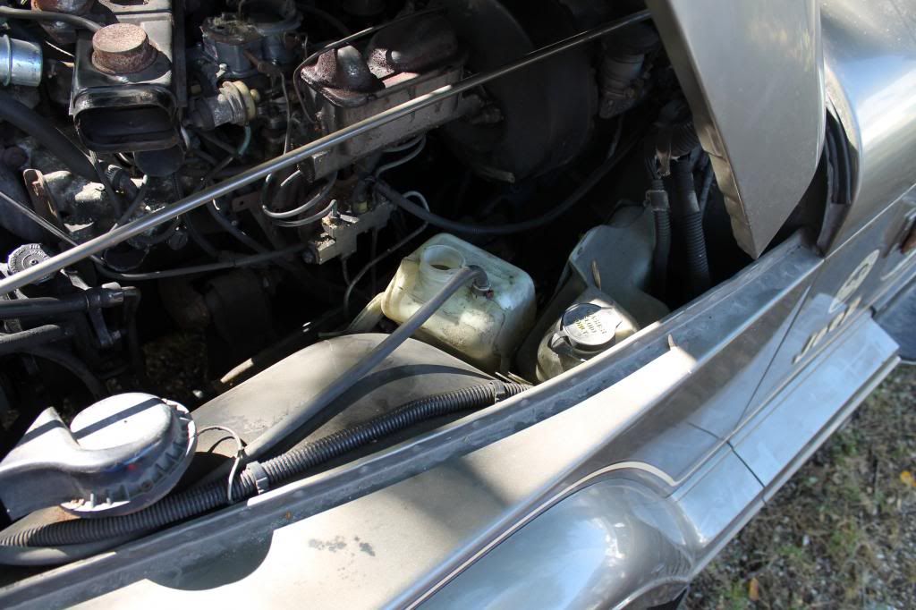

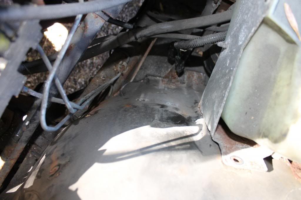

Got the ICM out only to find that none of the Auto Zones near me can test it. Great. I'll just try to find some parts at a junk yard tomorrow since they're closed on sundays. I'll post a few pics if anyone needs to know where/how it's removed.
Here's the ICM:
Mine was under the washer reservoir (2 or 3 screws):
3 screws under the wheel well to take off the ICM:
