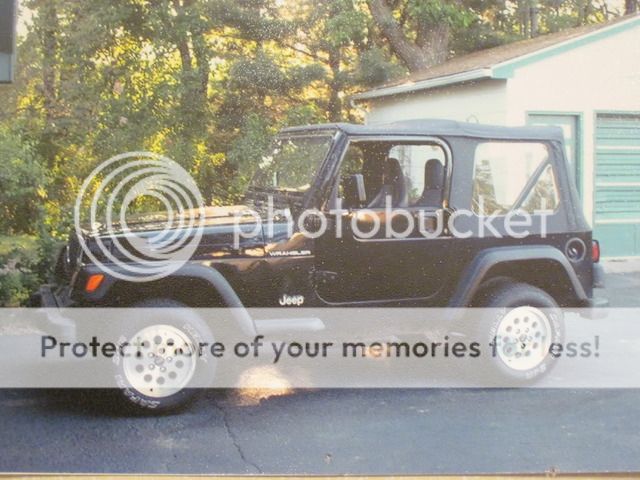

I looked at a couple old YJ's in Minnesota, I wanted one really bad and was just going to go buy one. I looked at an 88 YJ that had a lot of miles on it and holes in the floor, but that I could pay cash for. I thought about it, and really the only reason why I didn't buy it was because I would have nowhere to park it, and it was winter and it had only half a floor. I also looked at some that I probably couldn't afford at the time.
I wasn't able to enter the Jeep family until July when I swung a deal and brought her home. 1998 TJ SE
Please excuse the crudity of these photos. This all happened before we had a digital camera.

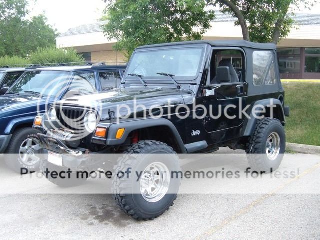

I bought just your basic run of the mill SE. It was all I could afford at the time and pay cash. Couldn't afford a car note while putting myself though college.

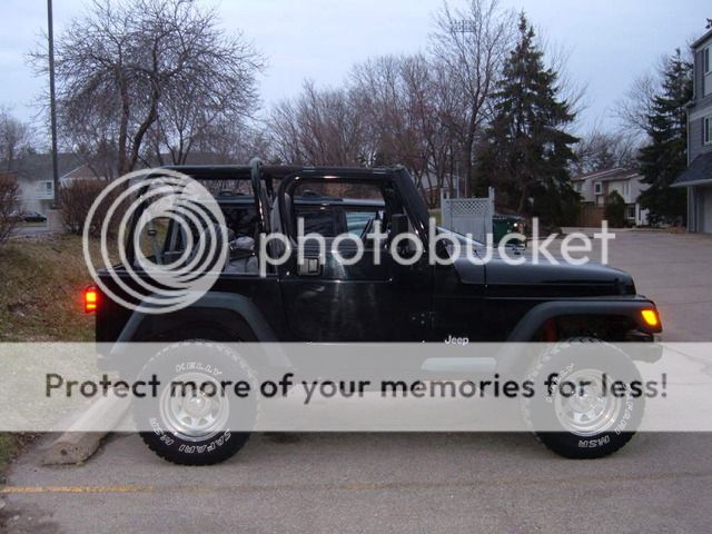

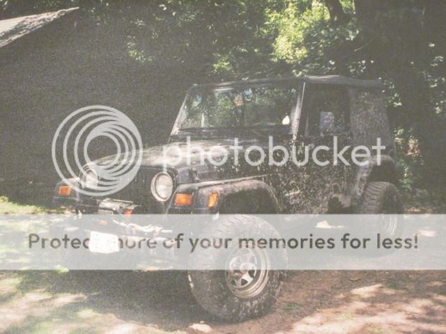

One of the first things that many people do, and myself included, is upgrade to 31's. I drove about 1 month on those dinky little 215/70/15's before I was sitting at a much more appropriate stance.
It wasn't too long before rubbing became an issue and actual lift needed to be applied. On a shoestring budget I opted for the Rubicon Express 2'' budget boost with shocks, and a 1 inch body lift. I hadn't even had the Jeep for a whole 6 months yet and I was already hooked.

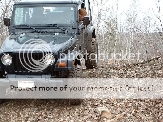

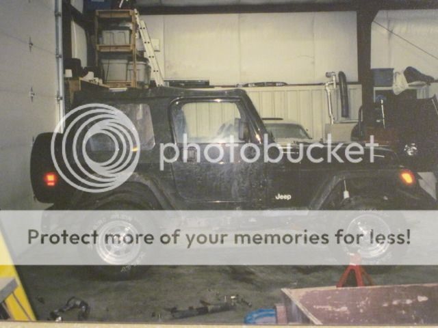

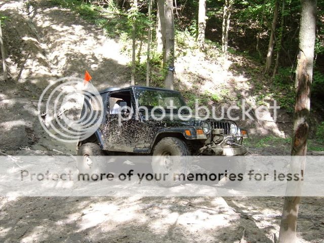

I remember right after this I went out on some of my friend's family's land and high centered myself pretty good. Still had a lot of fun.
I wheeled a good porting of college, more expedition type wheeling though because I was deathly afraid of breaking anything for fear I would be out a vehicle for sometime if something were to happen. We wheeled the riverbeds of Southern Minnesota and the Blue Hills of Northwestern Wisconsin. Had a lot of fun, saw a lot of nature, and always wheeled on public or private land with permission.

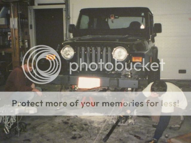

Later that year I added a rear bumper and tire swing from LoD and a Harbor Freight winch. I was exploring a lot and having a lot of fun.

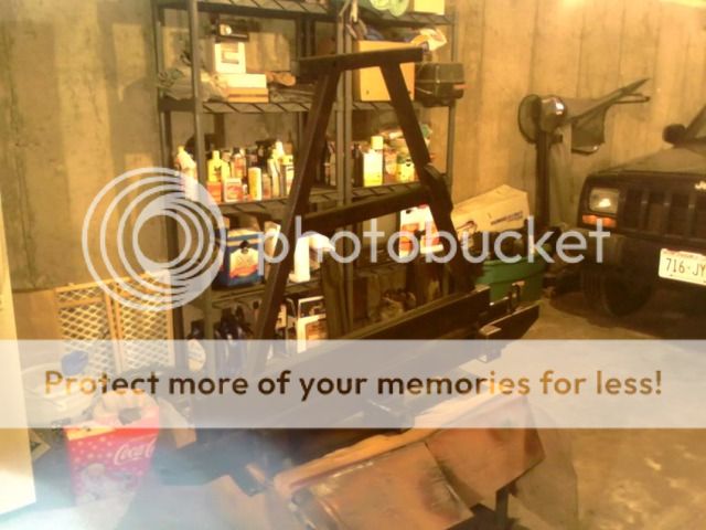

I had no rear tire carrier for a spare tire that was too small. The frame was starting to rust as was the body. The electrical was shot, battery toast, tires bald, broken sway bar, top worn out. It really was a sad site.
So I went about making the repairs. I addressed the frame first using a grinder to remove all the rust and then resealing with rust treatment and a UV resistant paint. I was still driving this at the time too.
I fixed the rear bumper and the winch plate, rebuilt the winch as well. 6 years of trouble free pulling from the HF winch.

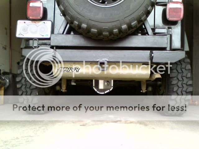

The guys in my Jeep Club are great and really helpful. The president and I installed an Aussie Locker in the front Dana 30 to increase traction. I love it, it works great.

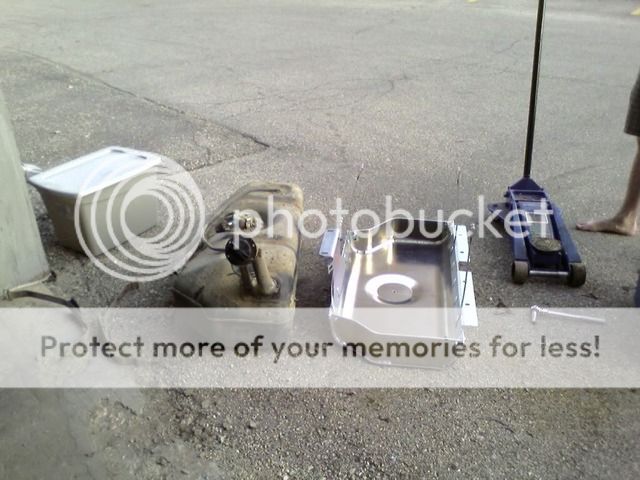

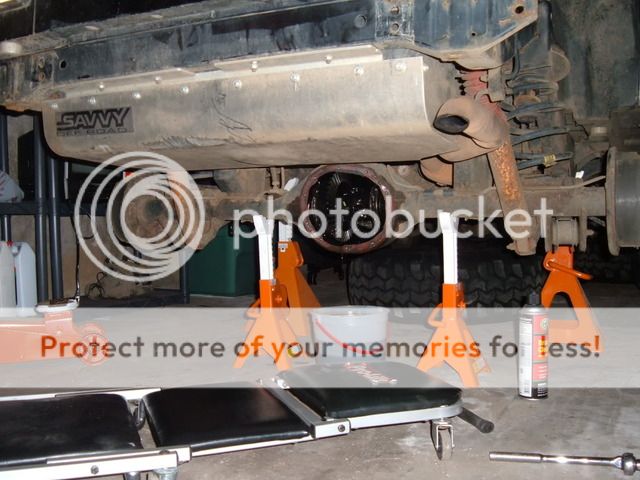

I also got on the Savvy bandwagon and grabbed their Gas Tank skid on special. It also is great. Really softens those hard hits to the tank. Highly recommended.

that D44 you will love. Im thinking about getting the savvy gts, was it a hard job to tackle?
My end goal is 35's running 4.88 gears for the 2.5L I can't see myself going bigger than that. Not on this Jeep. I can't wait to get the thing installed finally.
I thought the Savvy Gas Skid install was pretty easy. I had the help of a friend and we did it in about 2 hours. Make sure your tank is empty or near empty. The BL and that extra inch made it easier to get my hand in there to disconnect the fuel lines. Made seeing what I was doing easier too.
I like the Savvy Skid because it doesn't corrode like the steel ones do, and it is I think about 3-5 pounds heavier than stock so that is huge as well. 2 mounting settings, one for BL, one for stock. It really absorbs hits well.

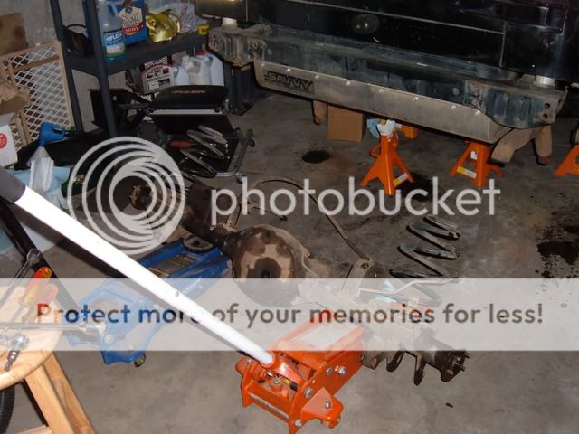

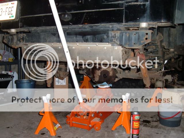

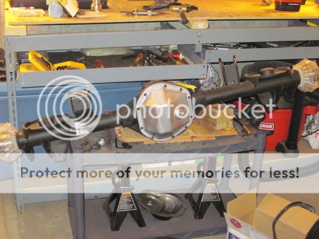

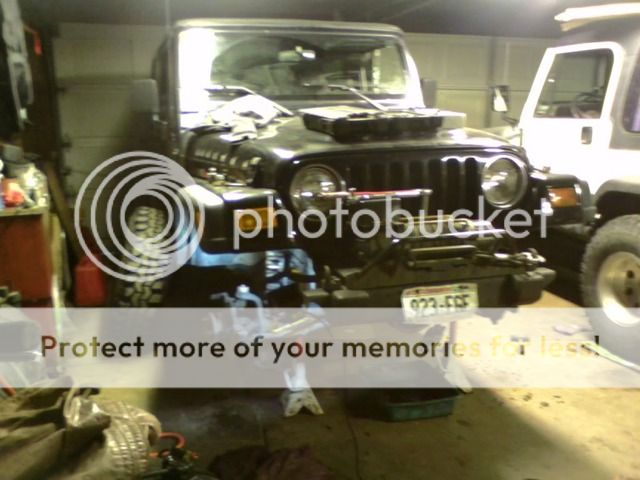

I was able to get the TJ out of storage and went right to work replacing the Dana 35. It took me about three hours to have it removed. It was just me and only hand tools and a breaker bar. I sprayed it down good with some PB Blaster and went to work.
I pulled the C-Clips and dumped the spider gears into the gear oil. Yuck. Had to fish them out and reinstall them later.
I had 6 jack stands to work with as well as 2 floor jacks which made the job a lot easier. I removed the links for the control arms, sway bar, track bar, and brake lines so I could pull the whole thing out.
I took the brake lines and refashioned them to the new axle and mocked it up. Getting the old one out was the hard part the new one slid right into place without much effort at all.
I installed the axles and the Mrs. helped me bleed the brakes.
I used the stock 35 inch drive shaft. Now there is a lot of debate as to whether or not this works. I have more than an inch in travel at the slip joint and I have NO Vibrations with a 2 inch lift. I am still breaking in the gears and that is also going well. Just getting ready for my next run with the club.

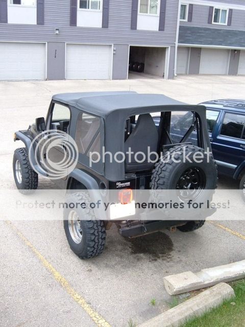

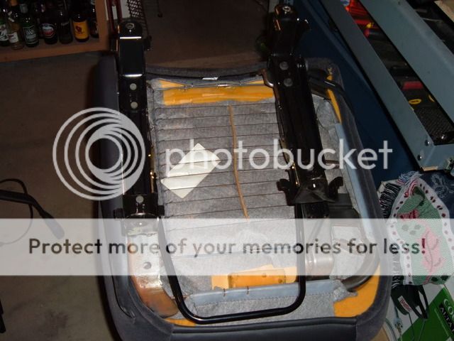

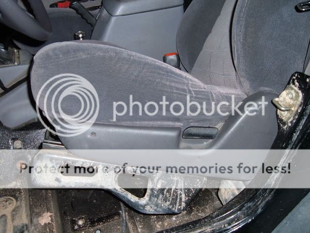

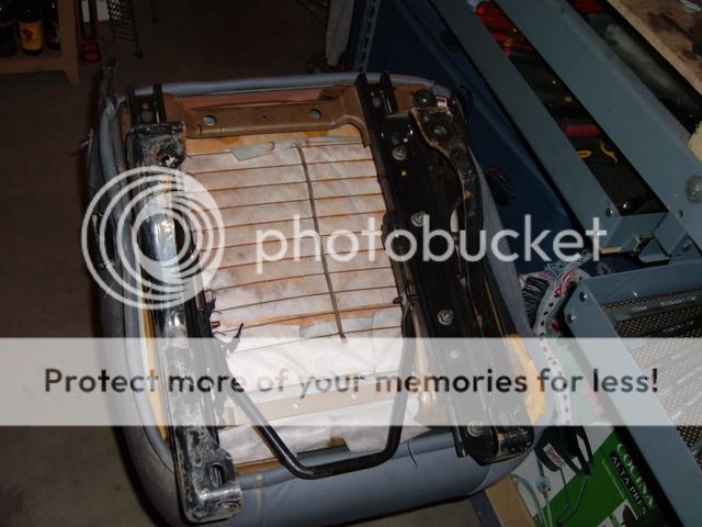

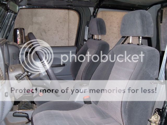

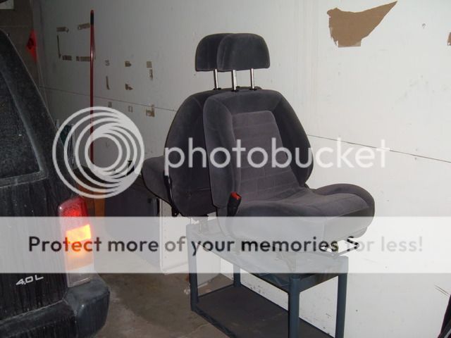

I picked up some ZJ seats out of a 98 that was doomed to the crusher. I think they look pretty good and will be a nice upgrade over my old cracked and torn vinyl seats.

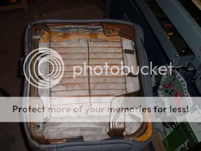

ZJ seats are a direct swap. All you have to do is remove your old TJ seats from the Jeep. Flip them over.
Remove the entire seat riser and bracket.
Toss aside the old seat and bolt up the same bracket to mounting holes on the new seat.
You might also need to remove this little plastic piece from the side. It is held on by 3 screws and comes off easily.
And that's it. They ride so nice. The only downside is that the passenger side does not tilt forward anymore. The bracket still shifts and you can use the lever underneath the seat to make it pop forward but the seat back doesn't go forward. No big deal for me. I don't usually have people in the back anyways.
