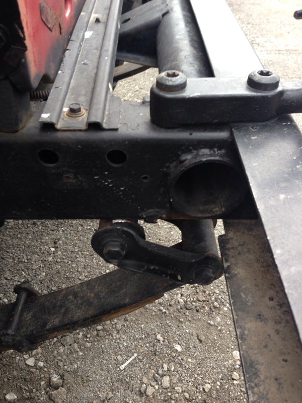

Well, shackle mount up front broke on me. Also found out my driver's side shackle was cracked. So currie's are on their way and I torched a mount off our parts jeep to weld up tomorrow night once I get it cleaned up. Also, included a pic of my shop mutt helping out with the disassembly.

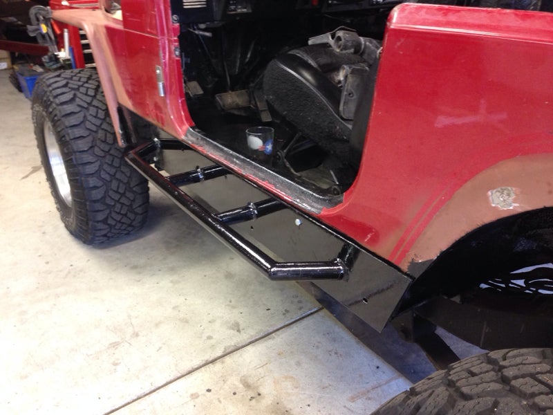

Getting ready to prep the jeep for paint. Painted some accent pieces in satin black. Also finished the step bars and coated with POR. New head lights and LED tail lights should be in this week. Will finish the rear tube fenders and prep the body for paint this weekend. Pics to follow.
