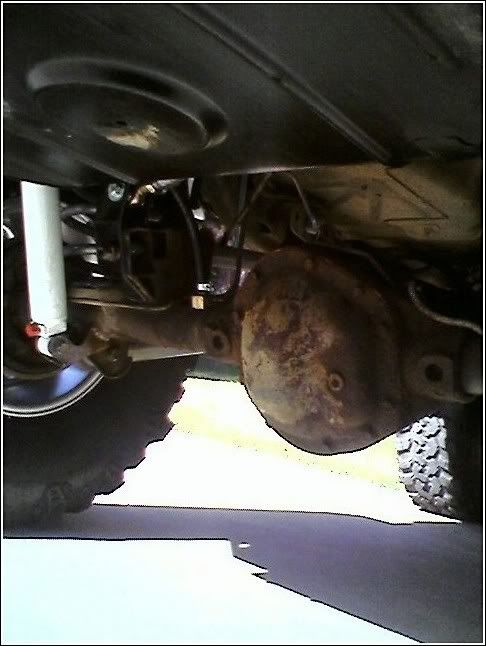

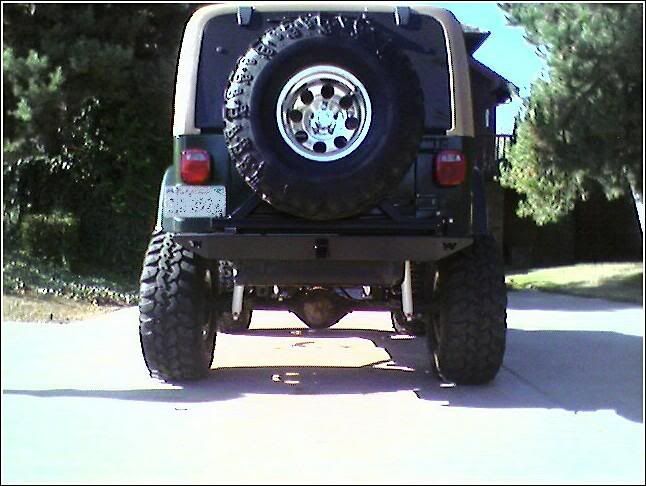

Originally Posted by alex71

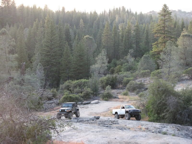

if you want to shup them up just take a pic of it
lol well here are a few.

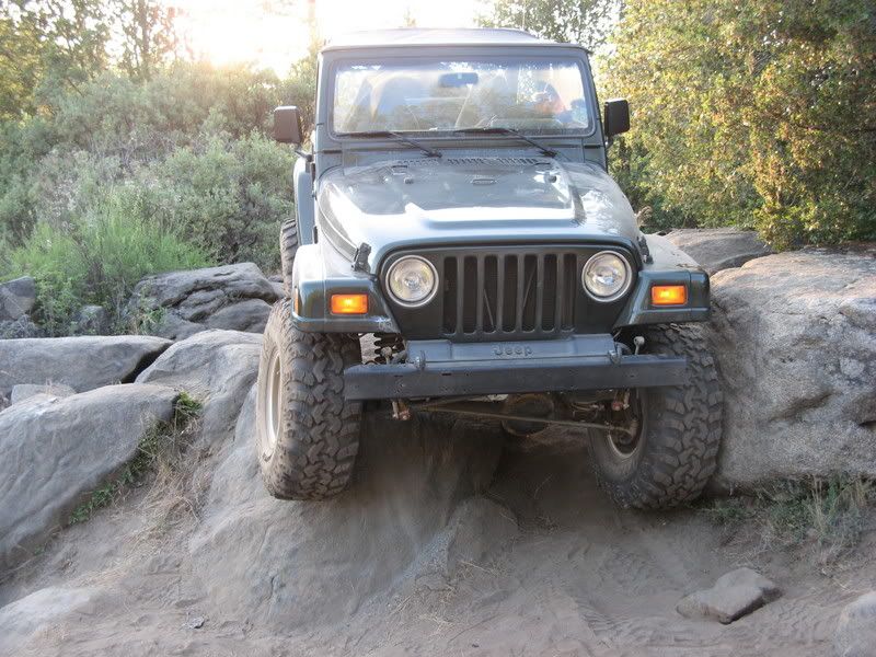

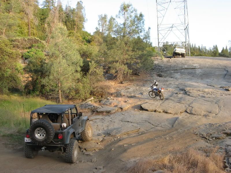

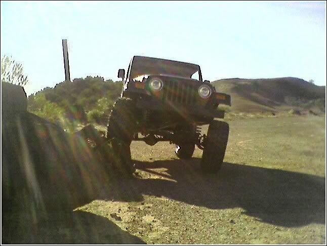

just a lil flex comin home from the beach
another before i did much

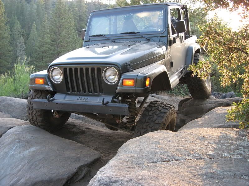

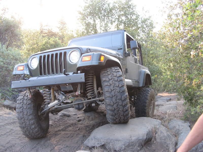

thought i would post some new pics on this old forum

these are the new fenders and rockers but i have diff tires that week while i ordered some bigger ones

It's a 44 and great looking Jeep man, it looks mean as hell.
Question;
Did you roll the axle up instead of dropping the tranny down some? Your pinion is in a seriously upright position and by the looks of it, it could cause you some problems in the near future. Reason I'm saying this is because no diff oil can reach the pinion seals at the front of the housing if it's to upright.
Granted that is just by looking at the picture.
This one; http://i100.photobucket.com/albums/m24/sahara0207/4.jpg
