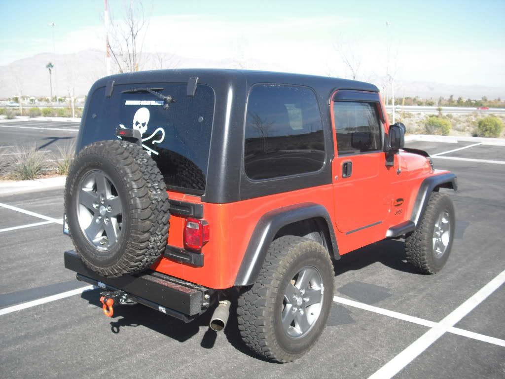

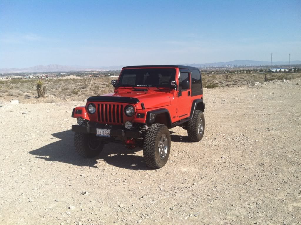

Just wanted to post some pics of my jeep so far...
EXTERIOR
- Painted Fender Flairs with Krylon Fusion Satin Black
-Tinted front windows 20% (Installed by EcoTint in Las Vegas)
-5 Spidertrax 1.25'' wheel adapters (5x4.5to5x5)
-2010 Call of Duty Rubicon Wheels and tires ($500 on craigslist)
-Hidden Hitch class 3 hitch
-D Ring receiver
-Headlights Cheap ebay lights with Hella h4 light bulbs (eBay special for 25 bucks)
-Black corner lights (also eBay special for 20 bucks)
-Rugged Ridge windshield light bracket with 5'' KC Apollo driving lights
-KC 6'' Fog lights on bumper
-AVS Bugflector & Window Visors
-Painted Diff covers, last diff oil change

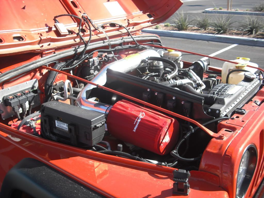

ENGINE & DRIVE
-Rugged Ridge Intake
-Outerwears Filter cover
-MBRP Cat-Back Exhaust
-Teraflex Extreme Short SYE
-2'' Skyjacker lift
INTERIOR
-Painted Center Bezel (bought paint from automotivetouchup.com)
-Coverking Seat covers, Front & Rear
-Sony Radio, (with American International CD-K636 Dash Kit)
-Kicker Speakers, 5.25'' & 4'' w/4x6 adapters
-OEM Matching Light switches Custom made light wiring harness (switches from eBay store: Ultra Car Care Products Inc)
-Daystar Dash Tray
MY DAILY DRIVER BUILD

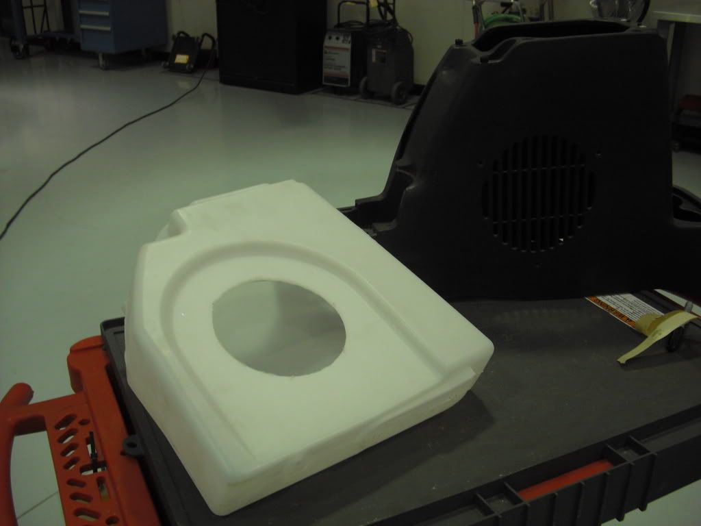

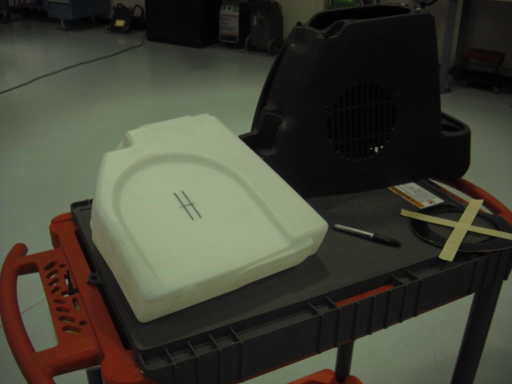

6.5'' sub install
removed seat
removed center from jeep
removed plastic liner from center
marked the center of the plastic liner
cut a hole
started cutting wood to make the plastic liner sealed into a speaker box
installed speaker wire with rubber gromet, and wood. also quickly painted it balck on the inside.
installed speaker, used black silicone and screws to secure speaker
put it back together
and... back into the jeep
right now i have my amp on the floor behind my seat, but looking to buy a small amp to mount under my drivers seat.
