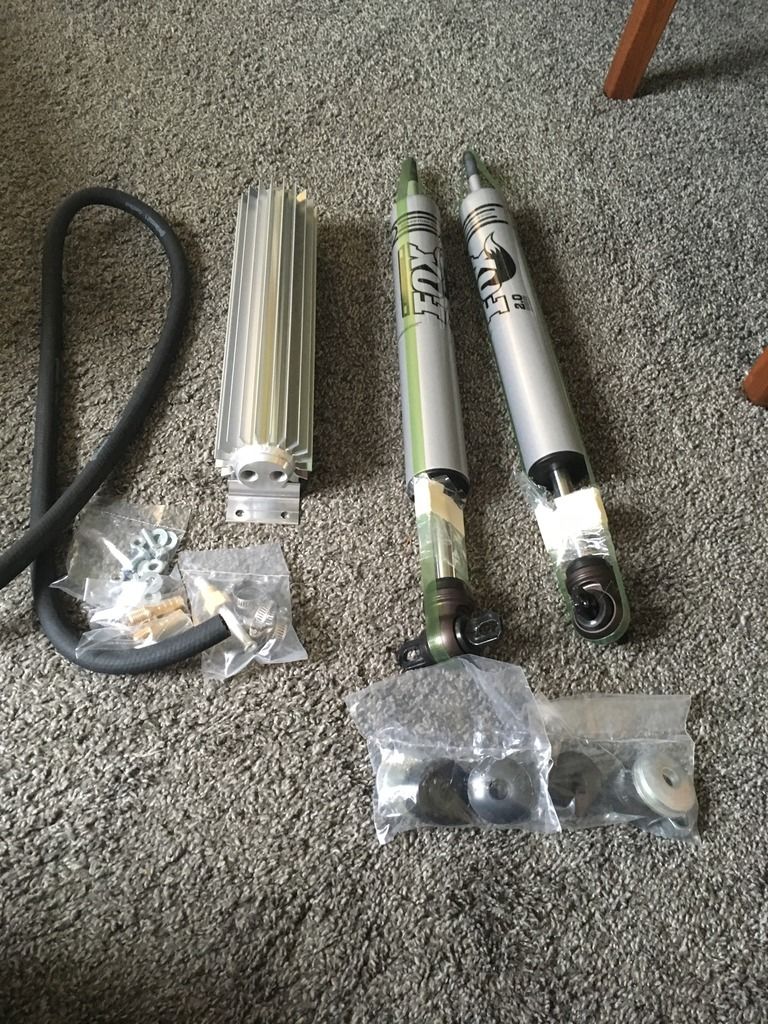

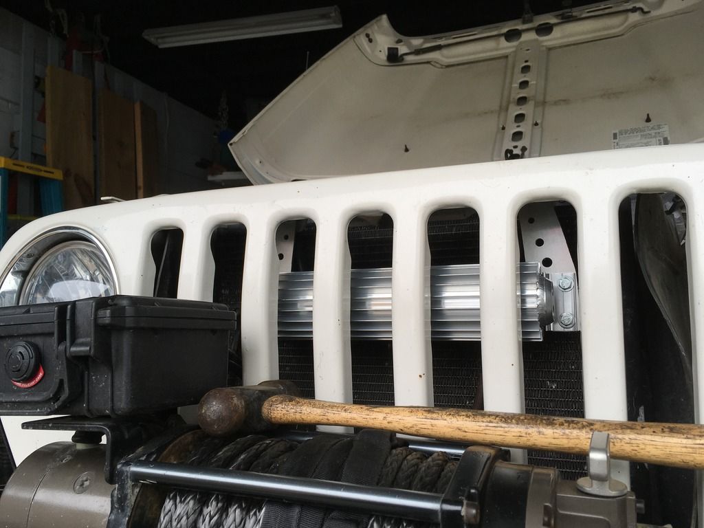

Power steering cooler is in, ball joints replaced, new spicer 760X's, front foxes on and bump stops adjusted and the trans fluid swapped.

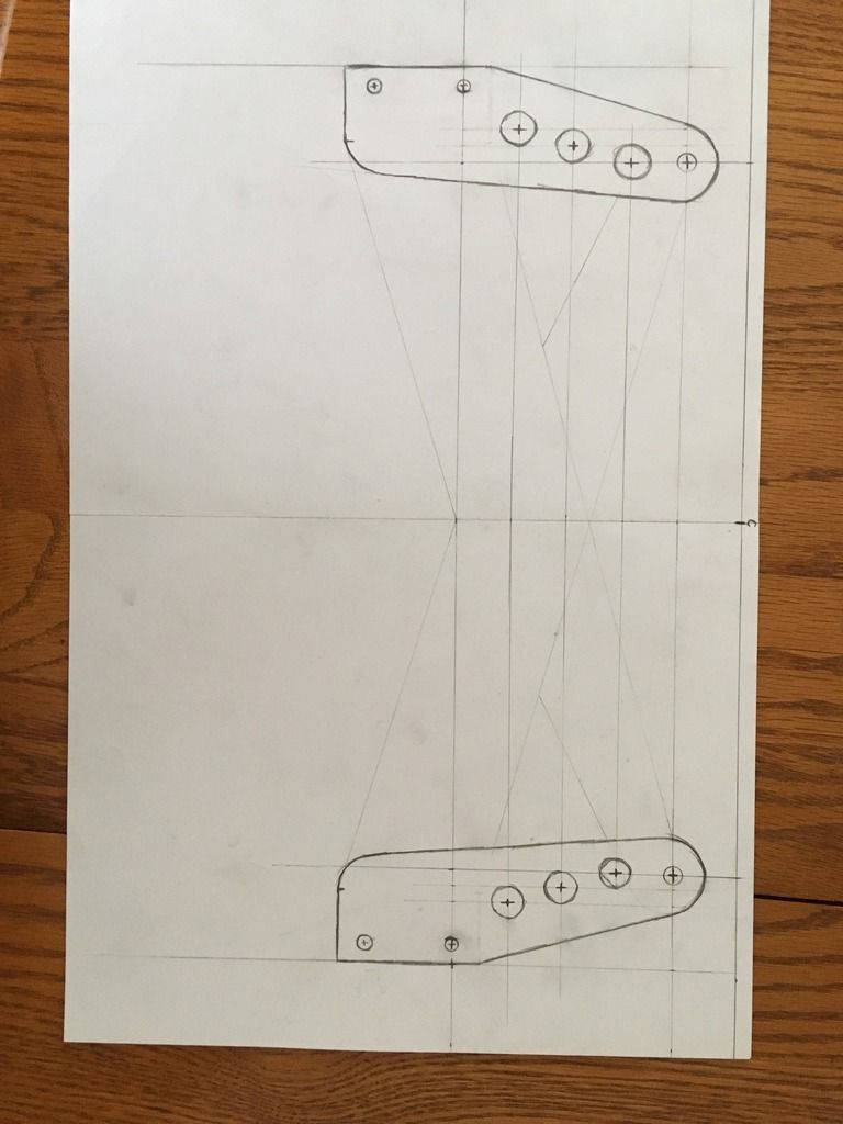

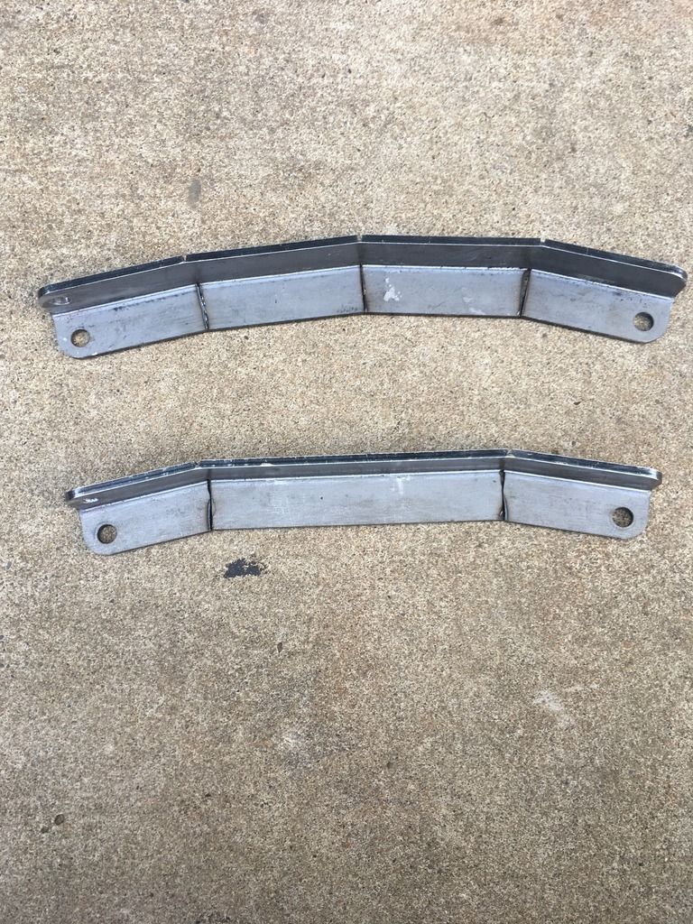

Here's the drawing for the cooler brackets, they were cut out of a sheet of 1/4 scrap aluminum I had lying around.
And in the jeep!

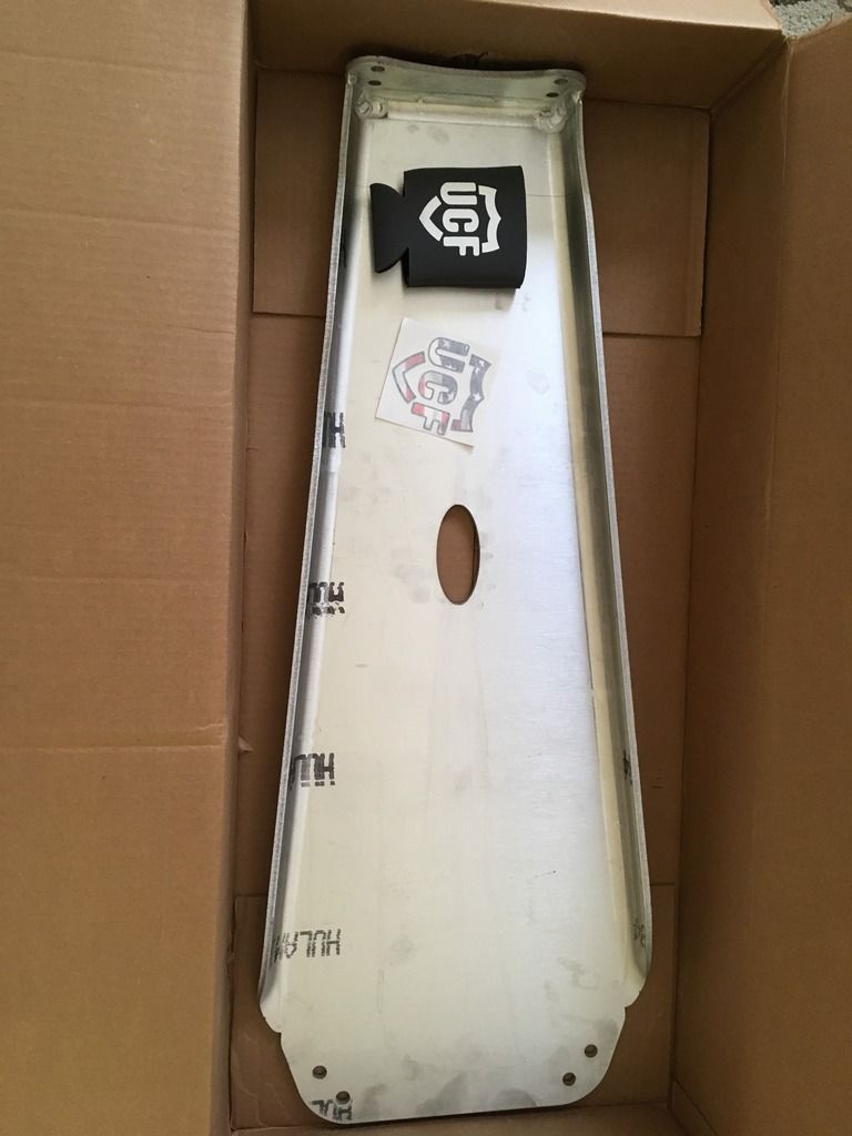

Tomorrow I'll be trying to get this to work. It's for a 4.0 and the engine mounts are way different. Gonna have to make some of my own. Wish someone made one for the 2.4 lol.

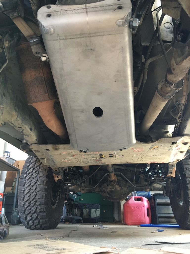

The engine skid is on. Cant wait to tag it off some rocks! I ended up having to drill them straight onto the motor mounts and curve them a bit to sit flush. I had to curve the drivers side bracket a good bit to clear the driveshaft at full bump. I curved it even more after this pic was taken.
And the final result!
