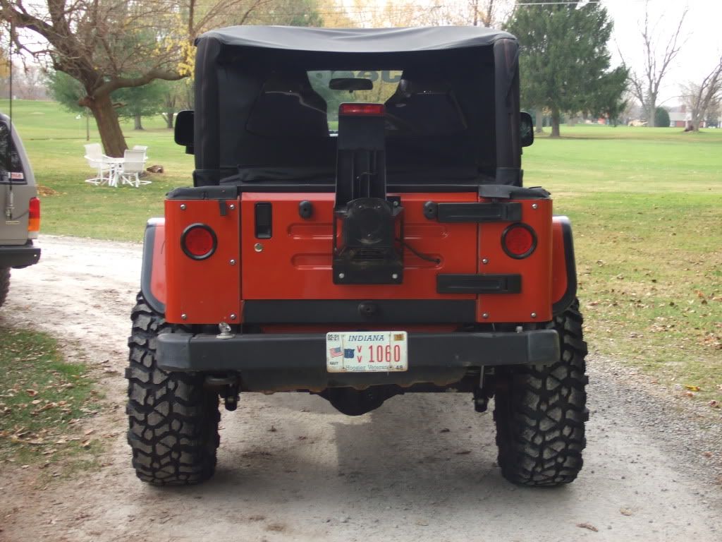

James, why is your bumper and gas tank all messed up?!?!?!

The bumper and tank skid are from wheeling rocks in a lowrider. I'll see what I can do about all those other pics once I get home.

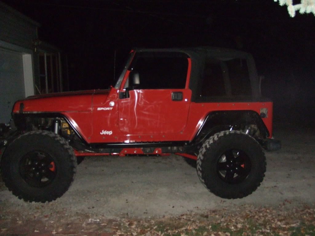

post #805 of 5133 Old 11-09-2009, 07:00 PM Thread Starter
Bennettj13
Location: Pendleton
Posts: 5,366

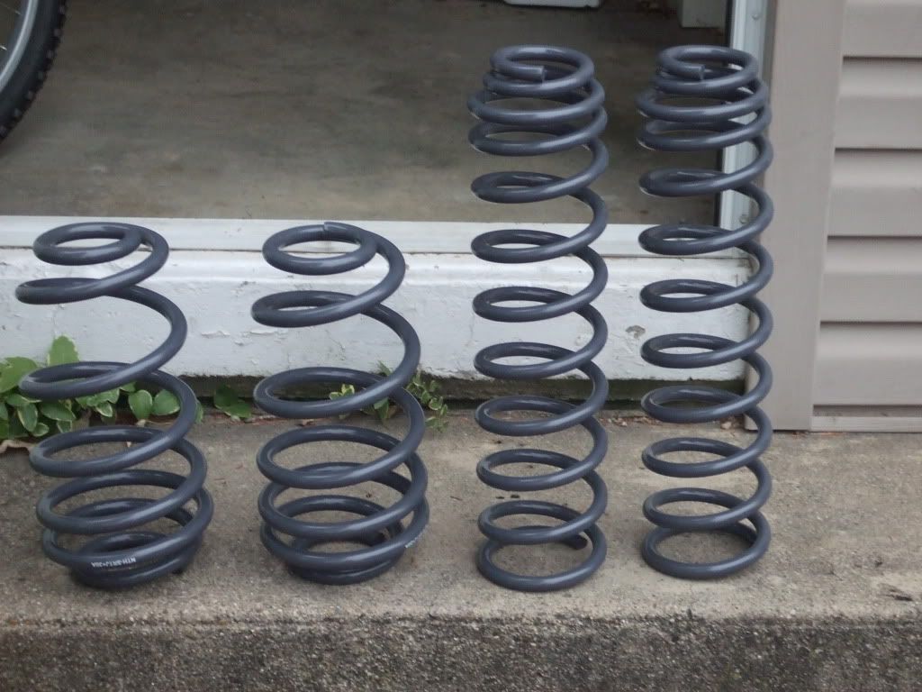

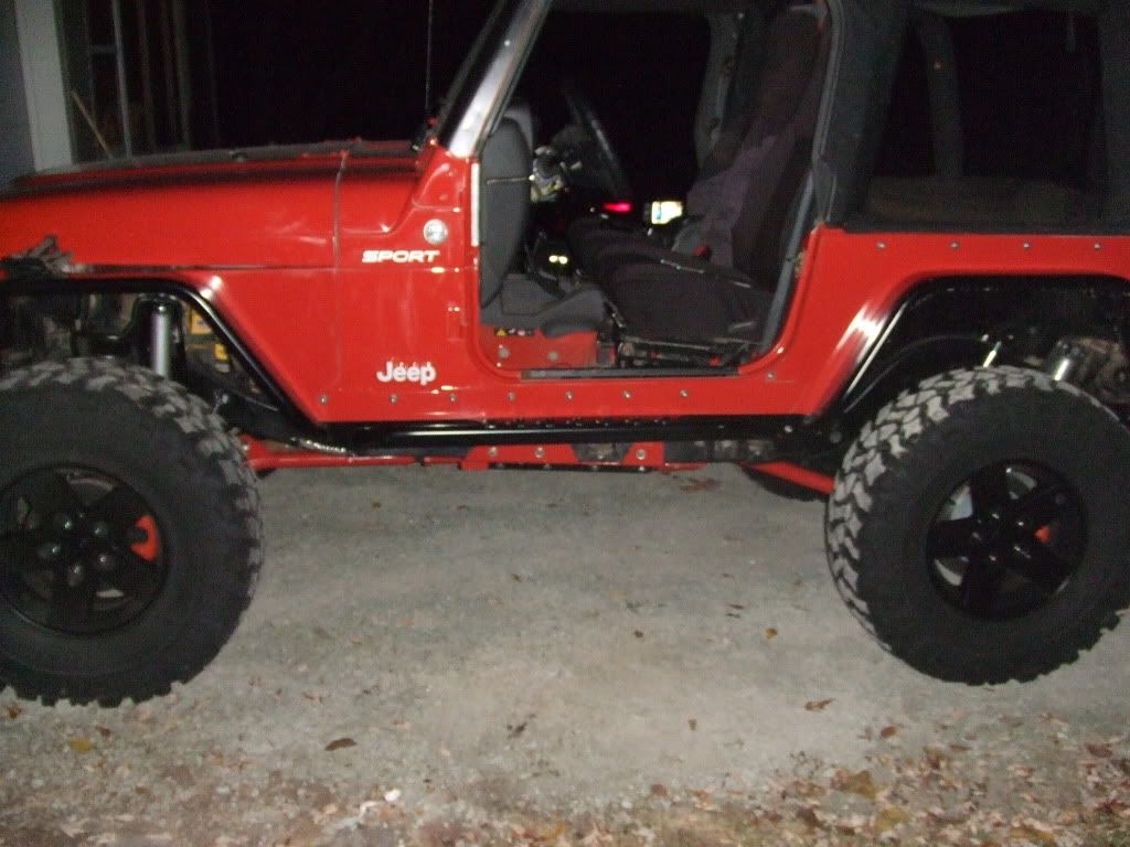

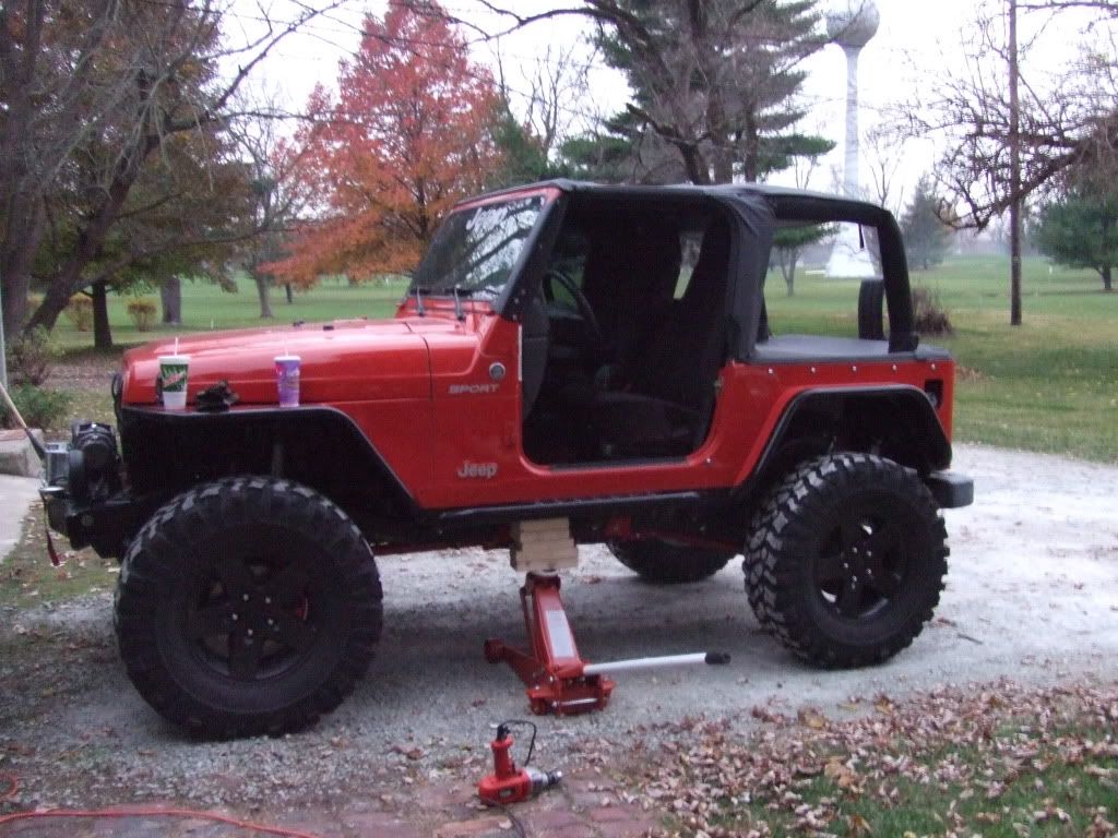

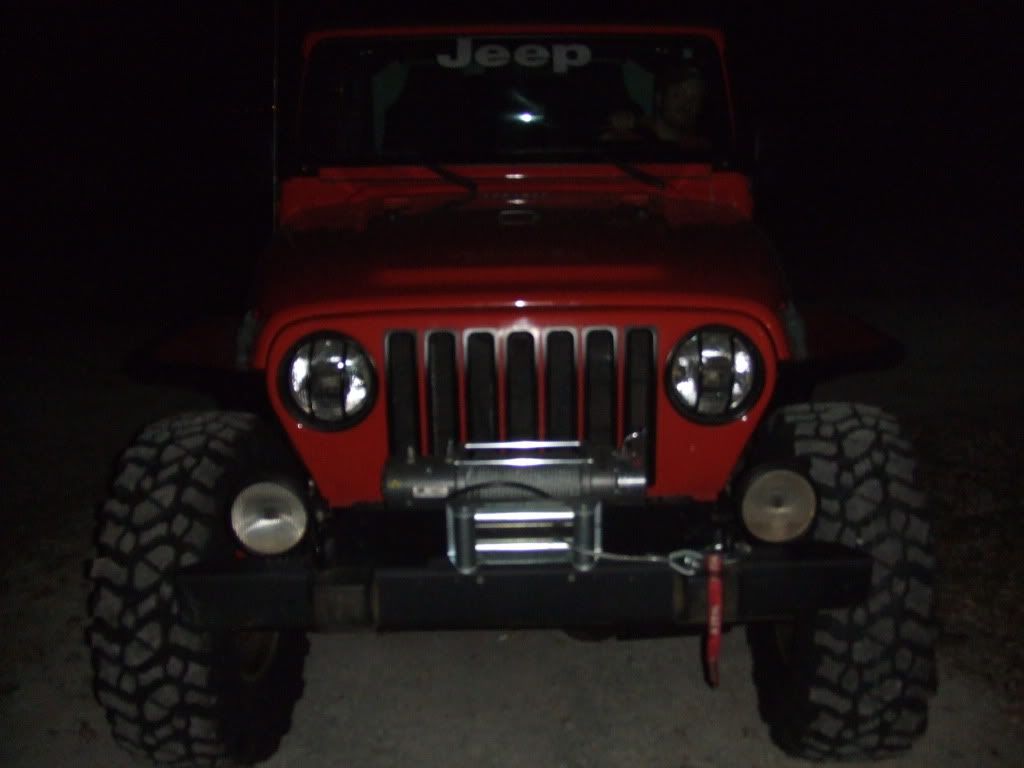

New coils are here.
Pre-loading the rockers.
Rockers and no doors.

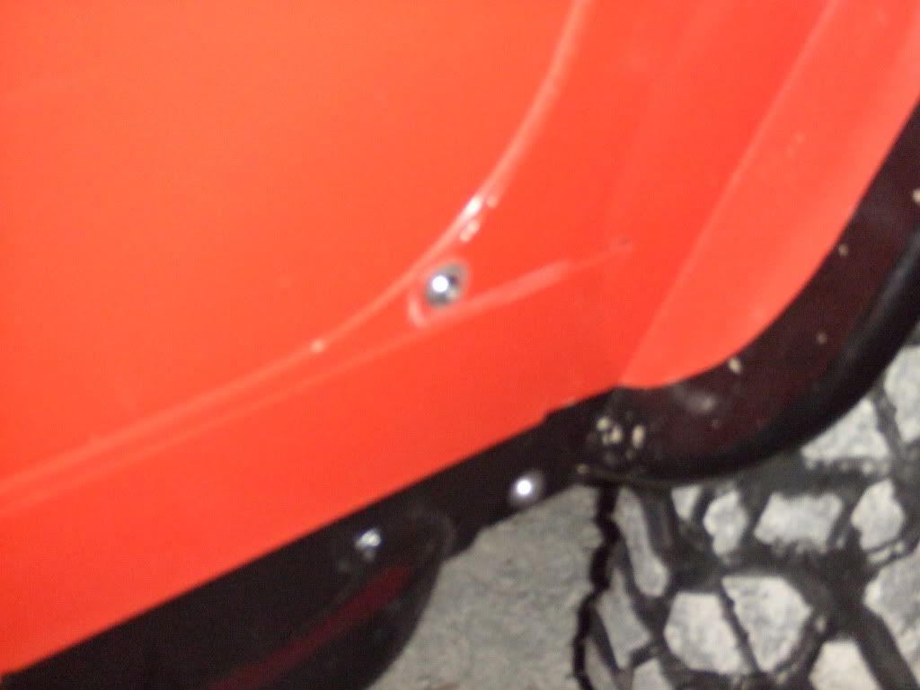

Gangsta James drilling the underside mounting holes.

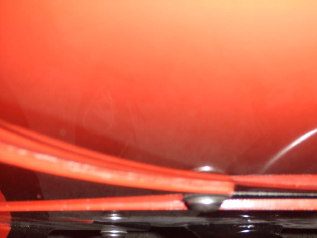

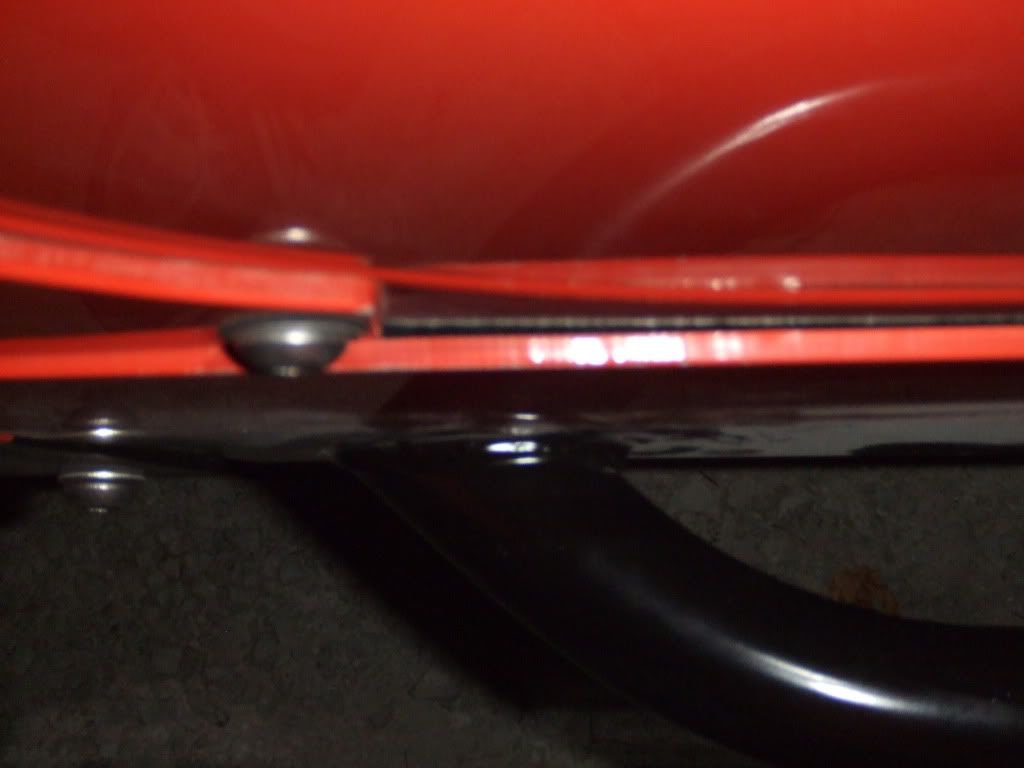

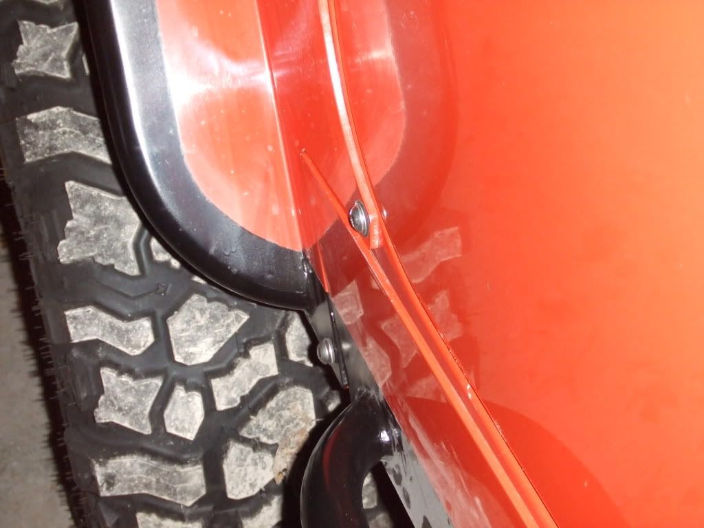

All done.
The "****light"

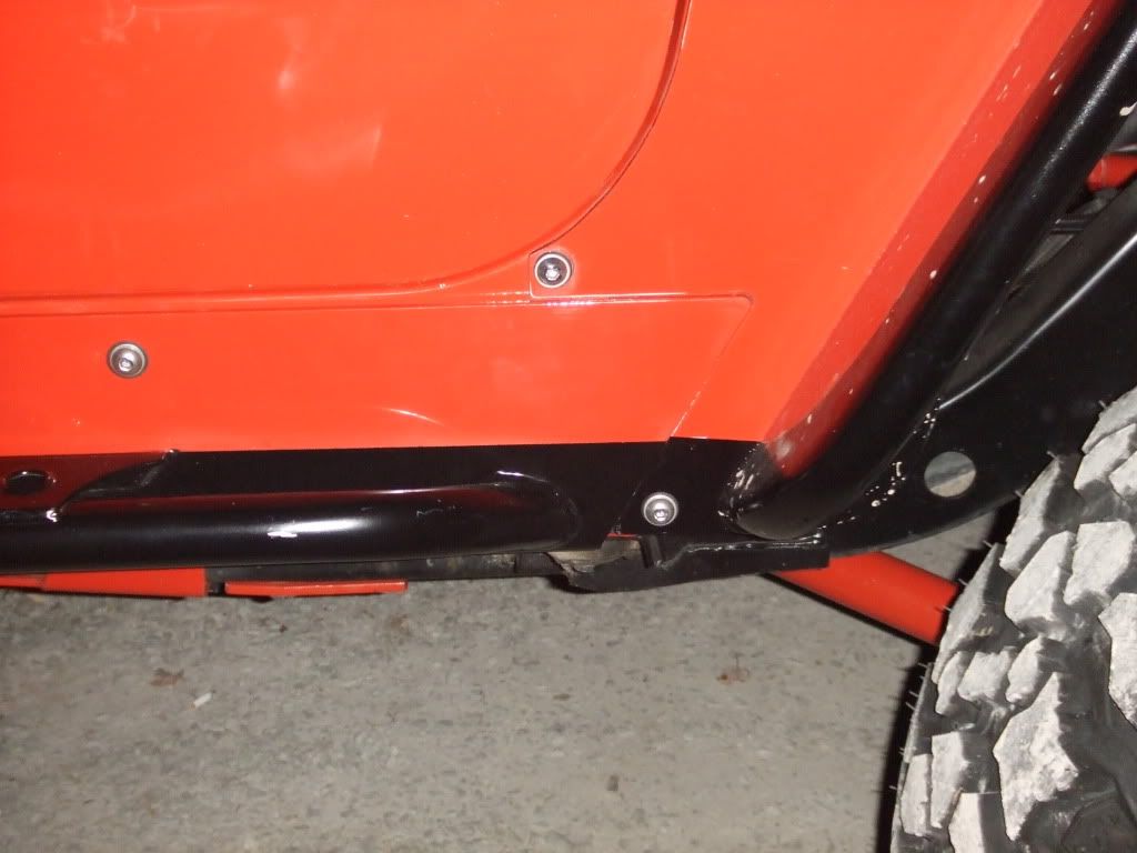

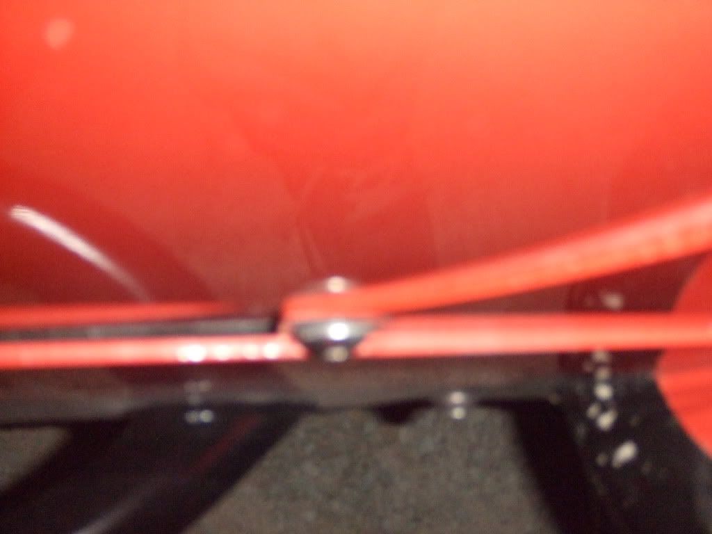

And here's what I don't like... Granted there's bolts underneath mounting through the floors here, but still, I can't get over the ill fitment against the side of the tub. They fit great against the rear corners, but I HATE the gap between the tub. Meh.

Too sexy, looks amazing man, great job
Are the new coils installed in the pics?

And no, the new coils aren't in yet. I'll do that when I re-measure for the new shocks.

Are you sure there's not a burr on the edge of the corner guard which prevents the rocker from fully seating on the tub?
