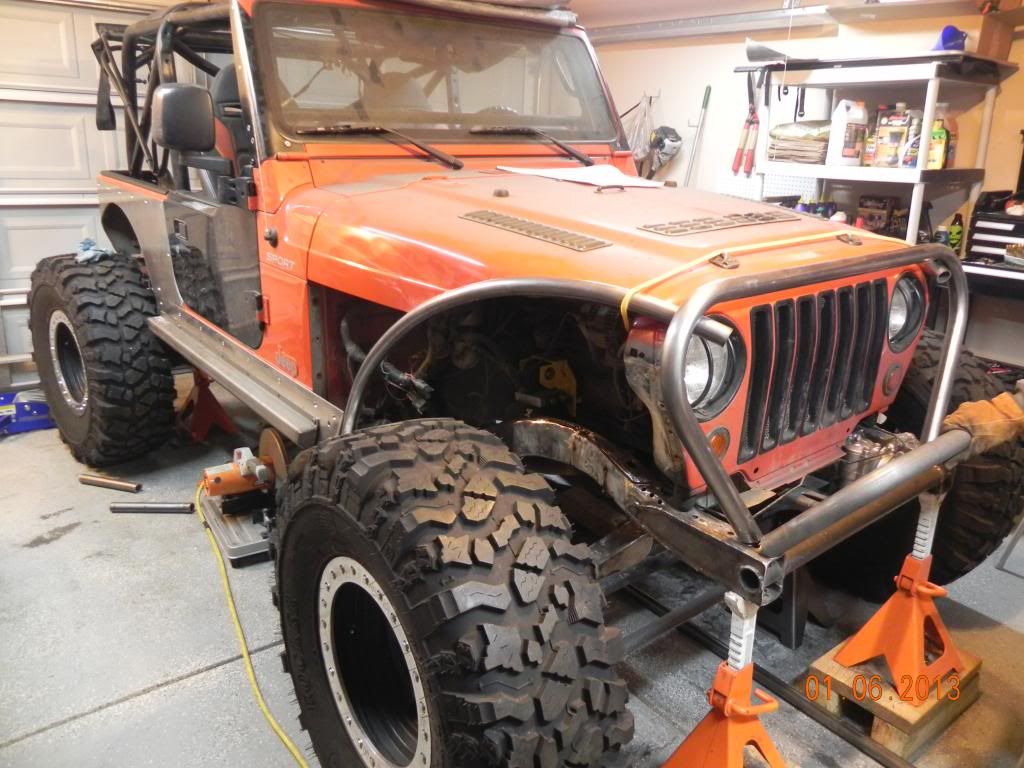

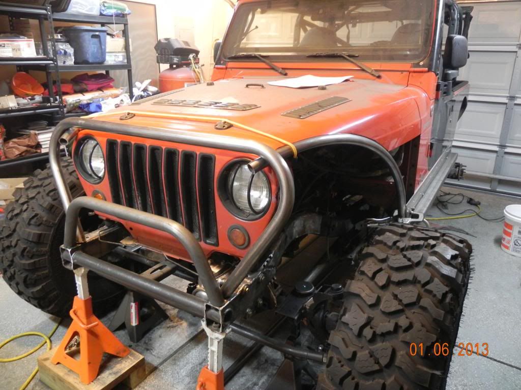

Did you bend the hoops and stringer or did you order them.
Dave's looks like it's got some nice products
JJeeper09 is offline
post #4938 of 5133 Old 01-09-2013, 08:34 PM Thread Starter
Bennettj13
Location: Pendleton
Posts: 5,366
I do not have a bender, and its not worth it to get help from someone around here that does. The hoop is from jeeptubes and the winch guard is from AtoZ fab.

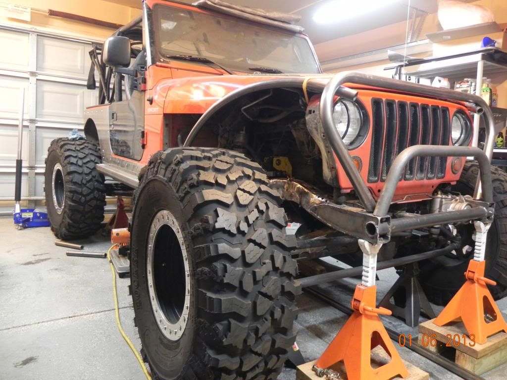

Originally Posted by Bennettj13 View Post

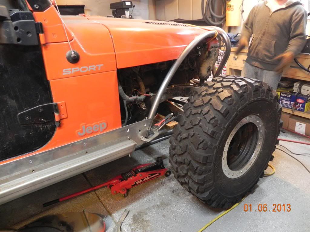

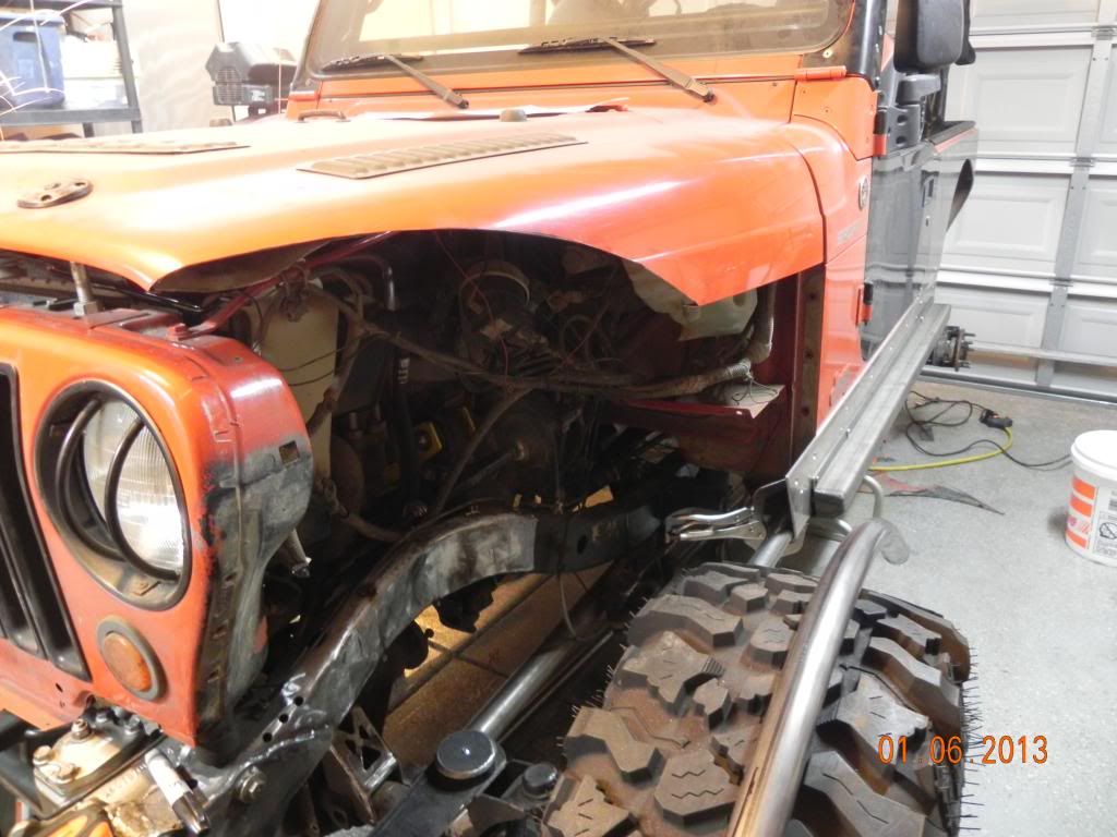

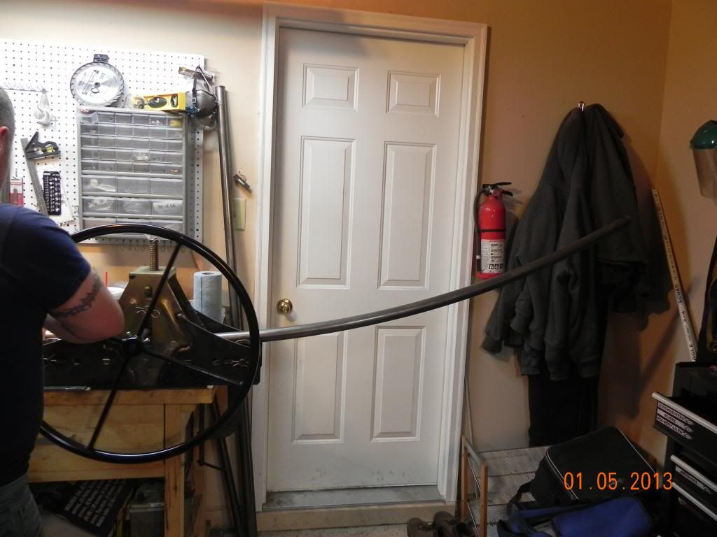

Rolling some tube... This wasn't SO bad. Definitely not as bad as everyone on pirate cries about. You get the hang of it rather quickly. John and I had a blast. Though you'll be Popeye if you are doing some crazy ****. All we did was 1.5" .120 wall.
And the product of that tube roller...

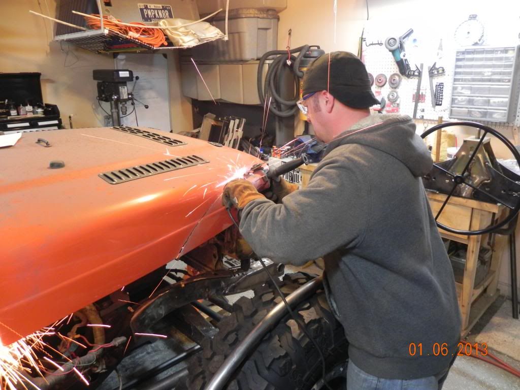

Cutting the hood...
Hood is cut, but needs finished out and trimmed up.
From the back...
From the front...
I'm waiting on the bumper to be able to finish up the front fenders. Then I can really get things mounted properly. The game plan is to use the cut outs from the corners to make the side panels. I'll mount them with nutserts and tabs. I also need to cut the rolled pieces back some so I can put the tube connectors in to make things removable. I'm going to tie the winch guard into the grille hoop as well.
Despite setbacks, It was a good time hanging out with one of my favorite people. And definitely the best hillbilly I know.

I am thinking you will have to trim the drivers side of the winch plate. Do you think cutting out part of the rear bend will weaken the plate?
