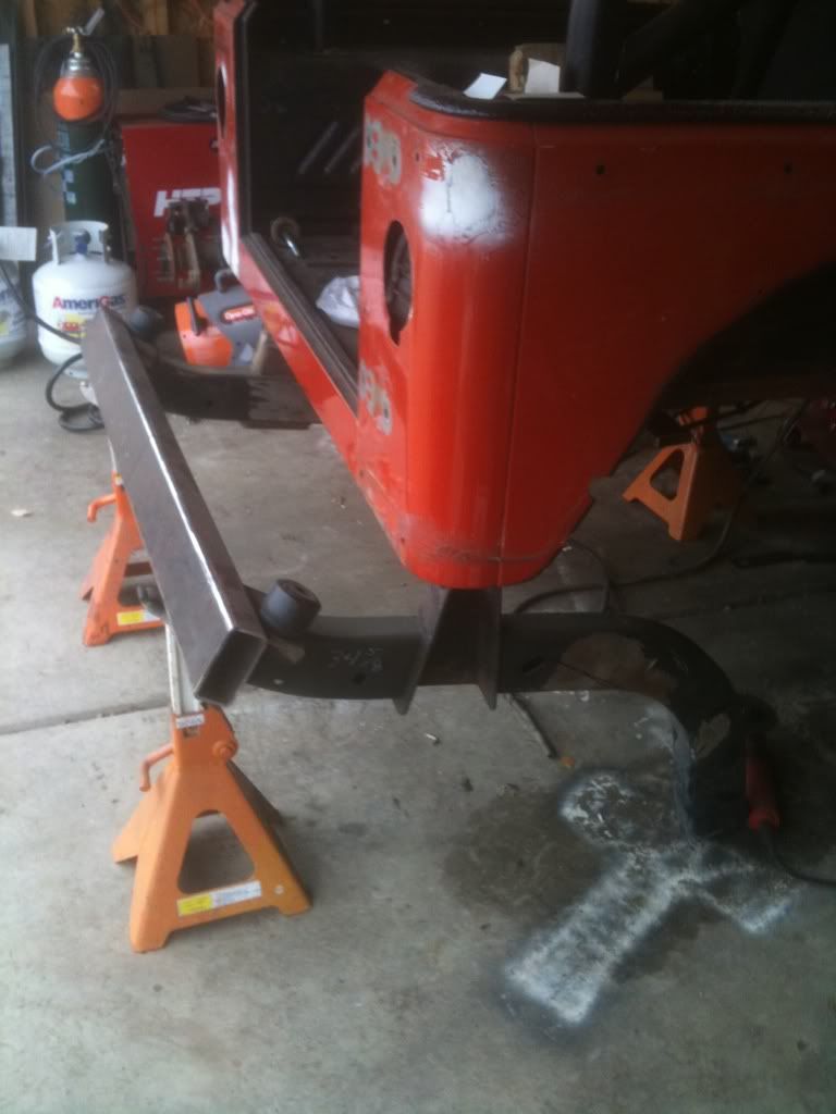

After consulting with Johnboy again, and further review of my rear frame situation, it's going away. Parts are on order. I'm ready to wrap this ***** up, and honestly, it's just easier to replace it than work around the previous outboard. Progress next week.

So in thinking about the new backhalf, I may be able to just run the extra set of stock coil buckets I have instead of fabbing new ones. I'll have to figure out shock mounting still, but I still have that set of ford towers too. While I'm not thinking about a traditional outboard, I'll be able to come off the top of the new frame. But honestly I have no idea how it will play out just yet. I'll be buying steel for the rest of the backhalf next week. Still need to source that. I'll try that on Monday.

Talked to ATX today. Derek said that he got the design done and should be shipping my backhalf kit either tonight or tomorrow morning. Wahoo. Still need to get a hold of some 2x3 box tube. Once the stock frame is chopped, I'm going to see about saving the crossmember John and I made, and maybe even saving the TNT outboard. It will be much easier with the frame out. I'm excited.

Someone slipped with a power tool today. Can't wait to see the backhalf and the cut of choice on the blanks

Oops. Ready for the backhalf!
