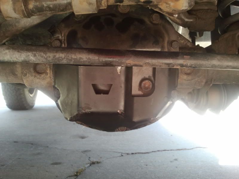

Got a warn diff skid for the dana 30, for FREE!

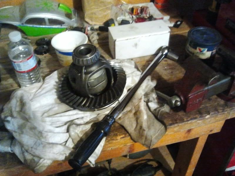

Just placed an order for an Aussie locker for the D-30 along with a set of Alloy USA seals. I really wanted to keep it stock until I could buy the Metalcloak armor and tires all at once but being at home out of work is very boring, I need something to do

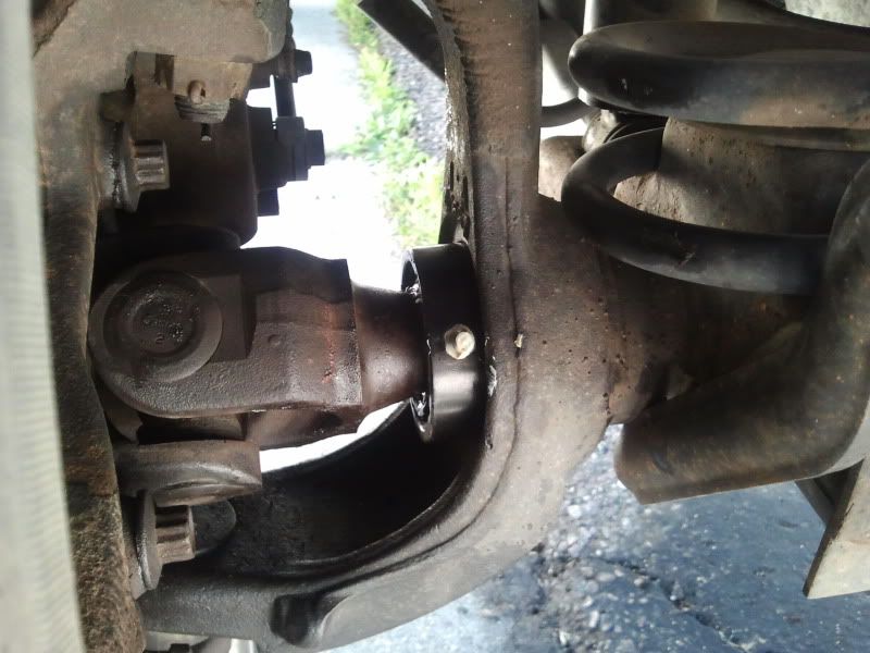

Installed the Aussie locker today in the Dana 30, along with the Alloy USA Seals. One thing that really upset me with the seals is the one on the drivers side. The grease zerk is butted up against the dana 30 housing, so I can't get my grease gun on it Going to grab an extended zerk fitting to put on there, that should solve it. Anyone else had this problem? Both seals are installed all the way in and flush. I will snap some pictures tomorrow

Got it all fixed. Here is the passenger side, seal set, no problems
And the drivers side with the new 90* grease zerk. Took about an hour to get it in because there is so little room to work with in there, but I got it. It's hard to see from this angle because it's got grease on it and it's head on, but the zerk is facing down and away from the axle housing. The straight one that was on there was impossible to grease

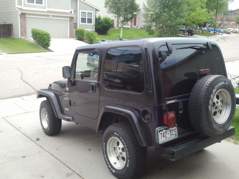

Picked up a hard top today for $400!!! A total steal as they usually go for $800+ around here
It does need to be painted and it has a few nicks on the passenger side rear corner. Both problems are totally cosmetic, the glass is tinted and in perfect shape, the rear wiper/sprayer works as well as the rear defrost. No leaks or whistles I wasn't expecting to buy one this early but I couldn't pass up that deal.

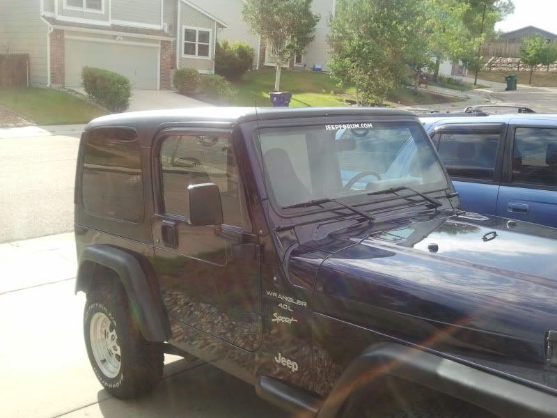

Got the top painted. Sanded it, primed it and painted it with rattle can rusto. The fiberglass sure does suck up paint quick! I took it for a spin and there is a whistle coming from the passenger side somewhere The only thing I am seeing so far is the door looks like it needs to move up to get a closer tighter seal, but the back part of the door, where the latch and lock are, fit perfect, I'll do some searching.
