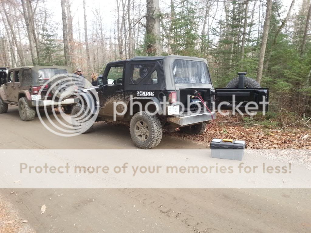

The next day my buddy showed up, we hopped in the Jeep and went wheelin. Being stock this thing went everywhere. Sadly this is my only pic, long story short, trees 7' apart + wet boulders + 14psi =
Fun stuff, but it lead us to the top of the mountain

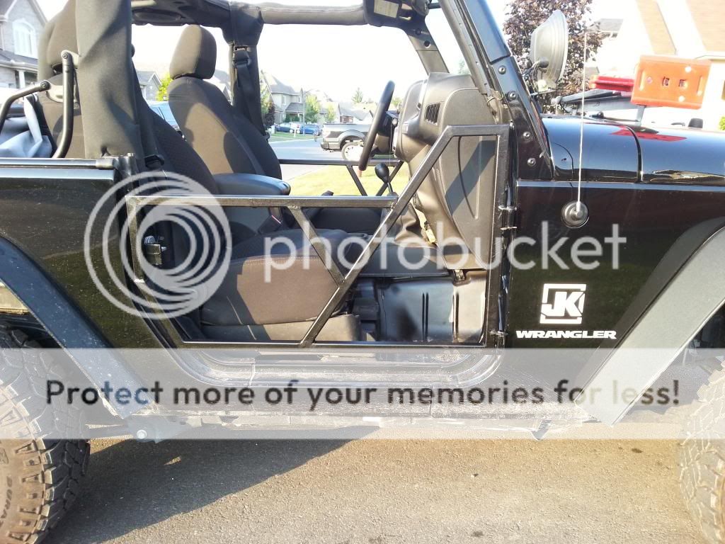

Don't have a tube bender and wanted doors so I made these

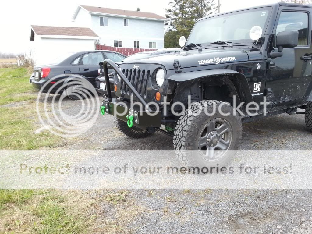

Got started on my front bumper, not quite finished yet still need some shackle mounts to get rid of the stock tow hooks and shovel, incorporate my fog lights and get tubing for a stigner. Not that heavy actually, prob 35-40lbs. 3/16 steel with 3 brace points inside.
Once I get a winch I'll either put it on top of the bumper or sell this one and build another with a sunken winch.

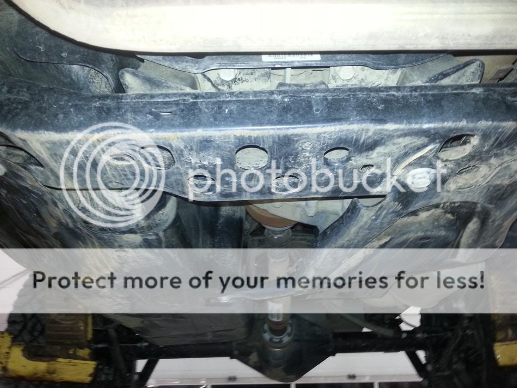

Also took these pics before starting the bumper
'13 JK 6-spd | 3.5" RK | 35" MTR/K | Lots Of Welding

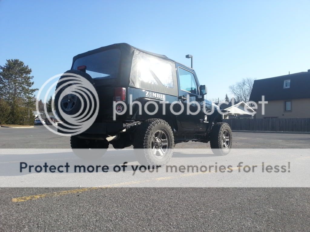

Didn't think I'd have time to finish the rear since I went fishing all day Saturday but I managed to get it done.

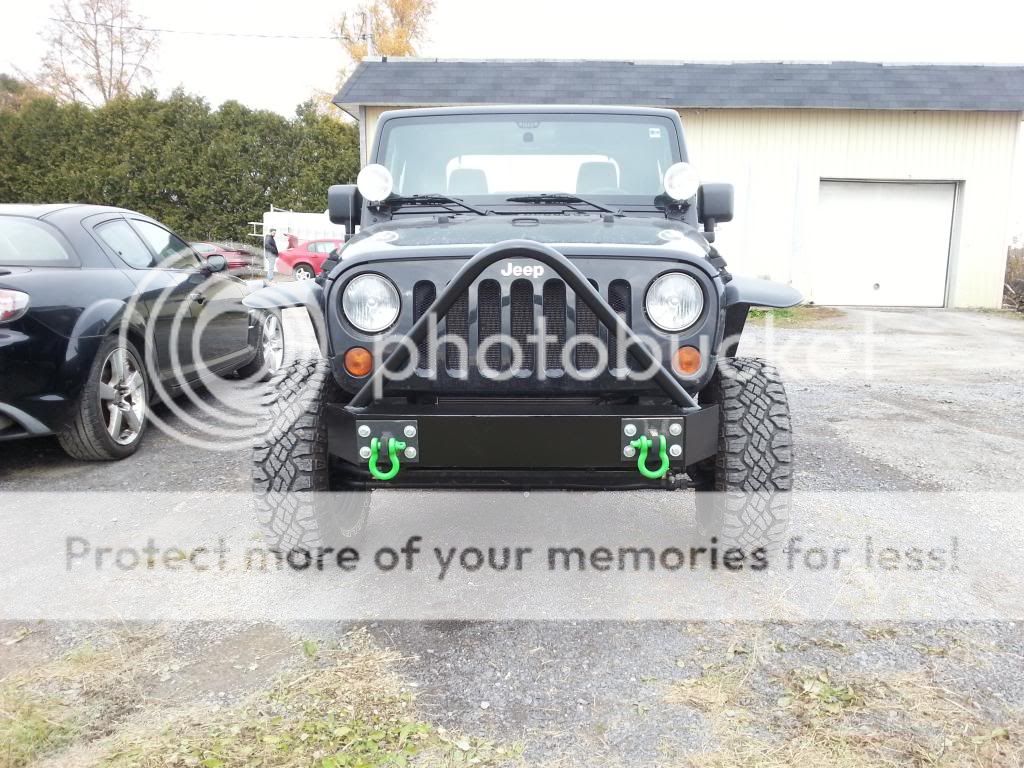

Been a while since last update. Bought myself a tube bender so I finished off the stigner for the stubby and put it up for sale, built myself a mid width front w/ stigner, added a used 1.75" BB I got for 80$, and got some .188w tubing for the sliders. Hopefully start that this weekend.
Stubby w/ stigner
New bumper

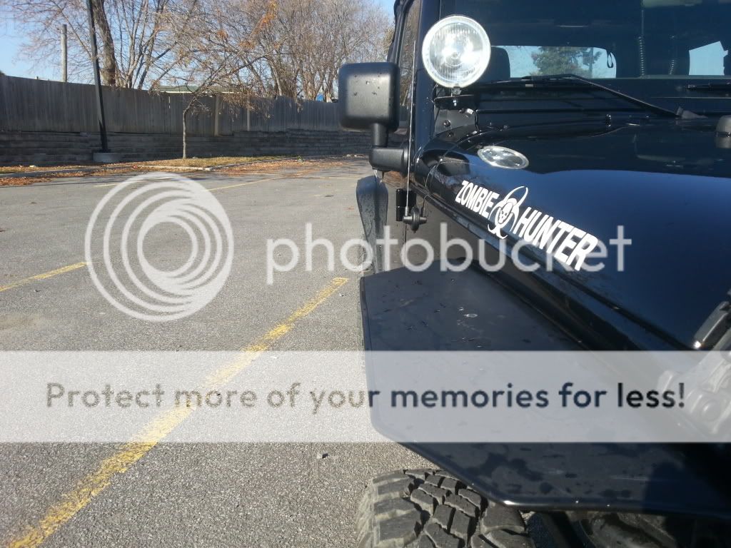

Night driving with just OE lights and no fogs was terrible so I put some Silverstar XFE H13s and that alone was night and day, but not enough so I wired up some 100w 6" driving lights to the bumper. Much better!

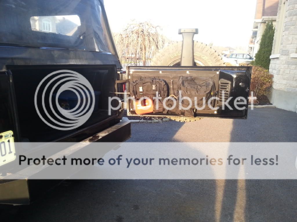

G.E.A.R. Tailgate Storage, Cobra CB and retrimmed flares just got crossed of the to do list!

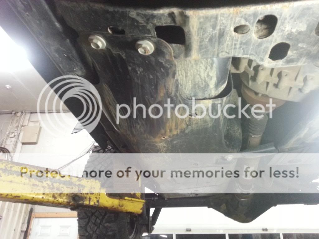

Rock Krawler 2.5 Stock Mod, Front coil retainers and rear spring correction wedges.
Bilstein 5100's all around
Teraflex rear endlinks and grab handles
EVO C-gussets and LCA skids

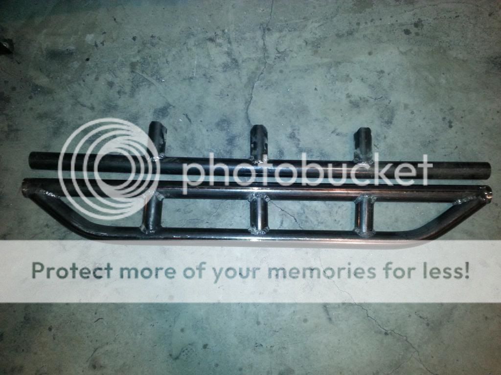

Finally got around to working on the sliders a bit. Mount boxes are done, most of the tubing is cut and notched. Just need another 5' piece of pipe for the outer rail. Then I get to get them lined up for mounting. May be doing boatsides...
Question is, straight out or angled up to protect body.
