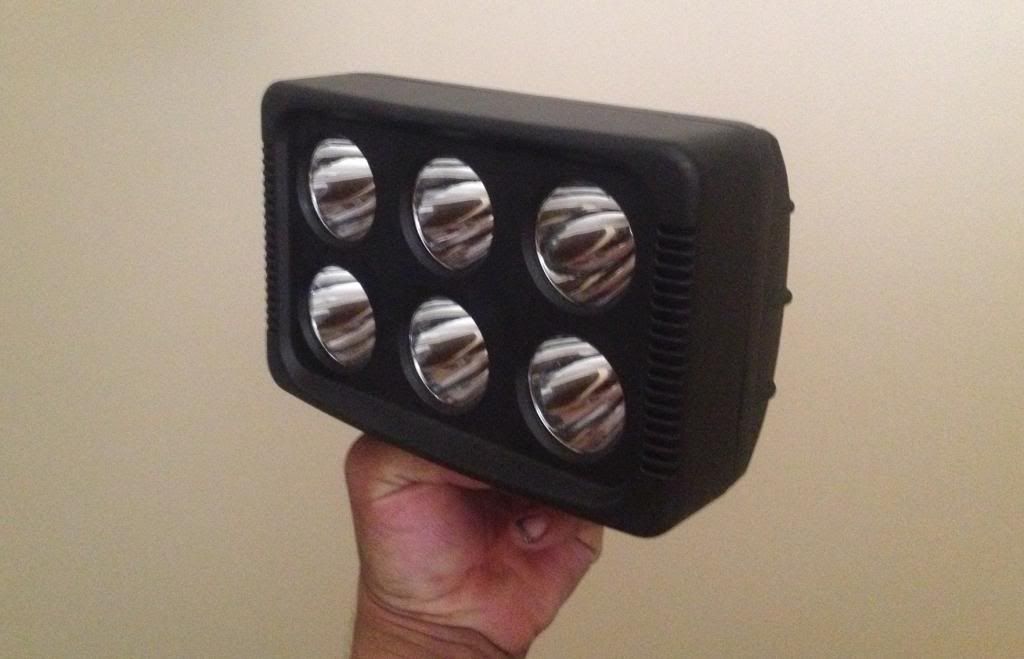

Posts: 669
Well I have pretty much stayed up all night so far, first building a bracket to mount the two lights on at 30" apart on center (same width apart as the YJ factory lights) and then driving around random locations where there was not any ambient lighting to compare these two new LED headlights to my factory Chevy Silverado headlights (with Sylvania Silverstar Ultra bulb on the passenger side light lol)
Each set of two pictures were done in the exact same location and trying to minimize any other variables that would effect the results. To test the LED lights I just put my home-made bracket on top of my radiator support on my truck, and turned off my truck's stock lights. Keep in mind that human eyes pick up more light than an iPhone camera so both the halogen light pictures and the LED light pictures would be quite a bit brighter in real life, more than the pictures show.
The LED lights were just attatched to my battery with 16 ga. wire and alligator clips straight to the battery for these comparisons. The LED light pair only draws 10 amps.
Also keep in mind that the LED lights are litterally bolted to a wood board, and are not adjust correctly. Once they are in the grille of my Jeep I can aim them for the best overall lighting. They are a spot-pattern. I can promise you these results are as fair as I can make it. Both the Halogen lights on my truck are in working order (one isnt burned out or anything) and I aimed the LED lights in a fashion as if they were sitting in my grille, nothing tricky there. Also, the LED's are going on a completely non-road-legal vehicle as the LED's are not DOT approved.

Halogen
LED's
_______________________________________________
Halogen
LED's
________________________________________________
Halogen (same area as above, but standing in the bed of my truck, looking over the cab)
LED's
Halogen
LED
Halogen
LED
