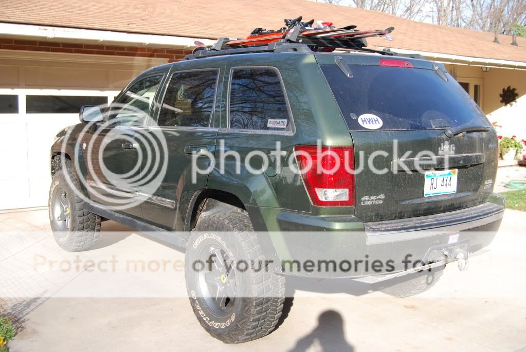

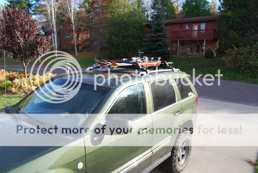

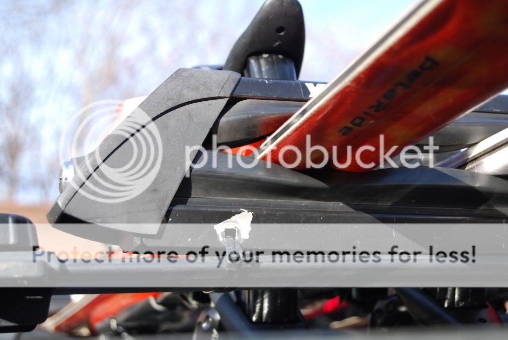

So a friend gave me some ski racks earlier this summer but they arent really universal, so i just took some zip-ties and tightend them down. Hopefully they will hold, ill have to check them throught the winter.
*edit* In this picture, the zip-ties look loose, but they arent, its just cus the cross rail is arched and the rack isnt. They fit really snug. And i ended up putting two more zip-ties through each hole with the ends facing the other way.
Anyone ever hear of Mount Bohemia? Thats were i ski. If you live anywhere in the midwest and love skiing, i definetly recomend going. Check out there website, the hill is amazing.

Couldn't you bore that hole out a bit and then use u-bolts or a [ bolt (I couldn't think of the name) with a piece of flat against the bottom of the crossbar or vice versa? That's kinda what Thule does I think. The zipties will probably work no problems, but the bolt would offer a little more piece of mind. Also, your jeep looks great.

That's a great idea! I've been struggling with what to do and that never even crossed my mind. I'm a bit worried that the zip-ties will get brittle in the cold. I'll have to see what I can find.

Even though it would take some pretty extreme temps to break all the ties, skis aren't cheap. Not to mention the chance of sending them through someone's windshield. I got knocked out one time snowboarding so my friend drove us back in my bronco and forgot to close the racks. ( I don't really remember much of that afternoon) Somehow the boards never flew off, it was super lucky.

Yeah I agree. I'll see how these hold up while I look for other options

def bore it out. i've lost a wakeboard on the interstate before. not a good feeling. better safe than sorry

How would I get a u-bolt in there?

Get a piece of flat steel stock from Lowes Hardware/ HomeDepot etc put it in a vice and bend/beat into a "U" shape with squared off corners. Make sure it is the width to match your rack and drill a hole straight through eacch side and bolt in place.

I have to make it really tight though, cus it just rests on the racks.
