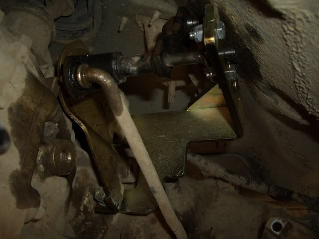

This morning was adequately productive. First, I installed the transfer case linkage bracket from Advance Adapters. It took about two hours including a couple brief coffee breaks, etc. Most of the work was dealing with tight spaces, since I did not drop the transmission crossmember.

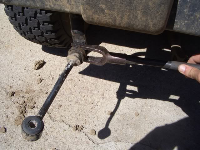

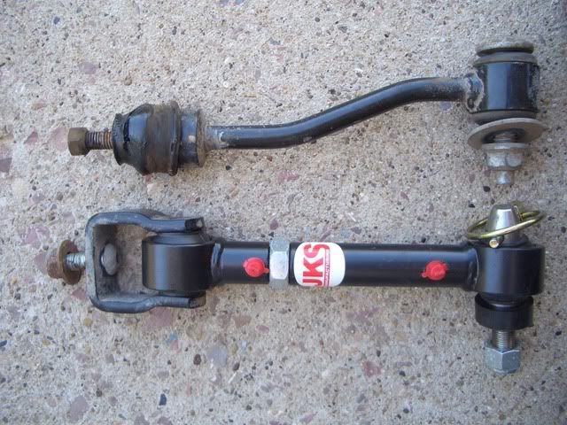

After that, I finally found my pickle fork set & pulled the pressed-in sway bar end links.

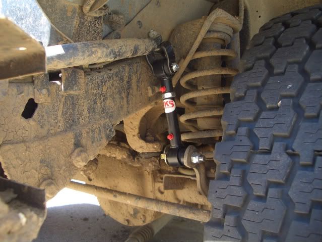

At the shortest setting, the JKS (PN 2000) links are just a bit longer than the stock links.
Narrow Road Jeep Garage
Owner, Operator
2GPS4ME is offline
post #49 of 208 Old 07-15-2010, 12:25 PM Thread Starter
2GPS4ME
Location: 44.1N, 103.2W
Posts: 859
At stock height, the JKS links are about perfect.
Someday, a Currie Antirock system will replace them. For now, they are free (leftovers from my old XJ).

Took the heep for a drive this afternoon, and the Advance Adapters bracket totally eliminated the rattle. I am more than pleased with it, and the transfer case shifts a little easier now, as well.
That was the best purchase (for $35) I've made.

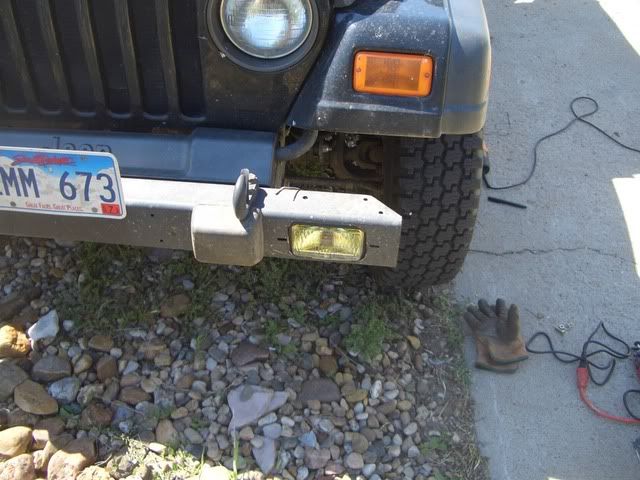

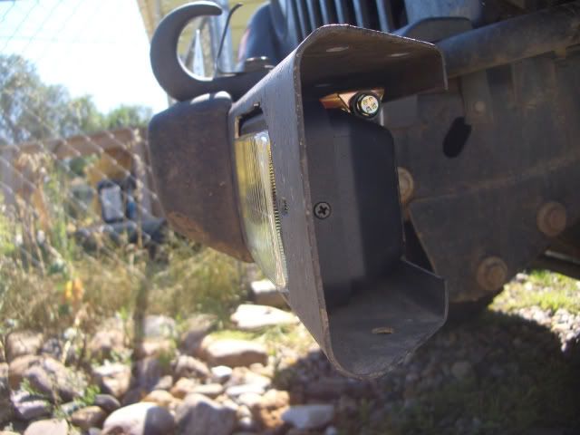

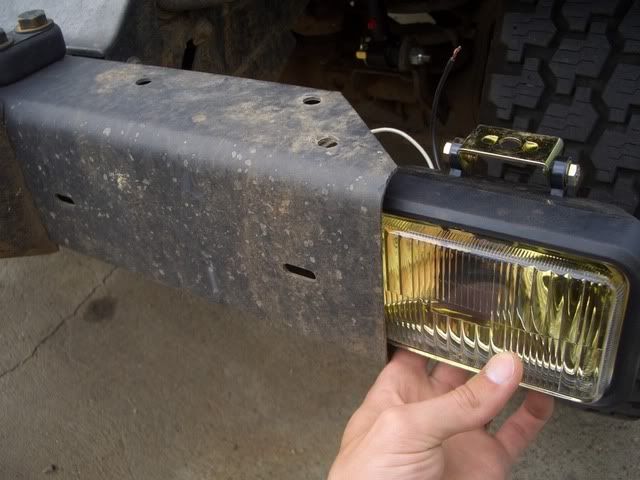

Went with the poor man's plasma cutter. (Someday...)
It's a bit rudimentary now, but the dremel tool will spice it up.
I used the clips/screws that held in the original bumper milk jugs. Turned out really clean!

like the super clean fog light mount!
