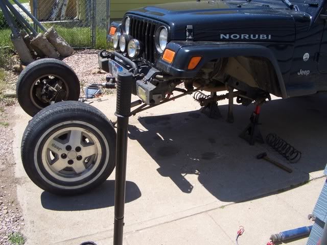

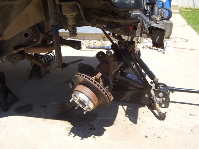

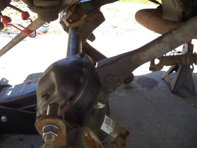

I wanted the gears in badly for Jeep Camp, so I decided to tackle the project myself....
Here is the front coming out. (I used extra wheels to aid in the process)

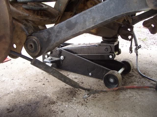

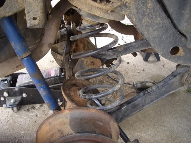

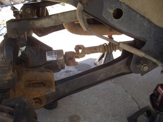

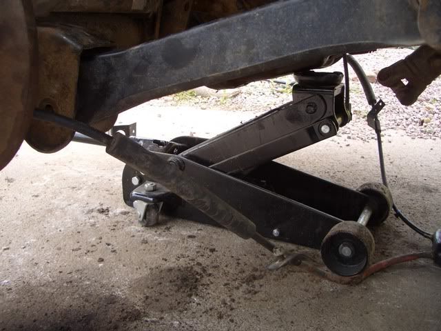

When installing the 'new' axle, I discovered the best way to reconnect was to begin with the upper control arms.
I then moved the jack under the pinion of the housing, which rotated the axle up, allowing me to connect the lower control arms.

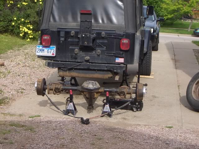

Moving to the rear....
Old assembly coming out...
Using the spare wheels/tires is the easiest way to position everything (especially by yourself)

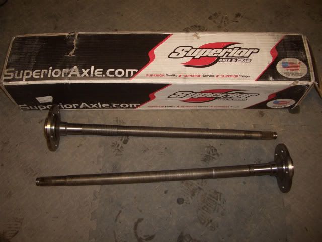

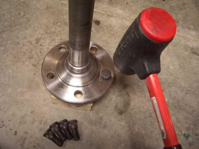

I then removed the lock-right from the old axle, and placed it and the Superior shafts in the new assembly.
On jack stands ready for install.
Superior shafts, and installing new wheel studs. (I went with 1" studs)

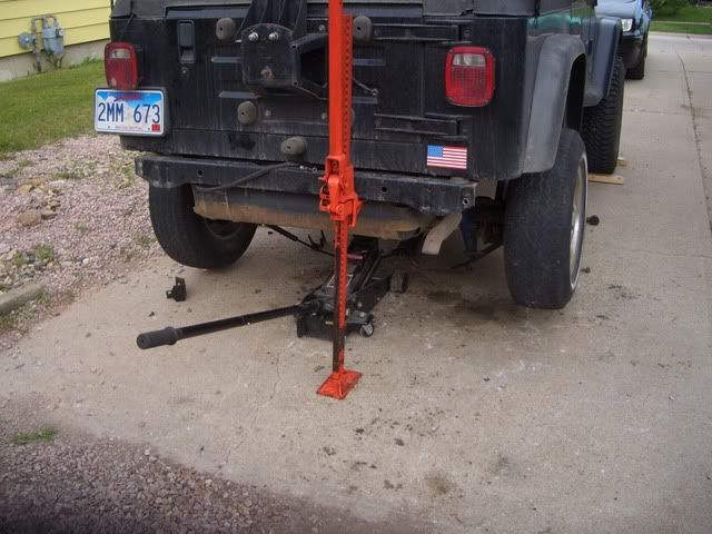

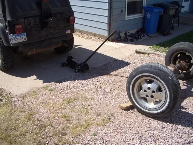

The hi-lift aided in moving the frame up and down to center bolt holes.
Again following the technique from the front, I moved the jack to the pinion side of the diff, which rotated it upward and allowed connecting the lower control arms.

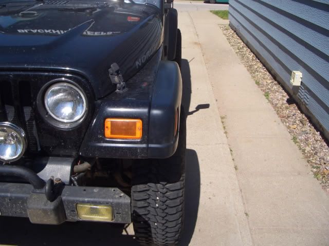

Stock flares with 16x7 wheels (5.5" backspacing), 1" wheel spacers, 265/75-16 tires.

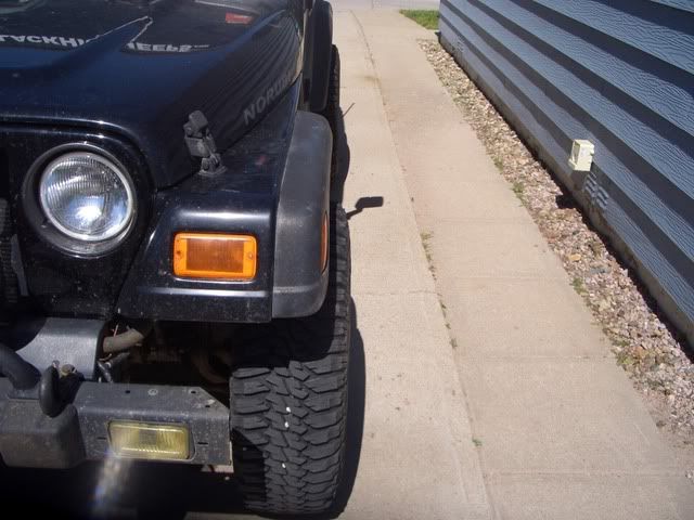

Same setup with rubicon flares.
