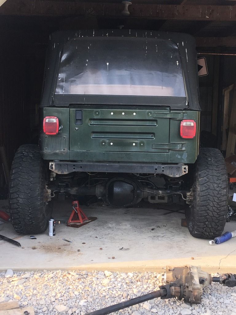

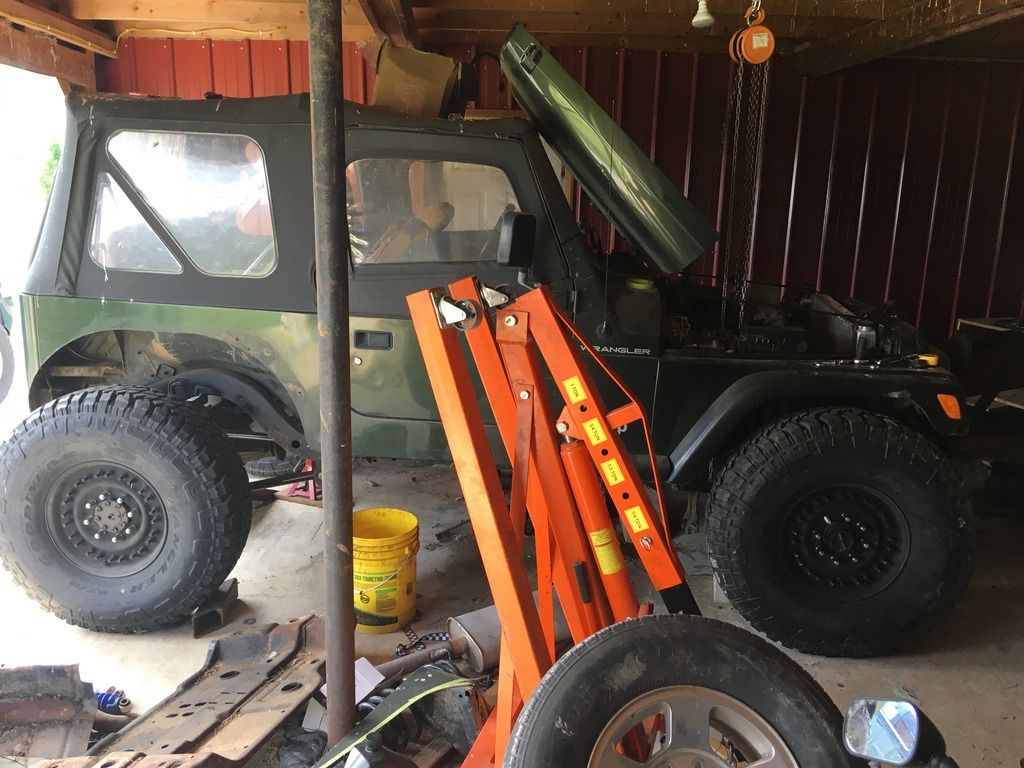

I've had my TJ for some time now. I bought it basically stock on AR wheels and 31s with 150k-ish on the clock. I lifted it 4" and ran 33s on it for a while as a daily. One day I started getting engine noise (box of marbles). At that point I decided to park it and step up the project a notch or two.

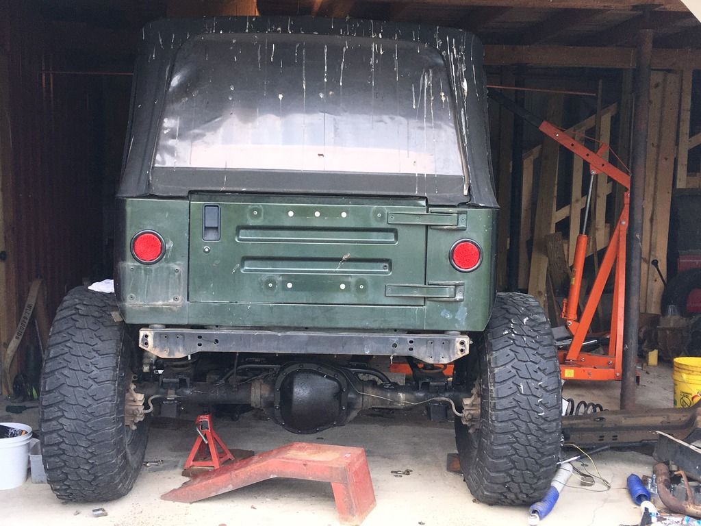

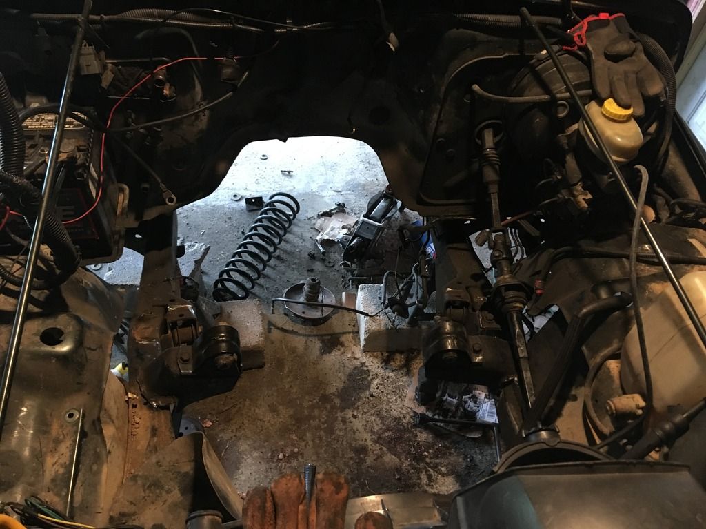

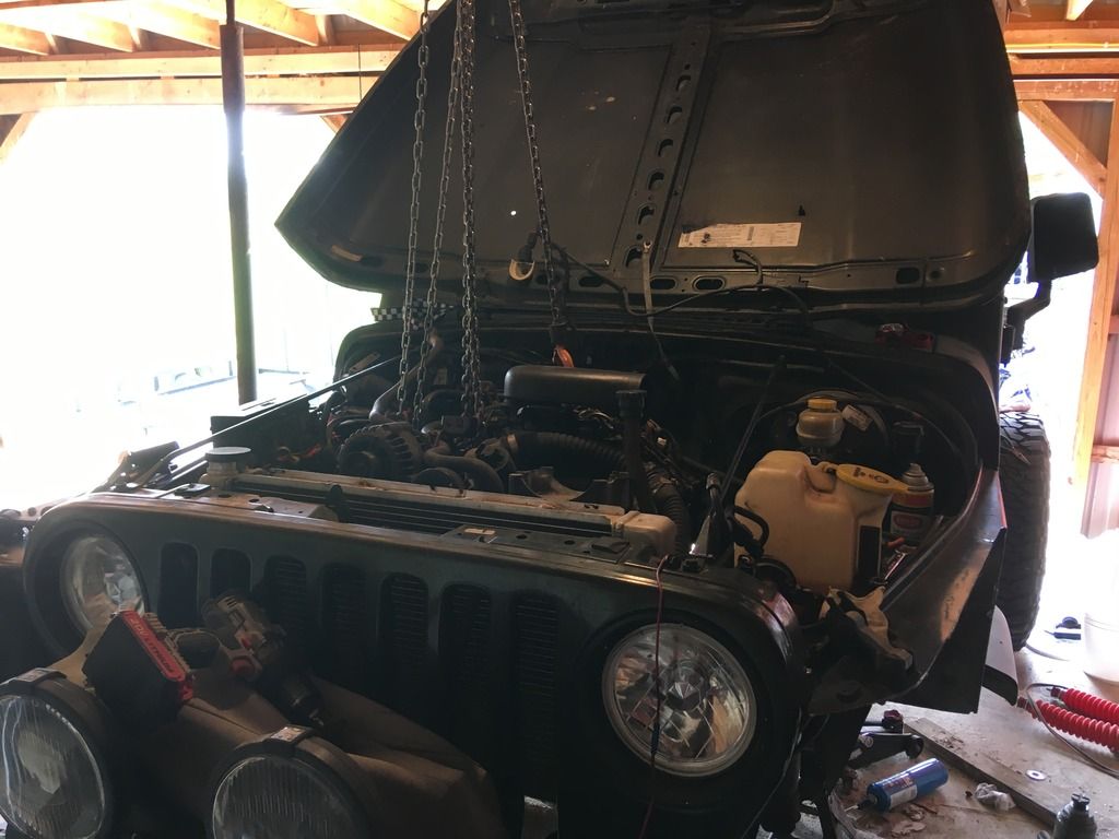

Upon pulling the oil pan I found pieces of the #3 piston scattered. So far I have stretched the rear 7" and got my Sterling 10.5 axle welded up. I have the 37s mounted up on H1 wheels. I have the front axle pulled, but am waiting for my Artec truss system before bringing the D60 under the frame. I also pulled the stock 4 cylinder out last night. I have an SM465 trans ready to go in behind a Vortec fuel injected 350sbc (have to finish pulling out of my GMC Sonoma this weekend. I know I've got to be missing a bunch of stuff, but I'm including a link to my project on Wrangler forum that is pretty well documented. I will post all new updates to both that site and this thread.

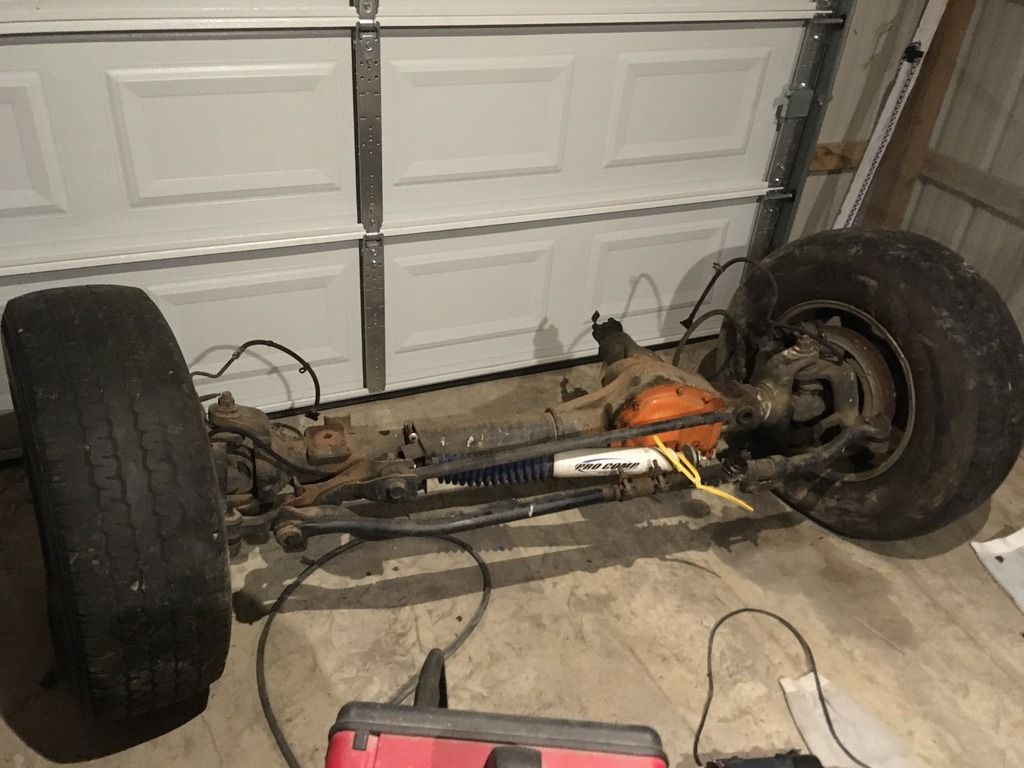

Not a huge update, but I got the front axle pulled out this evening. From what I've heard Artec might possibly have my truss to me in the next 3 weeks or so. I suppose I'll start cutting stock brackets off the axle in preparation for welding the truss on. I'm taking a half day off work tomorrow and will have about 5-6 hours to work before the wife gets home. I'll probably work on pulling the 350 out from the truck.

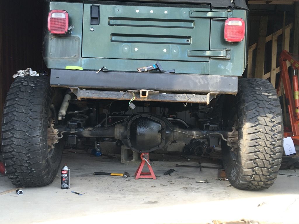

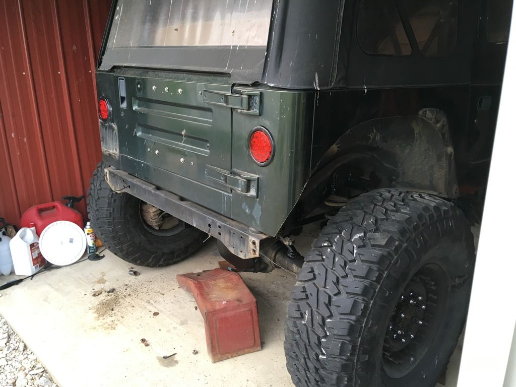

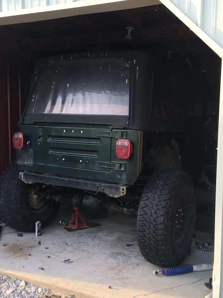

I got the old truss cut out and got my new "mini" trusses and link mounts welded in. I am super happy with the stance now. It has stock springs, but with the thicker axle tubes and relocated upper cool buckets in guessing it equates to about a 2.5" lift. I also removed the rear hitch and bumper. I will probably run a plate style bumper. Tomorrow I plan on trying to get the motor pulled from the truck.

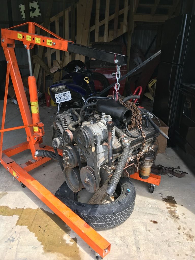

Got the motor out of the truck. About to take a cold shower and ride the bike some. Too hot to work on it anymore right now.

I got the stock motor mounts cut off and tacked in place. I will cut the tacks and fully weld them up with the V8 in place. I just mocked them up to get some rough measurements and see if they were even worth fooling with.

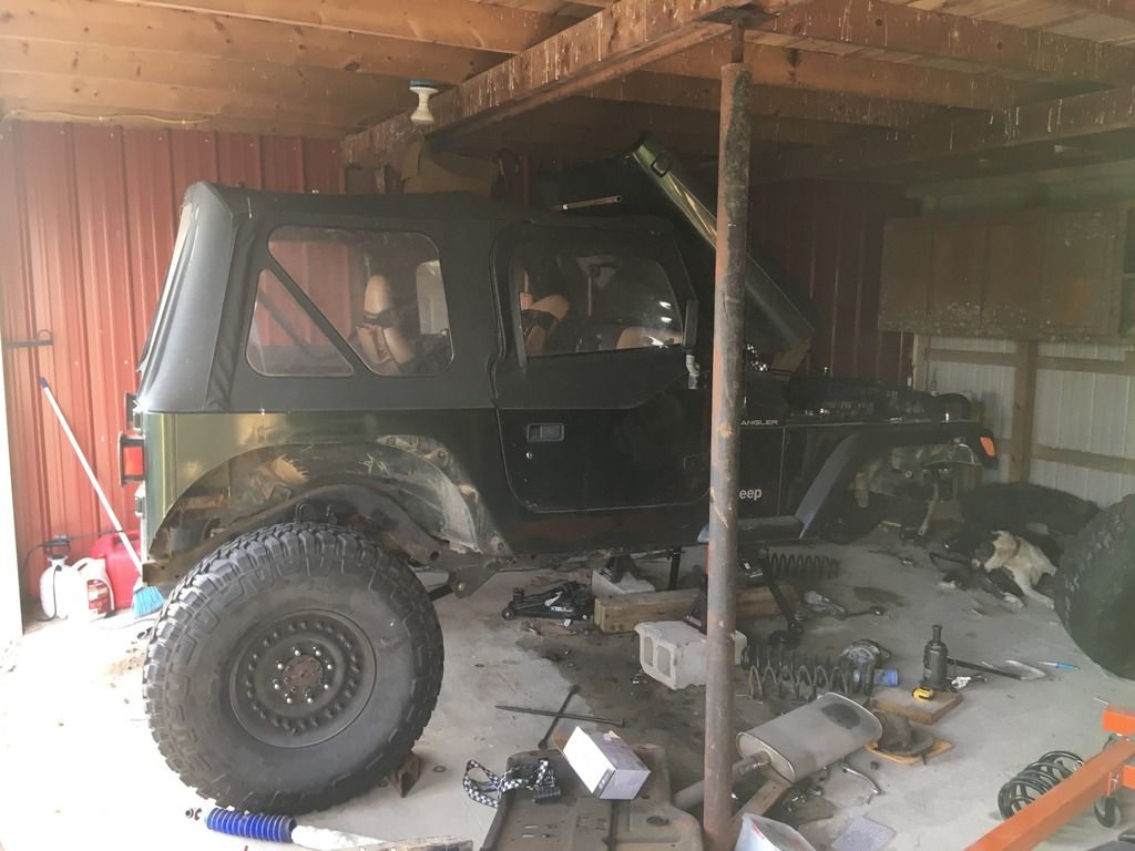

So I measured a thousand times and decided that a slight tweet to one of the tacked motor mounts and everything would be perfect. Welded them in dropped the motor in place. I stepped back and everything lined up great......except the height. It sits about 2-3" too high. I cut some heavy channel to length and drilled holes for the rubber mounts. I'm going to bolt them up and place the motor exactly where I want it before burning them in tomorrow.
I did have a spare hour this afternoon and did this. Actually only took about 40 minutes total. I'm very pleased though I didn't wire them yet. I think for the backup lights I'm going to do an led light bar between the body and rear "bumper"/crossmember or possibly a 2" round LED below and to the inside of the tail lights.

We're getting a little somewhere now......

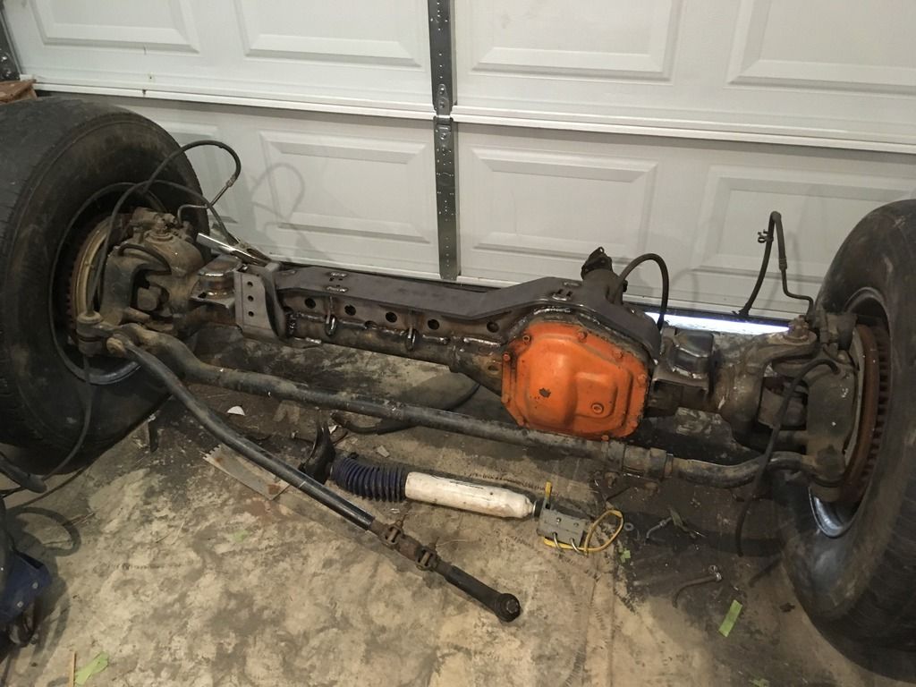

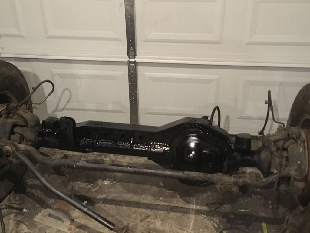

I finally got the Artec truss in this week. I got some free time today and shaved the stock crap off the axle and welded the truss up. I have to spray bomb it, but plan on tossing it under the Jeep for mock up in the next few days.

Had to finish welding a few pieces in for the shock mounts then got it all painted up.
