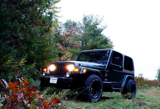

a 2000 TJ sahara, forest green, with 131K on the clock at time of purchase.
32rh Automatic
Dana 30/35 combo (did not know what to look for for a D44) Lesson learned
307 gears, lesson learned
Just found out the wheels that came on her were the 60th anniversary wheels from a donor rig... They are for sale lol...
I liked the color, and the two tone interior... probably the worst reasons I have ever used to justify the purchase of a vehicle.

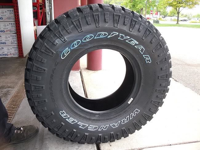

Tires

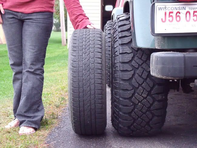

So I purchased "tink" with near bald tires. It was time to get her some new shoes. I knew I wanted to go 33"s and could not see the sense in buying a set of stockers or 31s to just buy another set down the road.
A local jeep guy introduced me to the Wrangler Duratrac.
What a mean looking tire! I did a bit of research on them and immediately liked the M+S rating... the mountain snowflake was just icing on the cake.
I was not worried about a softer sidewall and all the junk I was reading on Tirerack, since I was not putting them on a F350 or something of similar size.
My only fear... chewing the heck out of the tires or my flares running stock dimensions on the driveline til I grabbed a lift.
So I picked up a set of four 33x12.5x15 duratracs from Discount tire. They were looking at me strange when I showed up to have them mounted up without a lift.
Honestly, I had nothing to worry about... yeah I know there is NO room to flex with 33"s on stock geometry but on the highway there are no issues at all. (other than becoming aware of my 307s).
The tires have no rubbing up front lock to lock and do not rub even under heavy breaking. Granted they are mounted on Cragar Soft 8 15 x 10s with 4.5inches of backspacing. This works for me for now. The wife refers to them as my moderately sized tires as I convinced her that 33"s are middle of the road for what people are running...
I think that she is starting to look much better.

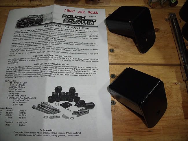

I had also recently picked up a 1.25" BL and transfercase drop just in case.

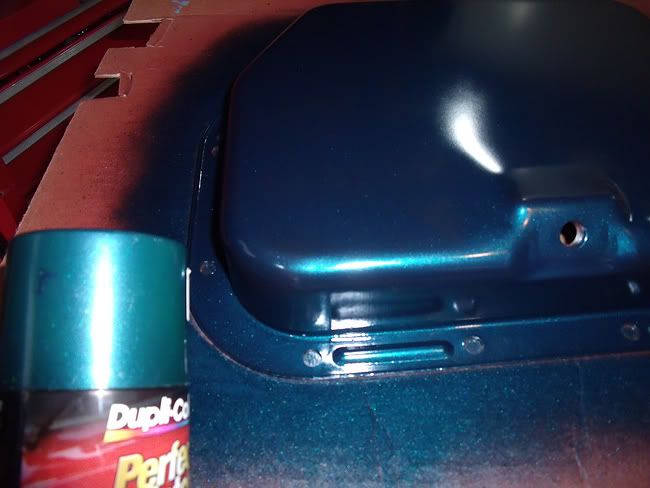

First thing I noticed was the lack of a drain plug on the 32rh. How annoying. After some reading about fluid starvation on inclines I decided that a deep trans pan was a good idea. Besides... it already had the drain plug installed.
Thanks to Summit it was at my door in only a few days....
Primed
Painted
Color match paint my rear end....

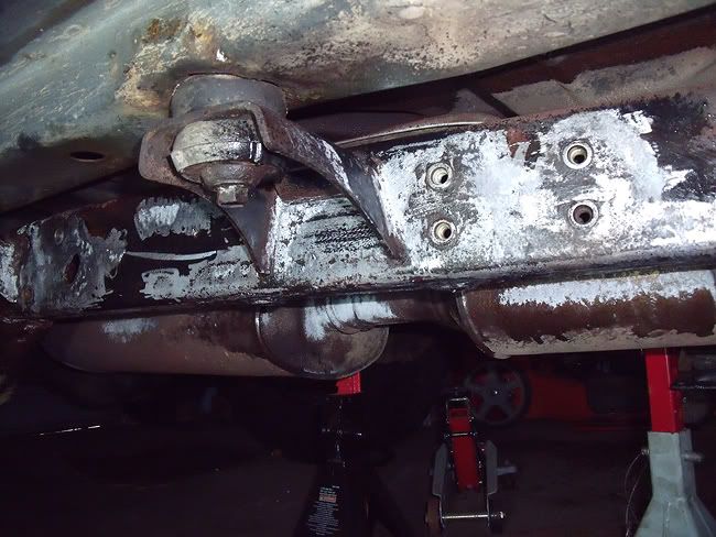

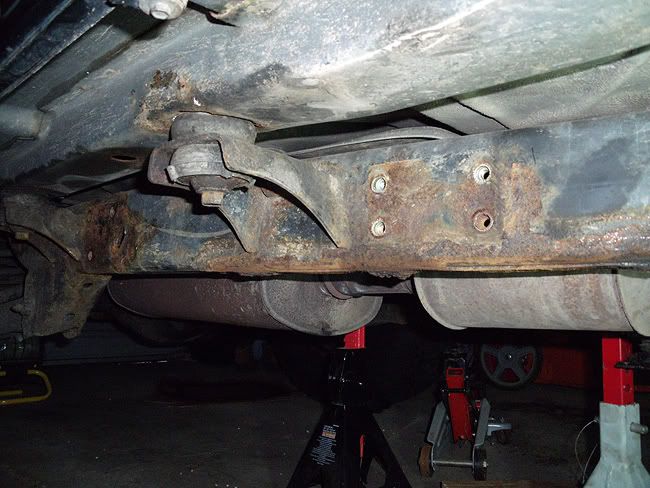

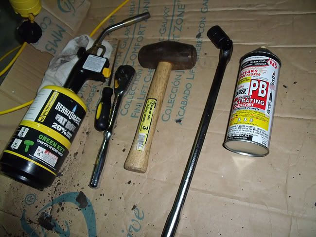

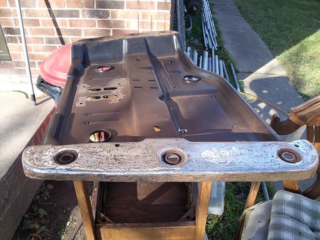

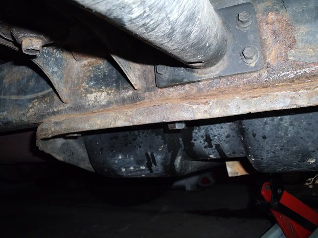

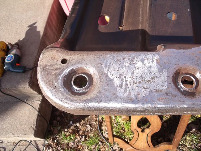

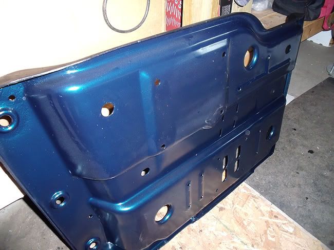

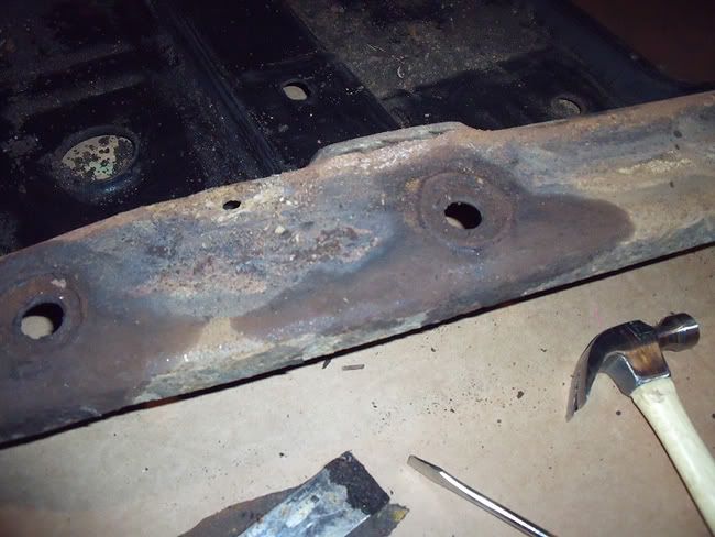

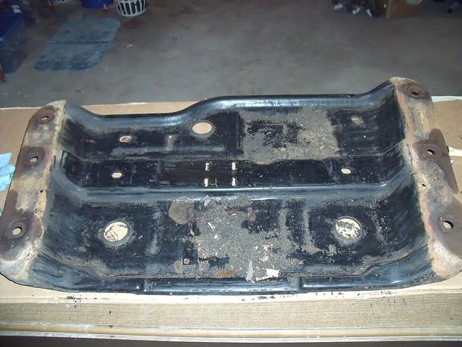

Belly Skid ie Rust sponge

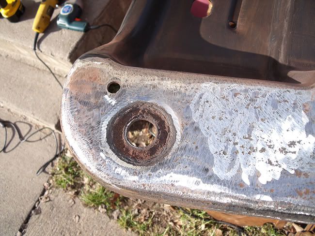

So it is time to remove the bellyskid. Here are a few things I used to help in the process...
Turns out there was about 3/8ths of an inch of scale rust between the skid and the frame. It was originally more of my frame than the skid as evidence by the holes found in the bottom of the paper thin frame rail.
Skid off and start of the cleaning process
Grinding gone wild!
LiftThis is offline

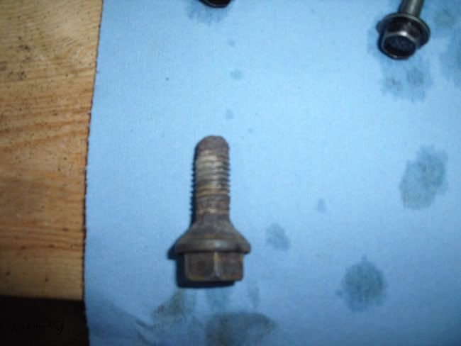

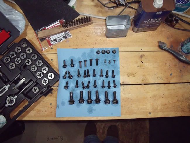

Hardware

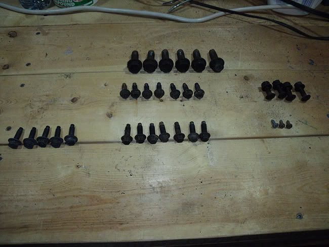

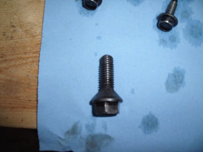

If you are going to clean up all the big stuff it only makes sense to do the small stuff as well.
All small parts were vibrablasted, dipped, primed, painted and cooked prior to install
LiftThis is offline

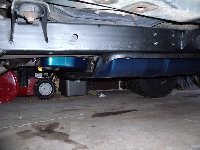

Tuning the 32rh
So I dropped the pan with minimal mess and adjusted the two locations on the trans for the bands...
The front one was a torx fitting for the primary adjuster... hmmm
Even though I do not understand the exact reason behind the method used in the FSM I followed it and the adjustments went well. No more slipping when cold. She shifts like a champ... now to just make it 2 weeks without a catastrophic failure and I should be over the hump lol.

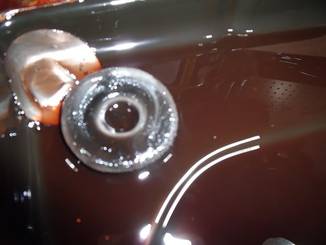

The wife and I pushed a total of 14qts of AFT+4 through the system on a full flush from the passenger side return line. It ran out nice and clean at the end.
Nope that is not a picture of fireworks... it is shiny metal shaving in the bottom of my trans pan!
Just a bit of debris on the magnet

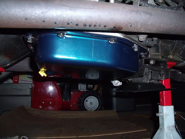

Skid ready for reinstall
Deep pan on
All buttoned up! Frame rail looks perty again as well...

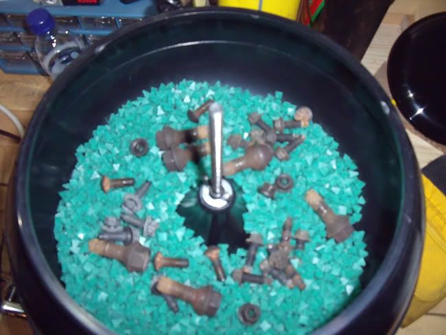

What is this "vibrablasted" thing you talk of. Is that the treatment in the bowl?

Yeppers
All the small stuff is put into a vibrating tumbler along with whatever media you are going to use. (ceramic chips in this case).
You can add various chemicals depending on what result you are looking for and the condition of the parts you are putting in.
These were only in the machine for about 3.5 hours and came out rather nice.
I ran a tap and die through/over all the hardware as well after it was cleaned up. It is amazing how well a set of cleaned threads work during reassembly.
As far as all the work into the stock skid, it really was about 2 hours of grind and prep. Besides, discovering the holes in the frame has shrunk the list of mods that "Tinker Belle" will get. She has been demoted to a DD that will only see light offroad. (mud, and the occasional pile of rocks).
Now doing things on the cheap, she is getting a RC 3.25 combo lift to clear her 33"s. Yes I know you get what you pay for, I am curious to see just how rough the 2.2s are. The 33" beachballs out on the corners have softened up her ride considerably.

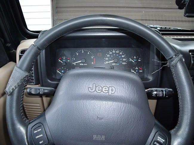

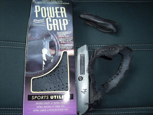

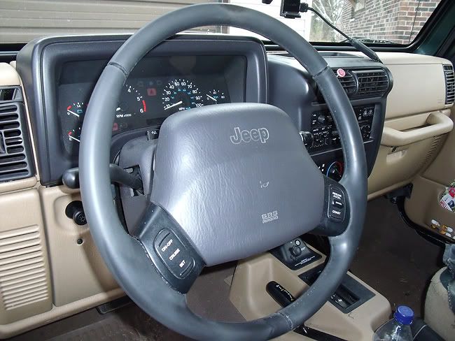

Steering Wheel

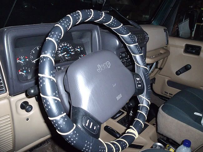

So the Original Owner of Tink had an issue with the top of the steering wheel. He either rubbed it... a lot... or chewed on it while sitting in rush hour traffic. Either way he wore a hole through the leather wrap on the wheel.
Side Note: I have noticed that with the lack of a comfortable elbow rest in a jeep that I also put my hands at the 12 o'clock position while driving. This is not a normal spot for me.
One day the wife and I were out for a drive and I realized I was getting a "look".
"What?" I said
"You need to do something about that steering wheel... I am starting to get jealous."
It would seem that I was "occupied" by the torn leather while driving... huh.
So it was time to fix it so all would be right with the world again.
My cheap fix
The leather cover actually comes off nicely
All stripped off... without the cover it is still comfortable but was a bit thin for my liking. Not to mention some ugly joints in the foam.
Here is the cover after it was stretched to fit. I promptly broke the plastic bands that are supposed to hold it to the wheel.
After a trip to Wally World's makeup and beauty section we scored a green leather cord... Tah Dah!
All done, though I will have to restretch and wrap it this summer after everything settles in.

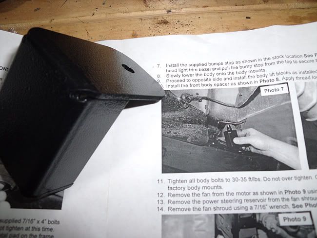

Who wants to install a Body Lift!?!
So it was time to install the 1.25 inch Body Lift that came with my Rough Country combo lift.
Step 1. Read your instructions and check your parts to make sure you got everything.
Oops... we didn't even make it past step one....
The kit instructions and list of contents refer to New bumpstops for the front grill area. No bumpstops... but I did get these two interesting metal pieces... hmmm time to call Rough Country. Thanks to the wife for looking up their number for me while I was out in the garage.
One of these things are not like the other...
According to the tech at Rough Country (didnt get his name... shame on me) The little box things replaced the new bumpstops... pictures 5 and 6 show them in the instructions.
Well that is fine and dandy, but the pictures show something similar to what came with your package and only refer to needing to trim "original" plates to get the "new bumpstops" to fit.
The tools needed section of your instructions does not mention a drill. Nor do the instructions mention mounting this metal bracket. Only the removal of the old bumpstop to make way for the new.
Thank you image 7 for showing me how to install the new bumpstop... errr wait, your kit no longer has those, just brackets...
Oh well, onward and upward....
