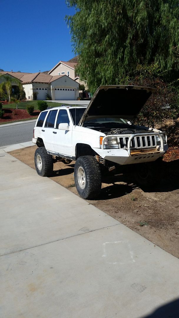

I started off with a 91 YJ that I've been slowly building since I was about 18 after about 7 years it turned into this
Then decided I wanted something with more room, doors and a top
While searching for a Cherokee I came across a Grand Cherokee that was half the price of a Cherokee and way more built
So this is going to be a budget(ish) build
97 Grand Cherokee

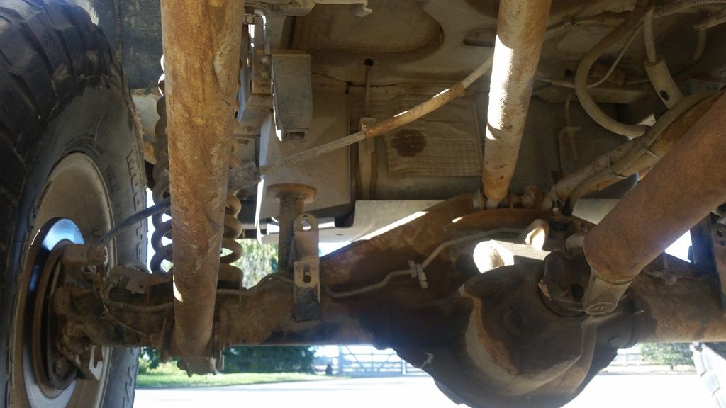

For only $1,200! But it needed some work

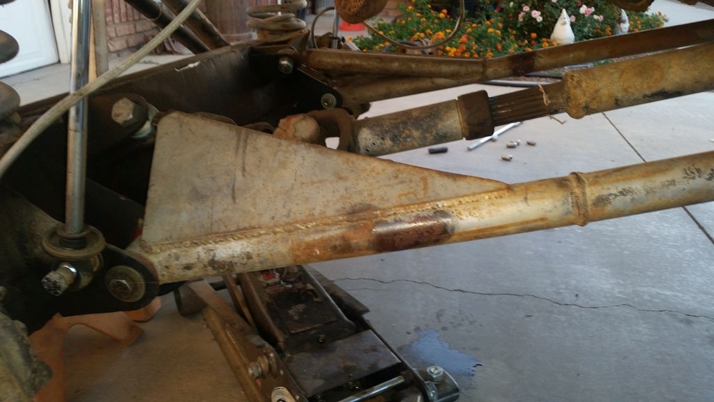

Passenger side arm broke and got a trail fix

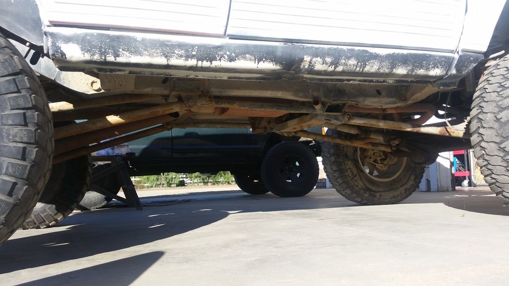

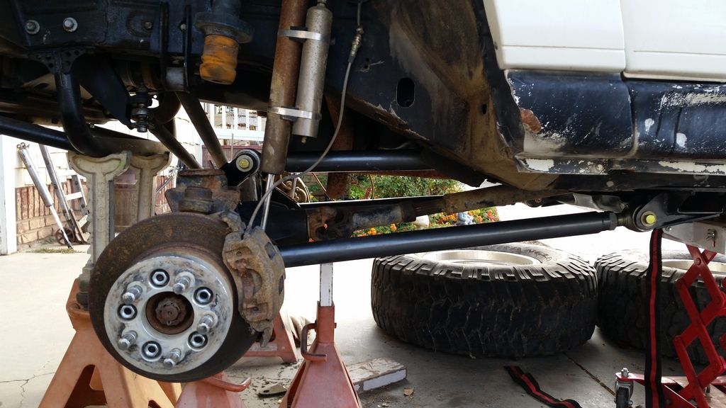

So the first thing I did was 3 link the front
The old

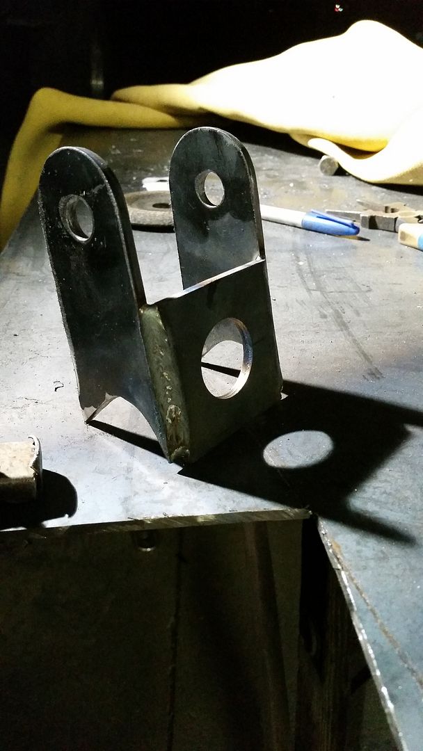

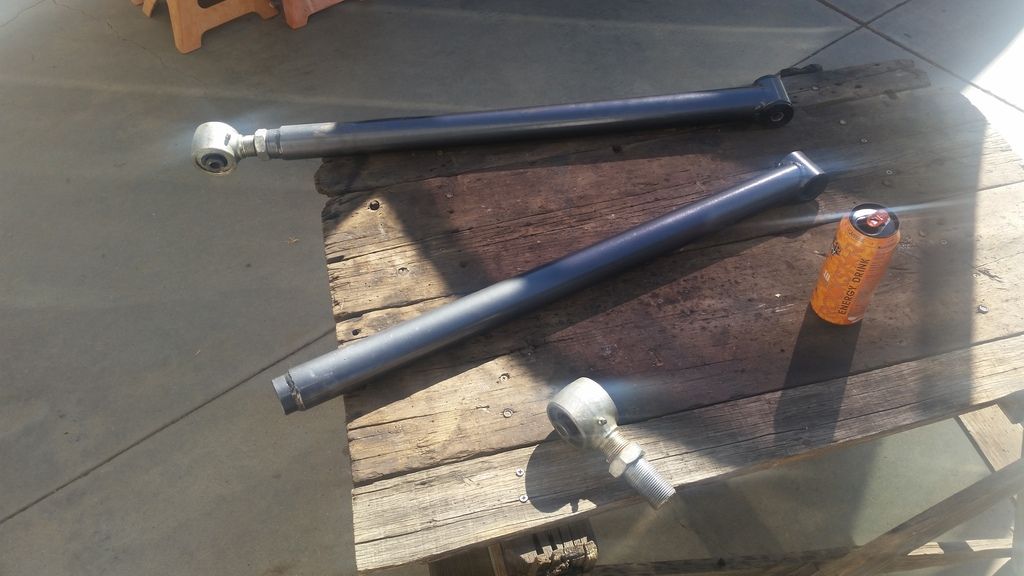

The new

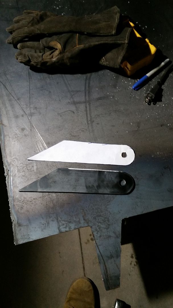

New lowers 2" .250 wall DOM

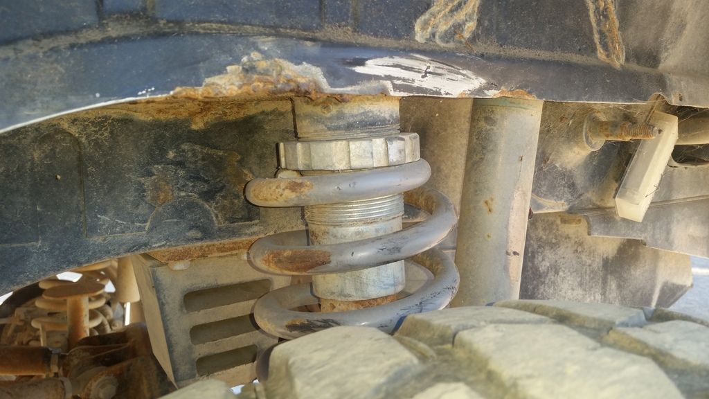

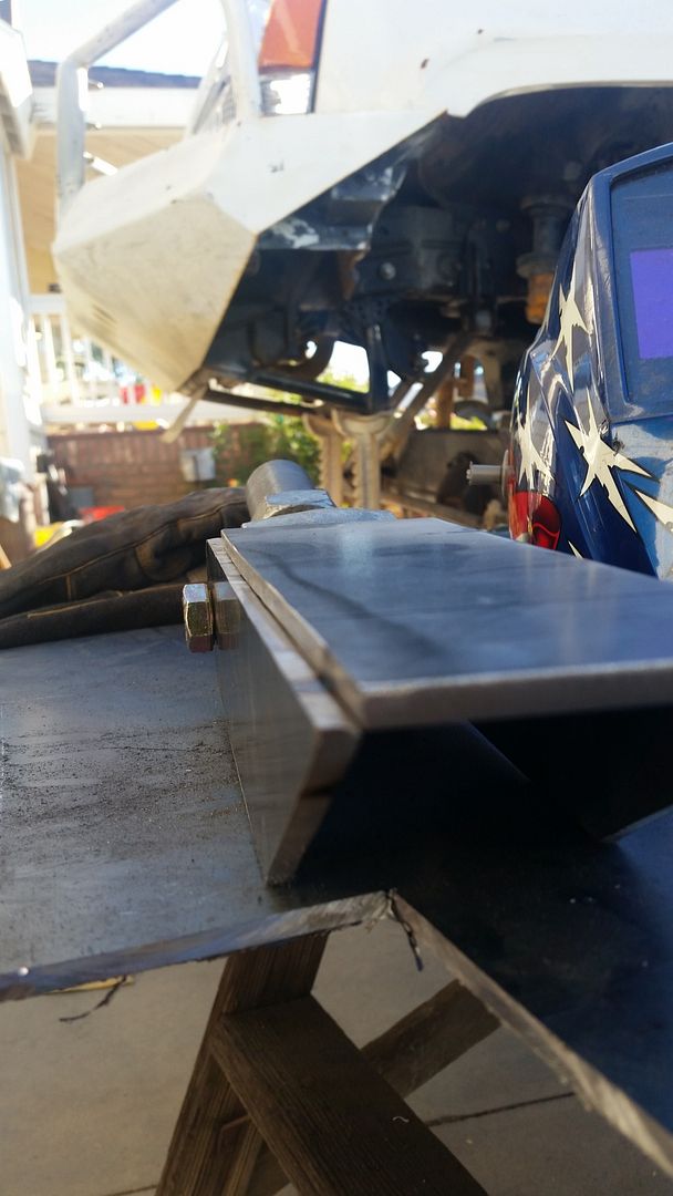

Upper link bracket frame end

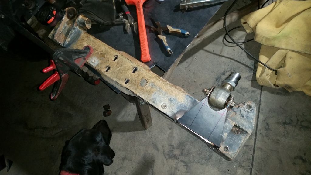

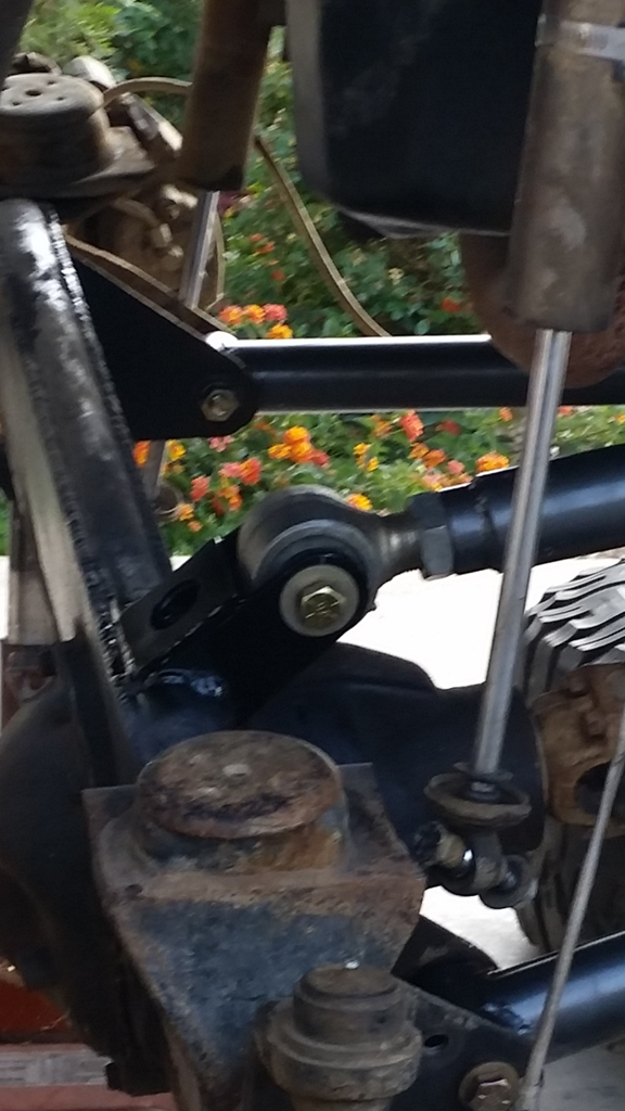

Upper link bracket Axle end

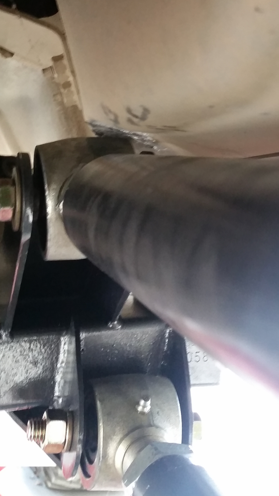

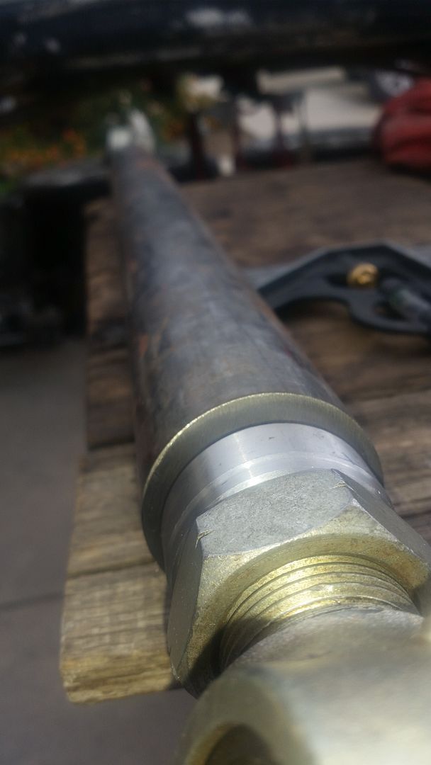

The upper link is also 2" .250 wall DOM
clearance is a little tight
Finished
That's where I am now I still have a list of stuff I want/need to do

I see why it was 1200. Looks like you are fixing the bad parts though. Got another closer shot of the upper mount?
Ya it's a POS! do you want a close up of the frame end or axle end upper mount?
Axle end, just looking at the till-kinda thing going on. I might have a packaging issue and might need to do something like that.
This is the only picture I have on my phone. I can get a better picture this weekend if you want one
the reason its leaning forward is because I wanted my lower and upper links to be equal length. The axle end mount was built last and that's just where it ended up
