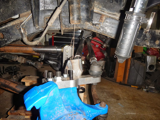

So this is where Im at with this.. I bought the poly performance front 3 link kit. It came with pre-made track bar mounts for both the axle side and the frame side. I started trying to get things worked out and i'm having issues with the passenger side spring interfering with the track bar. If i use the mount that came with my kit, and maintain proper steering geometry, the setup looks like this:
Wheels straight:
Full left turn:
Obviously there is plenty of room between the drag link/steering arm and the drag link/drag link bracket, so theoretically a bracket could be fabricated to push the draglink out, like this:
Wheels straight (the bolt and piece of steel are just there to simulate the bracket):
Full left turn:
Shown with a spring in the stock location. The spring is already pushing against the drag link and is not at all compressed. I think that as it compresses, it will bow out even more:
This isn't going to work so I think I'm looking at Coilovers or ORI struts only because of convenient packaging. I'm leaning toward the coilovers at this point because they are more "tried and true". i have looked at a lot of builds that use this style of dana 60 and coils springs but they all have the trackbar mounted inboard of the passenger spring which, from what i can tell, means it is too short.
I'm going to use the bracket I have and see if I can fit the coilover/strut and if i can't, I'll make a new bracket. I think it should be OK, as long as I angle the shock back just a little.
