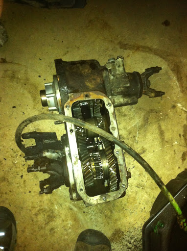

Over the holiday I got to talk to my Uncle and he had a 1986 Dana 300 he didn't need and was happy to get rid of. He also tried to give me a T-176 and an AMC 304. Only the 300 would fit in my Subaru and it's probably best that way.
I just took the cover off and the internals look to be in good shape. I'm going to clean it up and start thinking about which way I want to go with it.

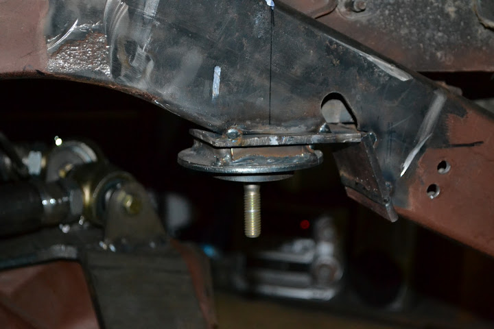

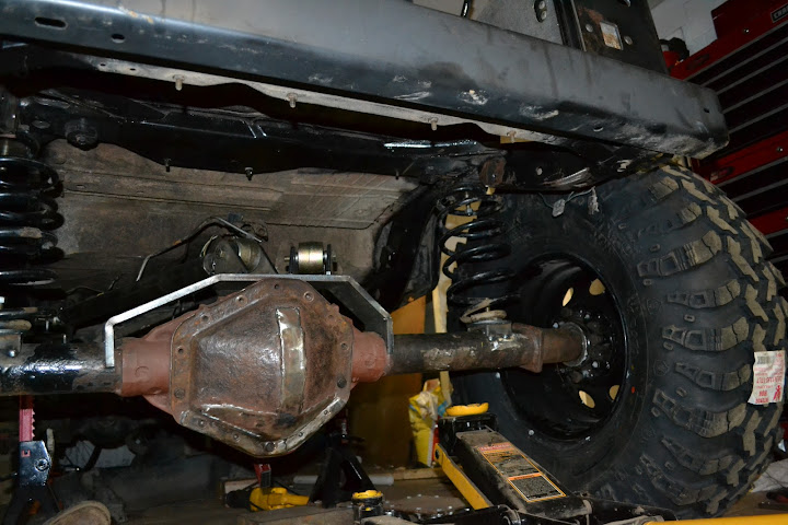

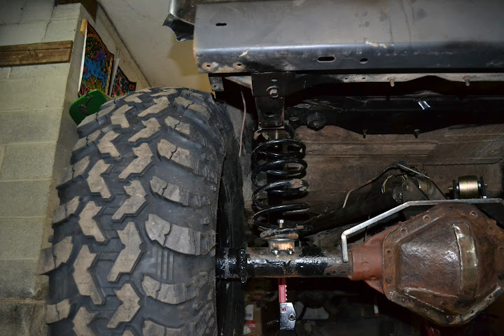

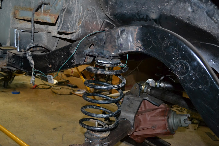

So as I discussed before, I had to do something with my frame side spring brackets to move the springs back inboard so the don't rub the tires. I was also unhappy with how the frame notches came out so this was a good opportunity to re-do them.
I ended up deciding to just cut the upper portion off of the BTF spring brackets so I could slide them further under the frame. I also cut off the plates I had welded into the frame so I could more easily attach the modified brackets to the frame and make the notches more consistent.
Now my springs are 39" center to center an the frame notches are wide enough to accomodate the spring when it compresses. I still have to finish plating the driver side frame notch and re-do the fish plates to match the new notches. I also think I may need to shorten my upper links just a little.
I didn't get quite done with everything but I got close enough to put the springs in and tires on and see how it looks. Anyway, onto the pics:
Passenger side:
Driver side:
Passenger side then driver side with spring installed and supporting weight:

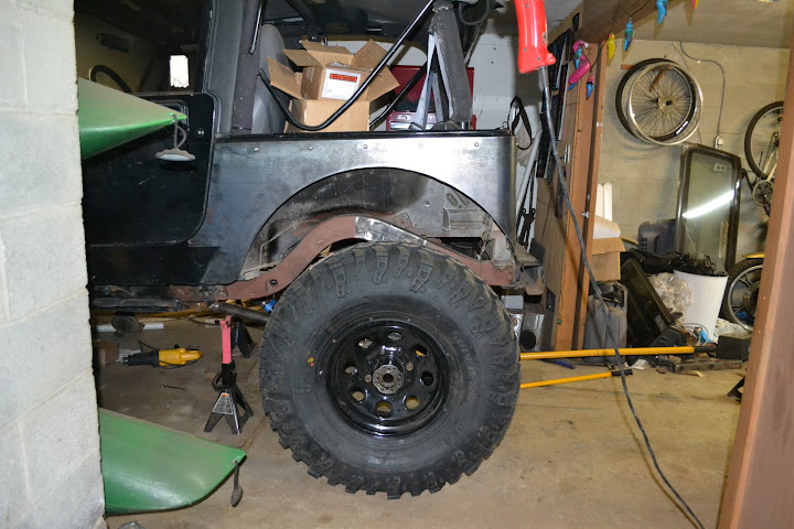

Some other pics I took today:
It looks a little bit tall here but I think it will settle a bit then there is a fuel tank with fuel in it as well as a spare tire and other things. Right now my 4" lift springs measure 12.5"+. I may end up with some shorter springs but for now I'm going to let it ride.

For the sake of clarity the jeep is not sitting level in the last photo because the driver side lower link got hung up on the jackstand that has been supporting the jeep for the last few months. I'll be so glad when I can take those out.

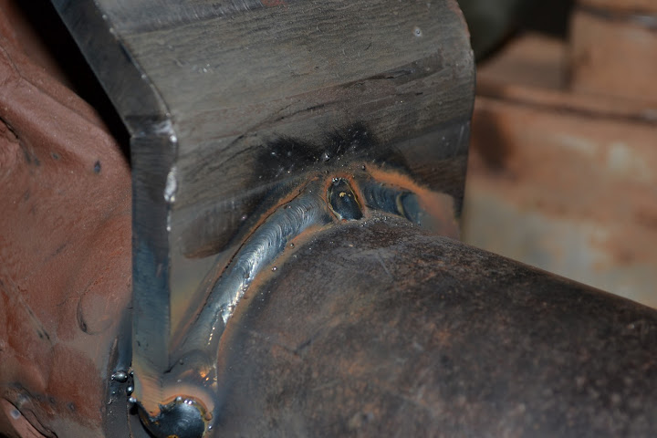

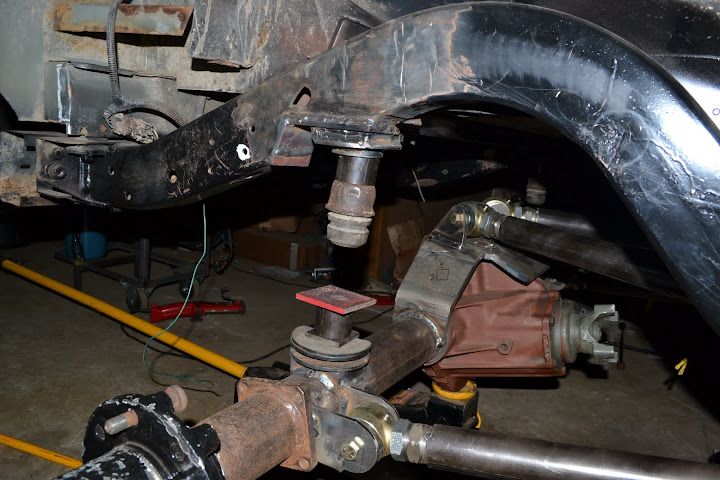

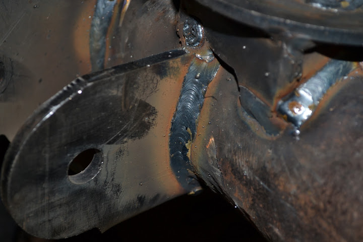

Today I put everything back on and the the flex out test. Everything looked good so I decided to weld everything up on the axle. I think it came out nicely but I did have a lot more spatter than I wanted.
Upper link tabs on the axle truss.
Axle truss to axle tube. Does this look it could use another pass? I had a bevel on it because the axle truss is 0.5" plate so the first pass really just filled the bevel.
Lower link mount:
