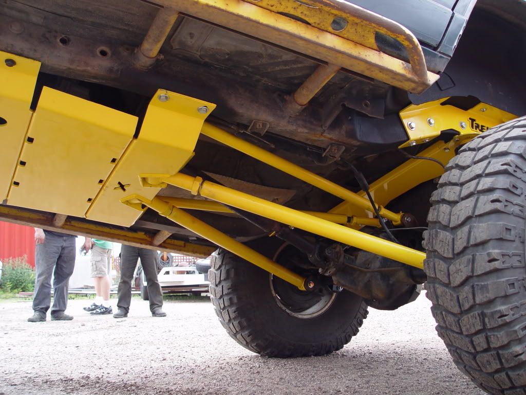

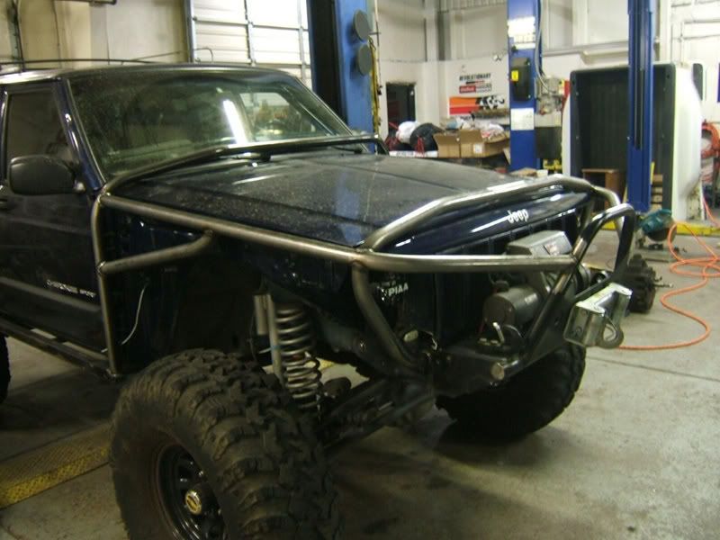

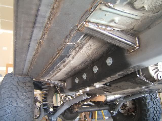

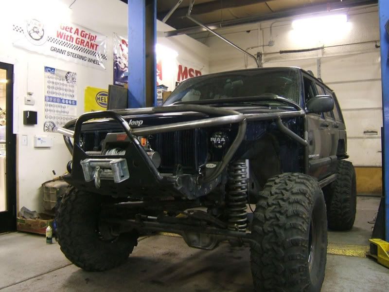

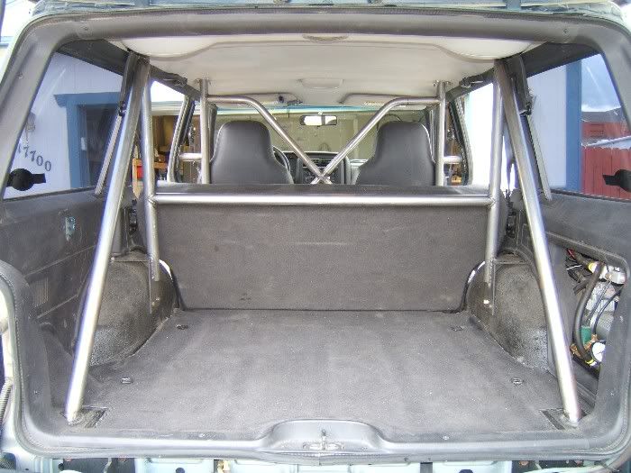

Potential Long term plan
Possibly fix the damage from getting t-boned and cover it in armor. Eventually building a Hybrid rear/exo front to complement the rear armor
Rear corners:
Rockers:
Inspiration for the Hybrid cage:
Inspiration for the Front Exo:
Some where I'd like to do a rear 4 link possibly using a few TNT components. Like the rest of the belly pan and rear cross member from their 4 link kit(all the yellow stuff in the pic minus the arms), and building my own arms.

Old 09-30-2009, 03:32 PM   #5
gribbles
Location: Indianapolis
Posts: 2,181
so, did you win the powerball? or is that tonight?
also is that second pic at the badlands?
No, I didn't win guess everyone is going to have to wait to go crazy with their builds.
And yes, I do believe that second pic of the back halved XJ is at the Badlands, the guy lives up near Ft. Wayne some where I think.
