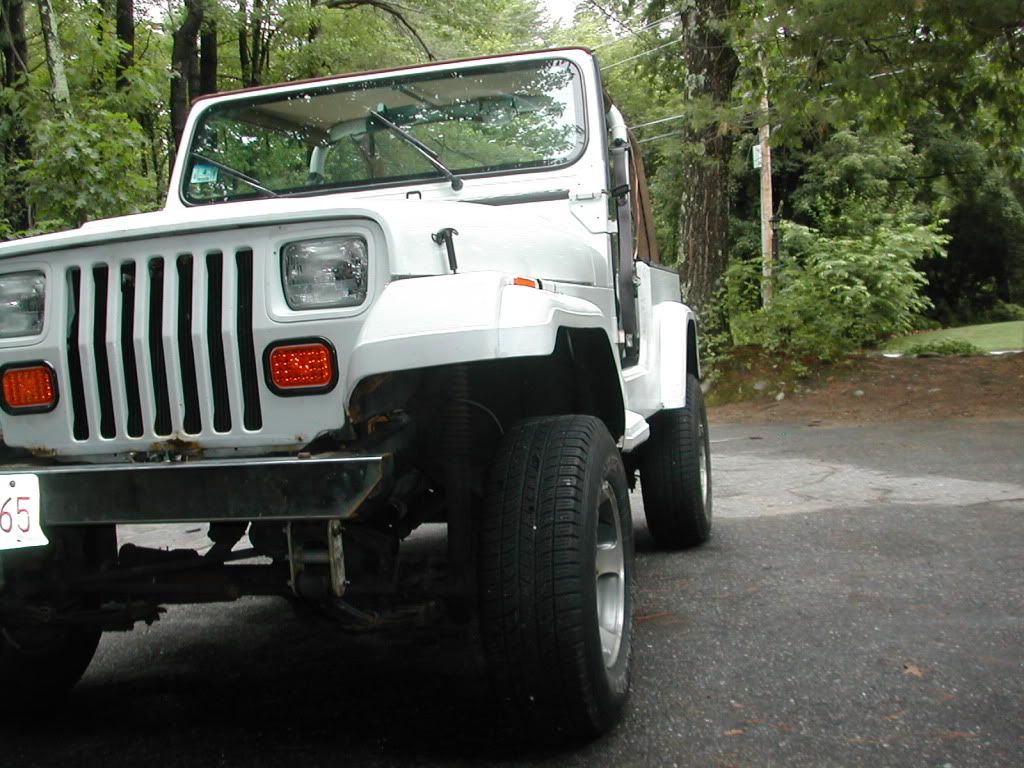

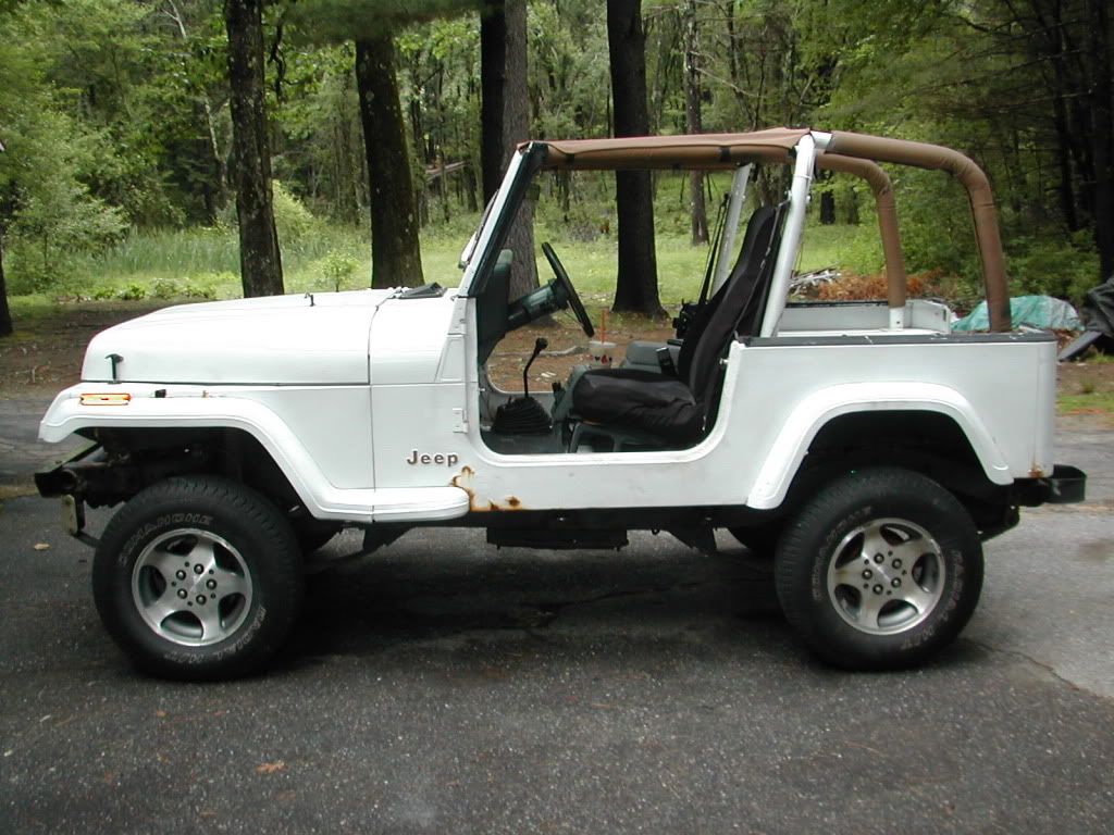

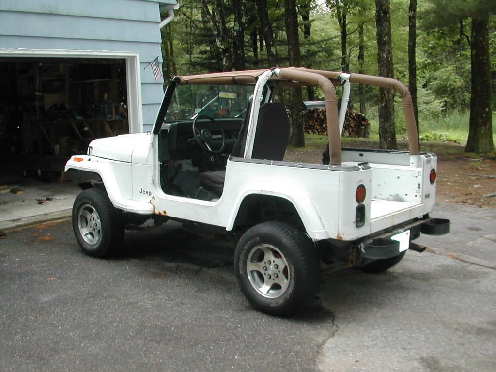

No, I didn't do a write up for the front blinkers. I also haven't replaced the side markers yet. That will come when I purchase and/or fab up some tube fenders. For the front turn signals, I made a template on the computer to the exact dimensions, then traced it onto the front clip and used a body saw to cut it out. Went very smoothly and the grommets allow for some error.
I finished the body lift recently, now I just need some new shoes. Running ~3.5" of lift on 235/75R15 is a funny looking stance. Right now it measures out at almost exactly 22.5" to the rocker. That's just about 3.5" of lift with 1" extra for the 235's vs 205's.

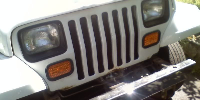

Blacked out my headlight bezels yesterday. They now match my turn signals and I love it.

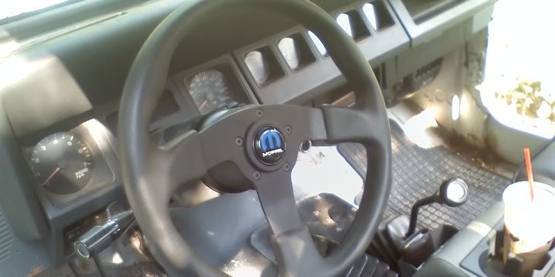

Thanks for the kind words guys. Got some more parts in the mail today, replaced the steering wheel with a 1" smaller wheel (diameter) thats a bit thicker than stock. It fits my large mitts quite well. The draglink needs to be adjusted to center the steering wheel, but I love it. Had to spend the extra $15 and get a MOPAR horn button
