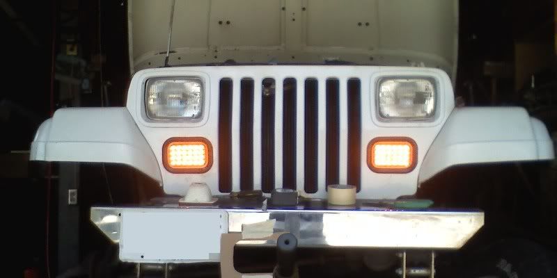

Superbrightleds.com is where I got all of my LEDs. Prices are pretty decent, and the selection is large. I might add 2 side marker lights, one on the rear corner in red to bring my YJ back to all lighting legal standards, and a front side marker light in amber near the Jeep logo.
I got the front turn signals installed today, but ran into a rather large snag. I already have the EL-12 flasher for my turn signals, but the front LED's run super high resistance, so the jeep thinks the bulbs are out. I do not have turn signals or hazards, and the LED's are always on when the lights are on. It does make it easy to get a brightness picture though. haha.

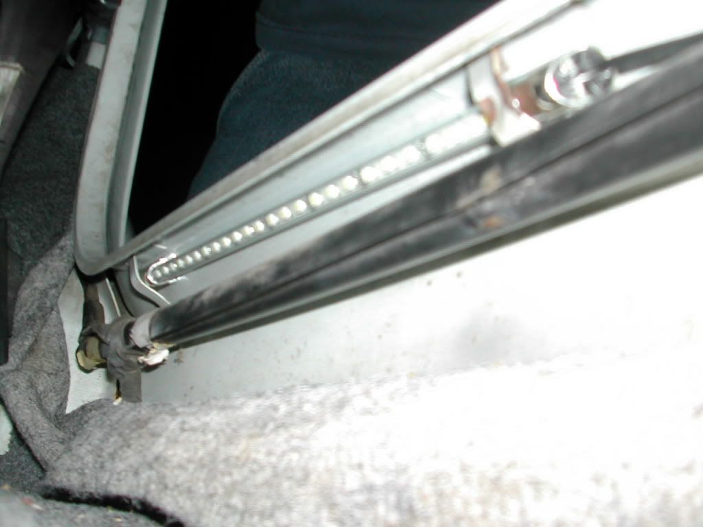

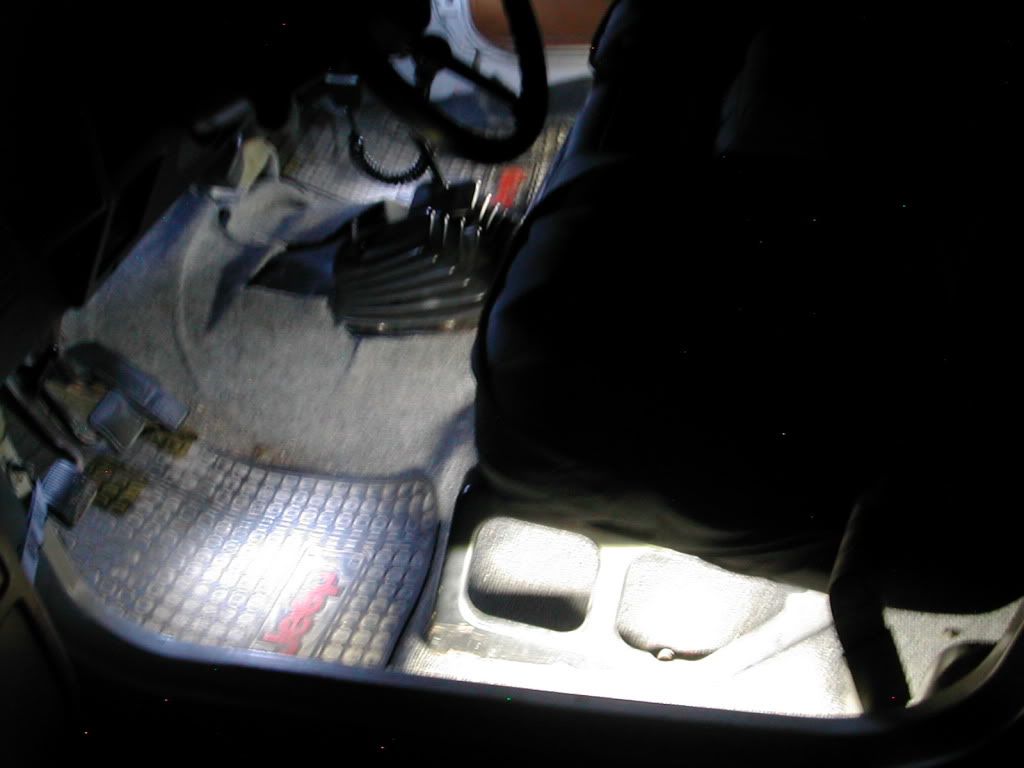

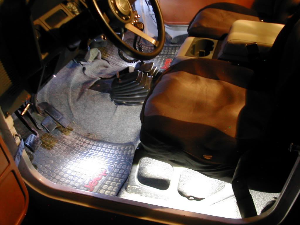

More LED's installed. Two 6 LED pods under the dash, one on each side, centered in the footwell. Two 24" LED tubes, one under each door sill. They're not as bright as the camera makes them seem, they are the perfect brightness. I wired each side into the stock courtesy light harness, and will add another door switch to the passenger side and plug in the stock connector over there as well. The LED's are also controlled by the rolling dash switch, which is another good thing. Also in these pics is my new seat covers.
All LED's on, with the roll bar light on as well.
Rollbar light off, 4 LED's on.
No, the speaker wire isn't going to the light pod, although it appears that way in the picture. The pod is the black thing on the bottom edge of the dash.
And a shot of the LED tube.

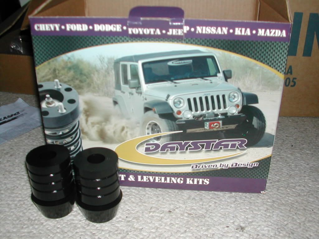

Got a few things done to the Jeep recently, and got even more in the mail.

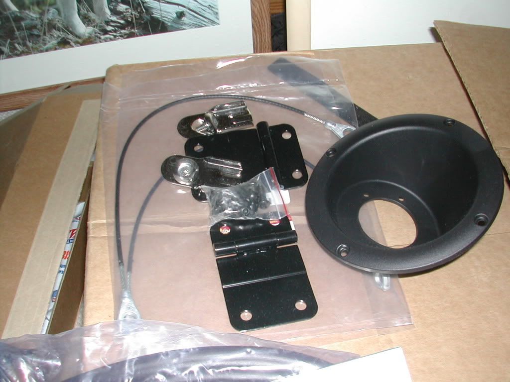

Also ordered up a few things... Most notably is the CJ-7 tailgate and hardware. Going to take on the tailgate conversion this week hopefully. This will get rid of the rusty, rattling POS tailgate as seen in the pictures. Also in the mail is a Daystar 1" body lift. The stock mounts are long over due for a changing and I figured why not gain a tiny bit of clearance as well. 2.5" springs and a 1" BL will be the highest I go on this Jeep. Next up will be tube fenders and 35's, if not 37's.

Yes, I did. Although once again I was troubleshooting around a broken part, so I'm not 100% certain. I ended up putting a 25w resistor at each corner (One on each turn signal) and after that I replaced the turn signal flasher with a Blazer unit from Autozone. Now the hazards work and the turn signals work all the time as well.

Quadratec order came in with a few misc. soft top parts as well as the TJ gas bezel and hardware for the CJ tailgate conversion. I went with the OEM hinges because I read on here that they are beefy ... and indeed they are. Today the Daystar 1" body lift came in, and the CJ tailgate as well. I'm going to leave it black and so begins my Black & White Jeep color conversion.
