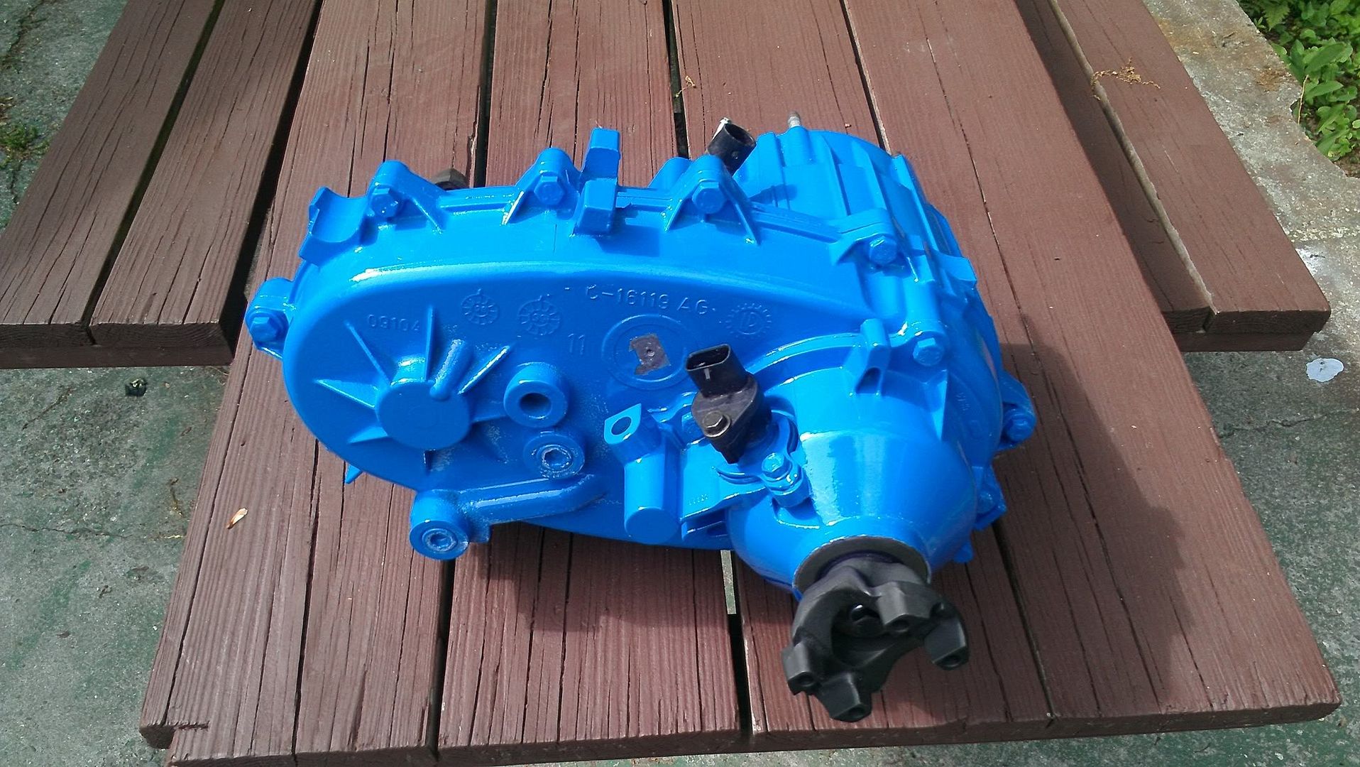

Got my Tom Wood's NP-242 late style SYE installed today. Going to bring it to work and give her a nice coat of industrial paint, and get to installing it.
-Matt

Painted the 242.

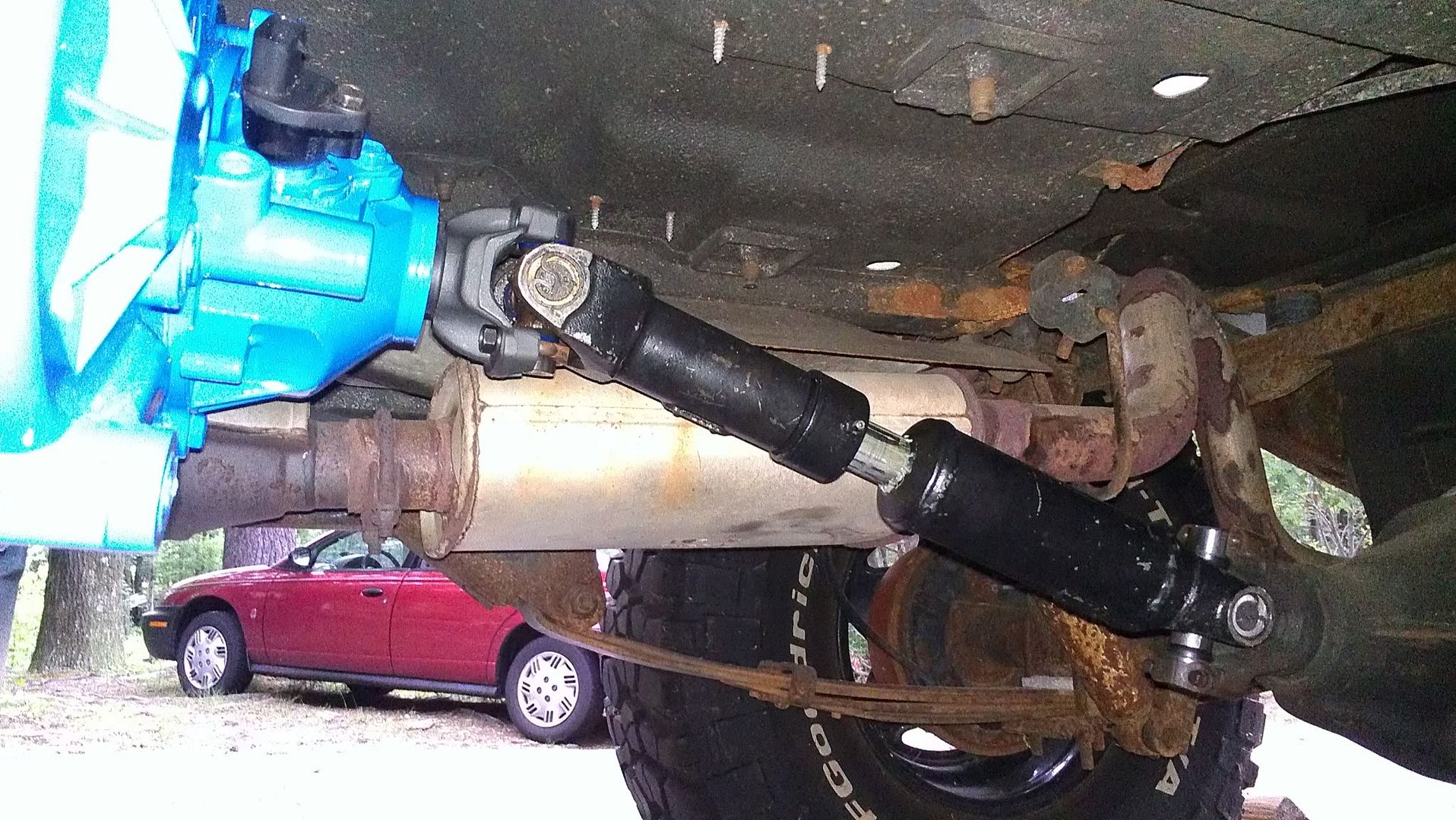

Installed the 242. "New" driveshaft. Working, calibrated speedometer. No more transfer case drop.

The driveshaft is a custom Spicer unit I got for free. Since I'm only at 2.5" of lift, I figured I could get away without having a CV style shaft. Time will tell if I have vibes (When I eventually register it).

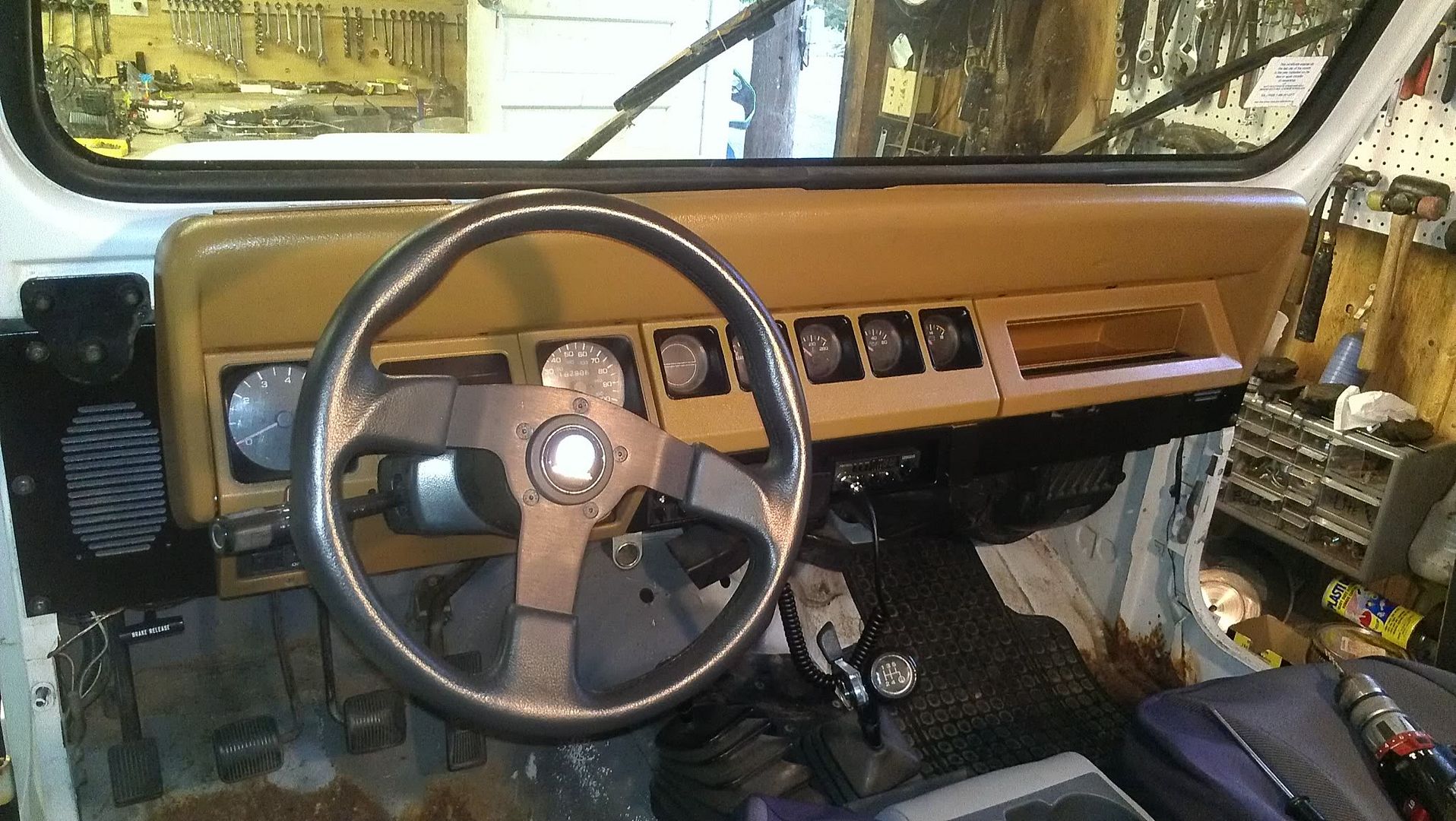

Call me crazy, but I went back to a spice dash. I've changed up a few things and
added some black accents (Painted the dash panel black to give it some contrast,
instead of the interior being saturated with spice). I really like the two-tone approach to a spice interior.

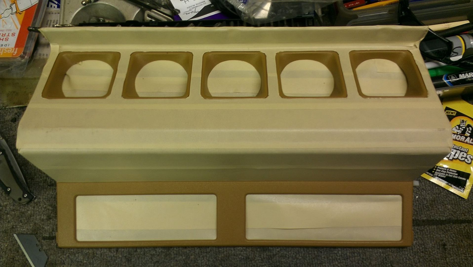

Got my new center gauge piece in today, and wasted no time painting it. Going to let it dry over night, then trim off the over spray that cured on the masking tape.

The two tone dash panel is looking sweet!
