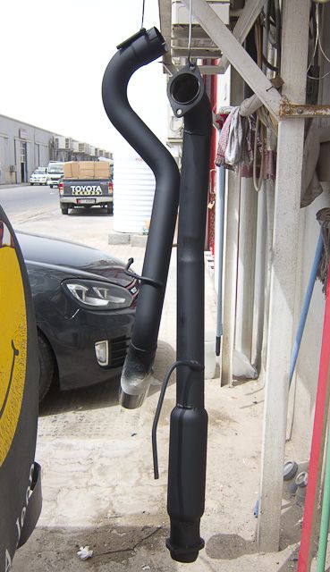

Due to a newly introduced law. I had to replace my 3" exhaust with a smaller 2.5" unit.
What you see is Magnaflow Catalyst with Dynamax Cut Back.
To be honest I love the new Quite Jeep..
