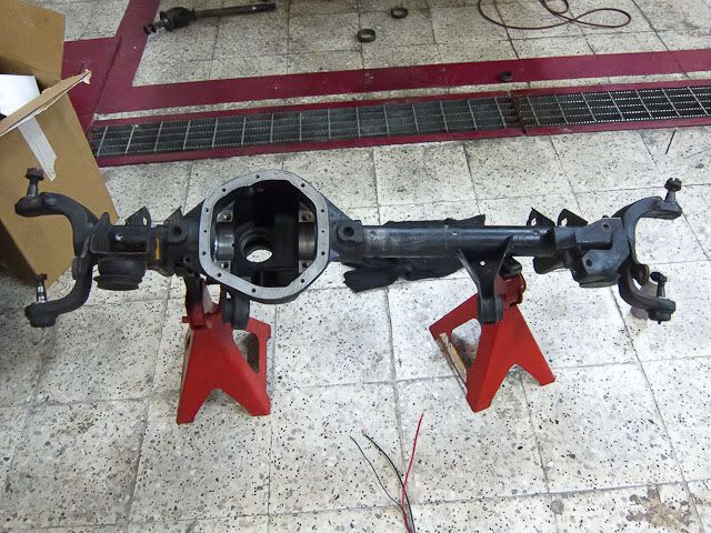

First, both Front and Rear axles were stripped to bare housing, and then cleaned using a steam pressure washer. The front axle was slightly bent and was easily fixed.
Then we installed and welded Inner sleeves
After that, both axles housings were sand blasted, painted and mounted on RB for the final assembly

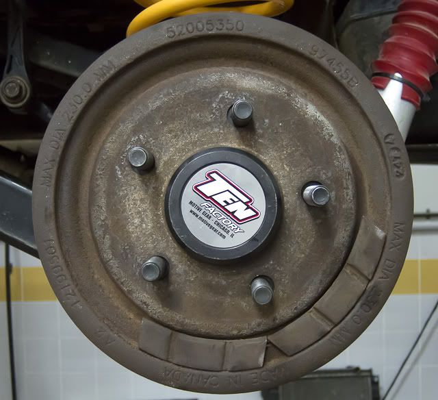

Test fitting the rear Drums
I'm going take it back off to install new Brake Shoes and machine the Inner surface of the drum.
