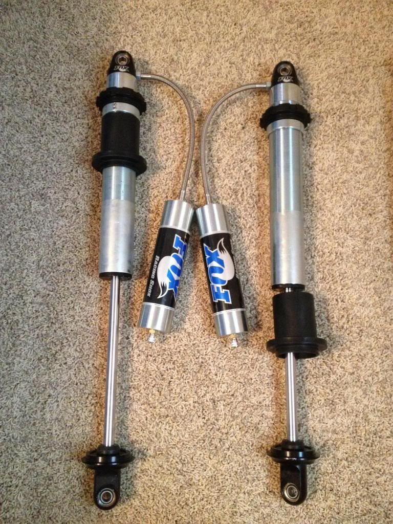

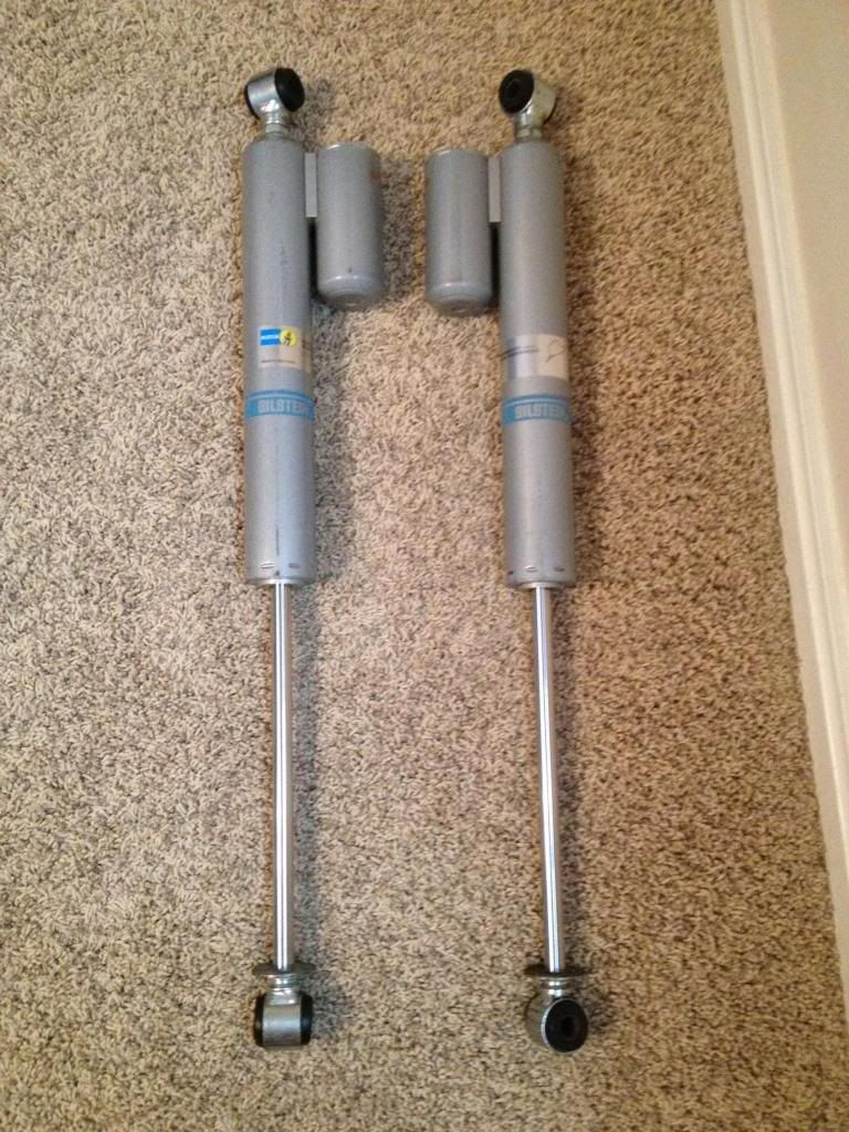

Pics of the shocks that I already have for her.
Can't wait to get started! Going to do all the work myself minus the welding.

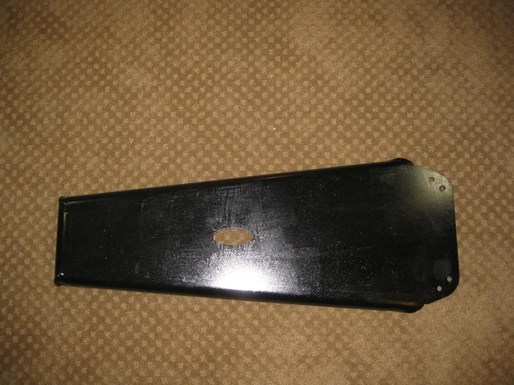

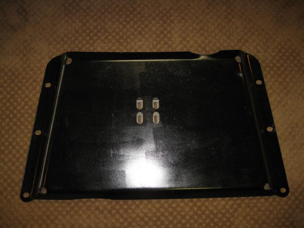

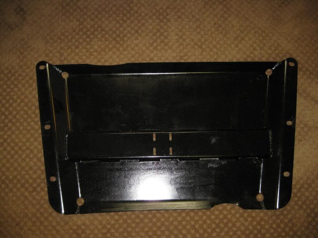

Pix of painted UCF skids. I used KBS coatings enamel and I can't say enough good things about it. Hard as nails, it's going to hold up great on the rocks! Only downside is a lot of prep time, and the painter (me) not being careful enough so it ran in 2 places. : The only warning I have when recommending to others is not to use it any place where the parts will see sunlight as the paint will fade. Now pix!

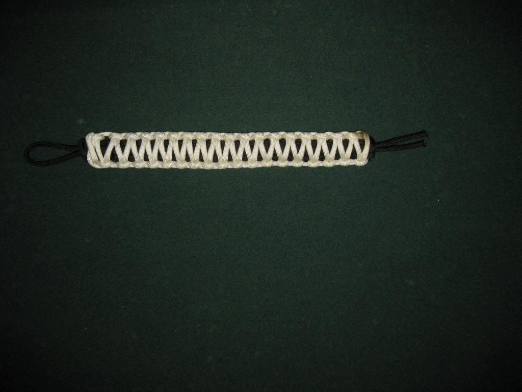

Got the Clayton kit ordered 5 minutes ago. Can't wait for it to come in! Also, a little side project that doesn't cost me any money.
Anybody guess what it's going to be?

Limiting straps for the doors.
Safety 3rd!

Grab handle in progress ? Theres a bunch of us heading to Moab in June , and that sounds like its when your getting married . What better place for a honeymoon

We have a winner! Gonna get the other half that wraps around the roll bar done soon. And then I've gotta order up some miniature D-Rings to tie it all together.
And she's already said that Moab is fine, but that she's gonna stay by the pool. So I think I'm sold, but I doubt there will be much Jeeping going on.

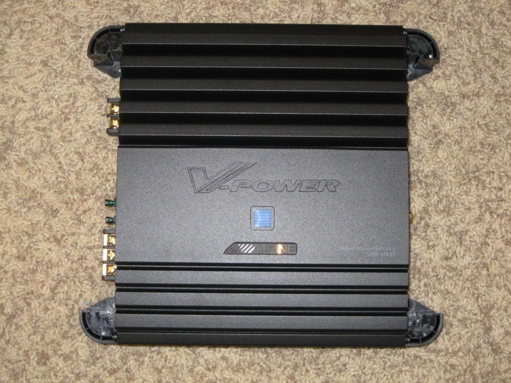

New amp to power my sub.
Now I need to go pick up a power distribution block and some new wire. The previous owner just ran everything under the carpet and not very cleanly. So I will completely redo all of that to make it look more professional. Will work on that Saturday when I get some time.

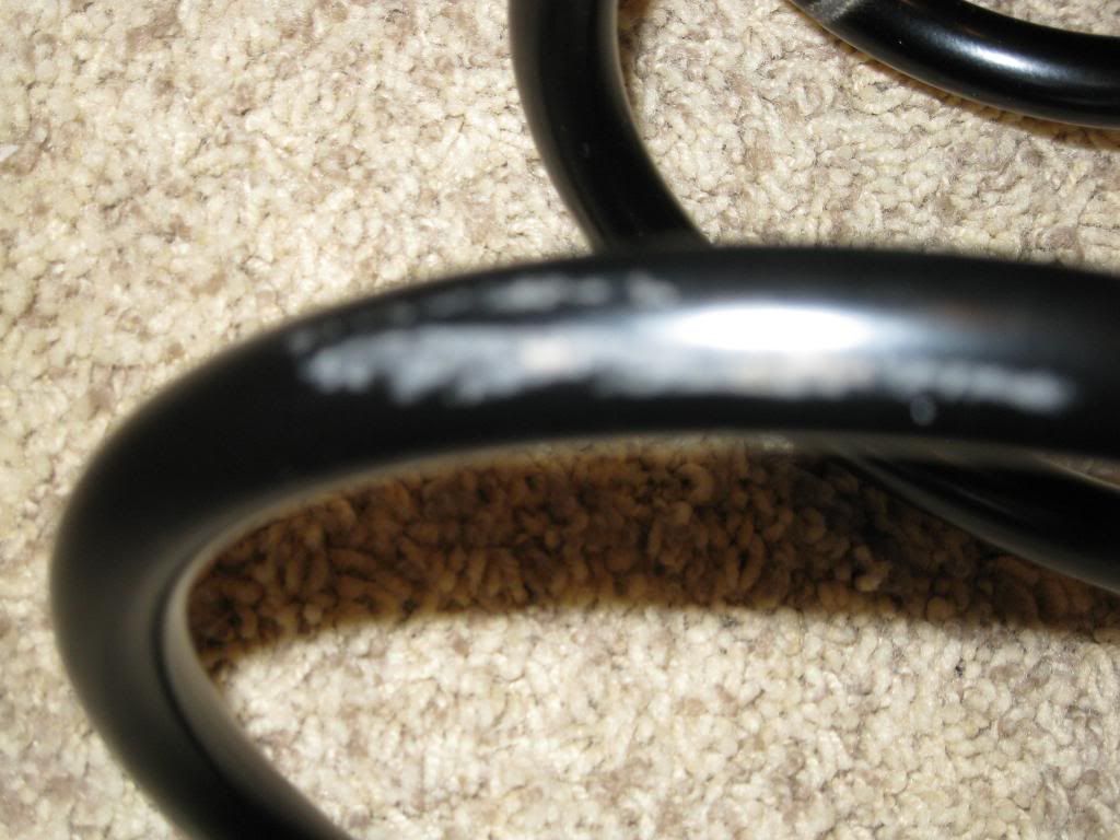

However, I did find this:

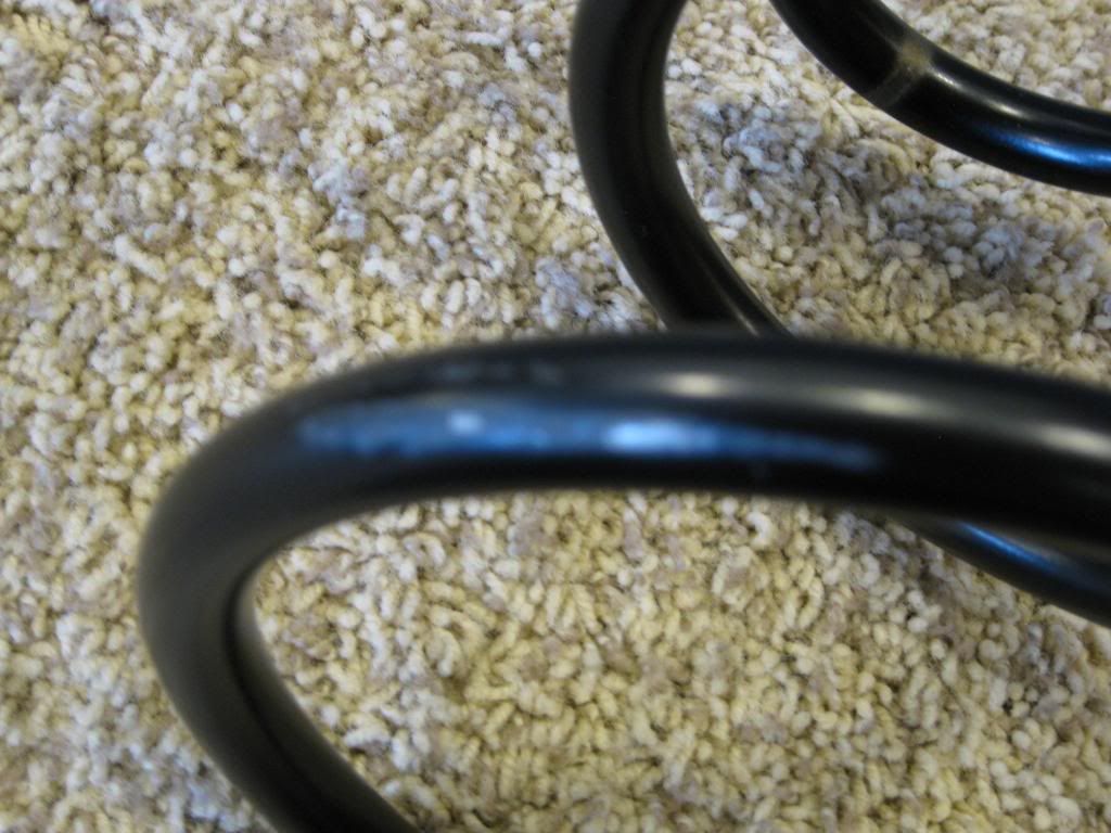

Looks like they've been kicked around a bit in the warehouse... I'm not completely ready to call and yell at anybody as I know I can just spray some black rustoleum on there and call it good. But at the same time I paid a premium for these, both because they seem to claim they are the only type of spring on the market that is "dual rate" AND because everybody tends to say Metalcloak makes some really fantastic stuff. I'll send these photos in to them and hope that they can change their quality controls just a bit to keep these kinds of scuffs from appearing on others' items.
LeeMasterGT is offline

Spray them black and wheel them . I have sprayed my springs a few times over the last three years that they have been installed . Not sure how they are going to work , but they look a lot different than my OME's. I am interested as to what you think of the springs once you wheel them .

Yeah that's what I'm going to do. No sense spending the cash to send them back over a little scratch.
I researched them a bit before I made the decision to buy. I hear only good things, and that they'll net me the 4 inches that I want. Only parts left to order are the shock towers, and coil over springs. Once I get them ordered I'll begin the teardown.

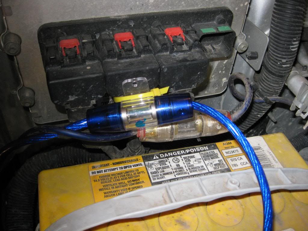

Got my new amp installed. I am really pleased with the increased sound quality. Completely worth the money spent! Still need to zip-tie a few wires in the back, and I might build a box to stick them in so they don't slide around under the back seat. We'll see how quickly that happens.
I started with an MRP-M500 Alpine amp that I connected to my Boston Acoustics 10" Sub. I have Alpine speakers under the dash using Nalin MFG. speaker adaptors, and in the roll bar pods. My goal was to re-wire the underdash speakers to run through the 4-channel amp that was already installed so that I could actually hear them when the stereo was running.

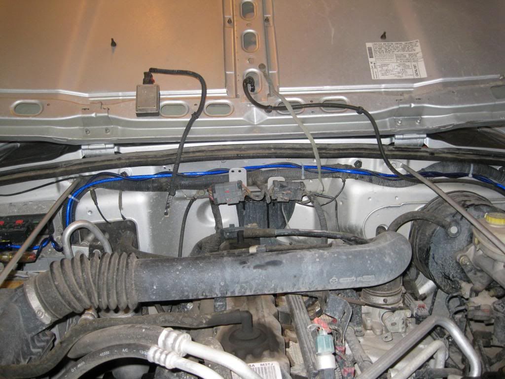

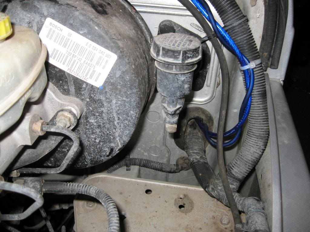

Started by running a second power wire and fuse from the battery. I considered running a power distribution block, but with the limited space in the back of the TJ and my hope to be able to move the amps and sub around a bit when needed that didn't sound like a good option.

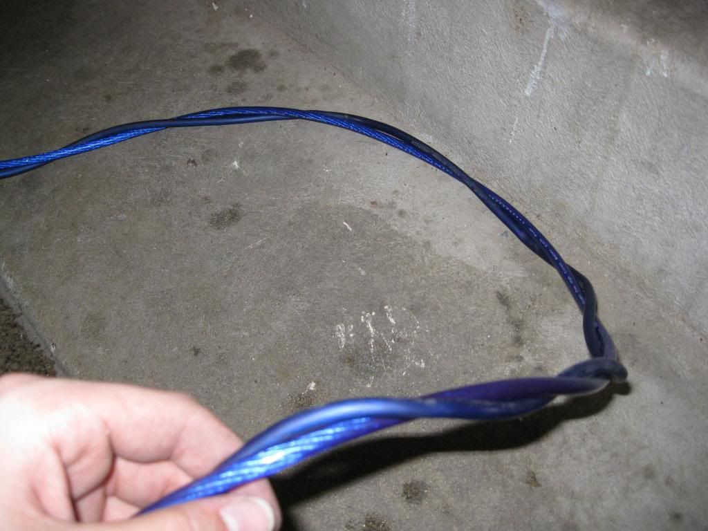

Twisted the wires to keep out any interference.
Re-ran both of the wires along the stock wiring.
Small cut in the firewall and several zip ties made the whole thing look great to me.
