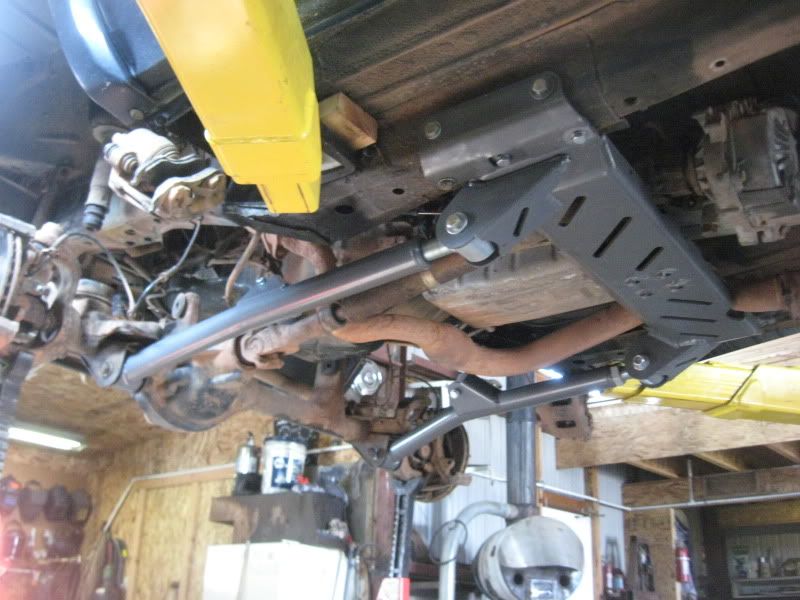

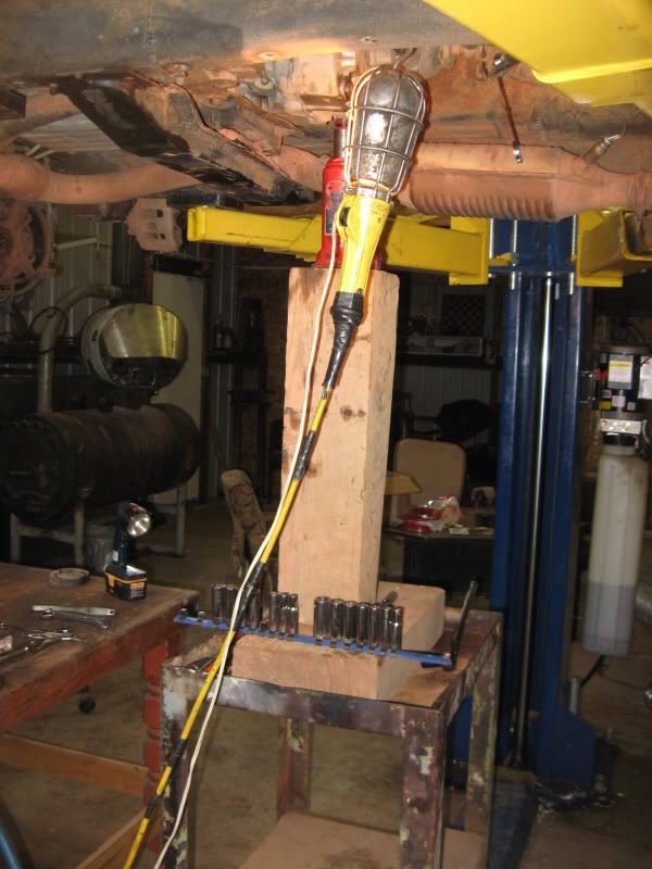

Thanks Guys! Alright on to the lift install pictures. I am hoping to do a full review on this lift which is a Rough Country 6.5" Long Arm Lift in a separate thread that will come later but here are the pictures from the install. It took me about 4 days to totally install this life but that was interspersed with hanging out and drinking beer so I am not sure of the actual time. I guess some people have had trouble with parts of this lift but it treated me pretty good. The only issue I had during install was I had to elongate the holes in the cross member that the tranny mounts to because I didn't like the fact that the drive line was not straight in the factory holes. First step was to give the jeep a good washing and remove all the caked on dirt and other stuff from the undercarriage.
Now that she was nice and clean I headed up to my buddy Marks house where we where going to do the install. Here are some pics of the jeep up on the lift ready to be torn apart and my buddy's awesome shop! He has the place all set up with a lift, welding area, tool room, parts room and many other awesome things. I can only hope I can manage to own a shop with half the stuff he has someday

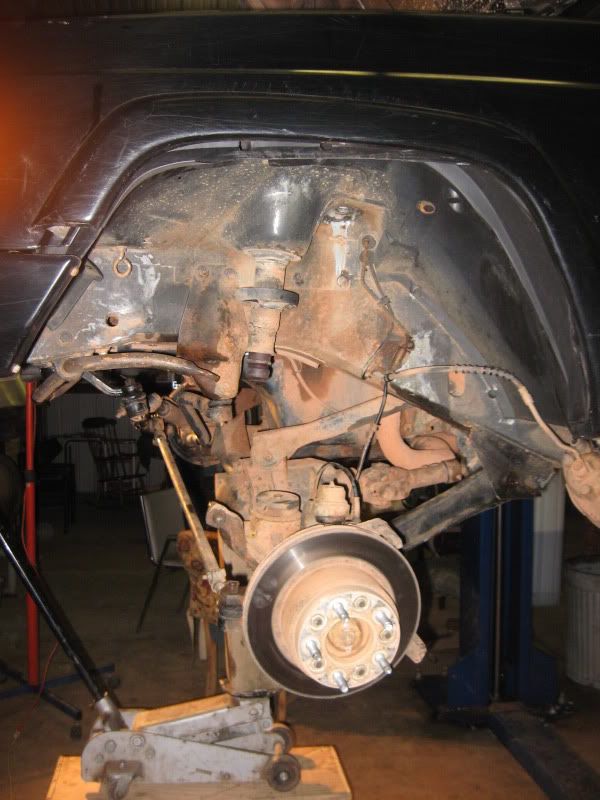

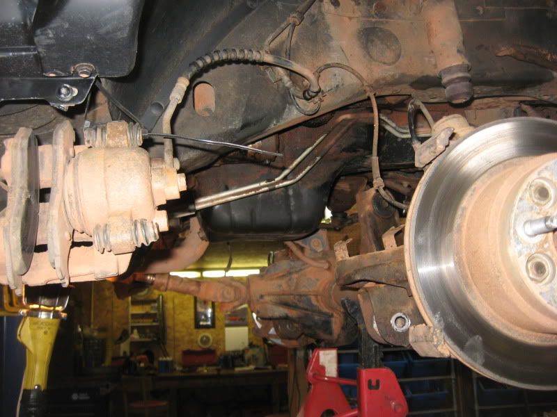

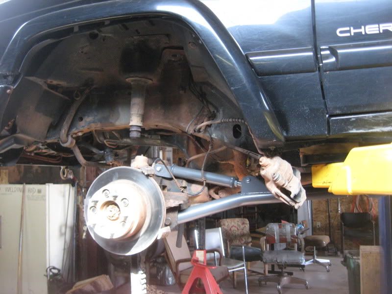

Followed by the upper and lower control arms
The front end looking pretty empty

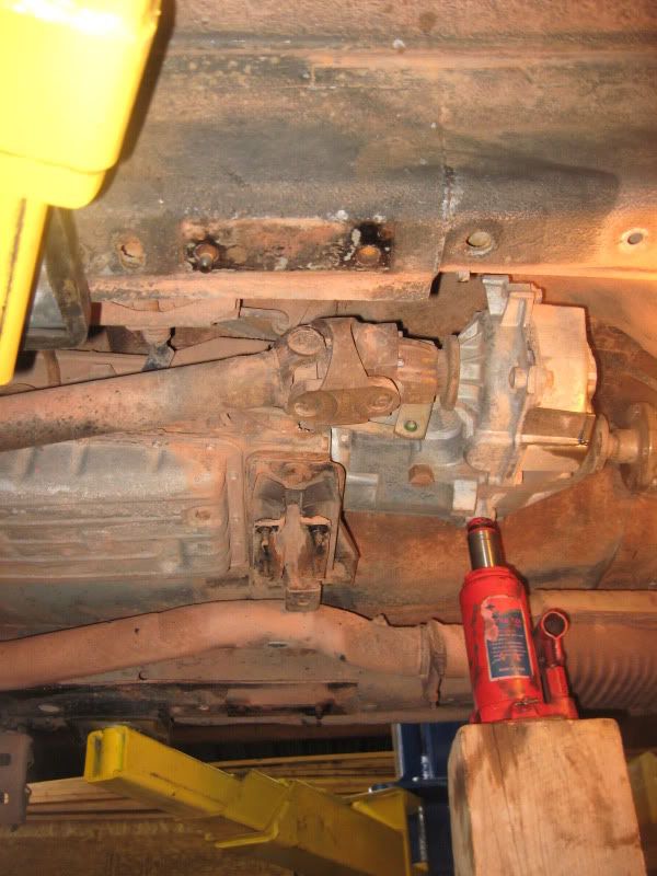

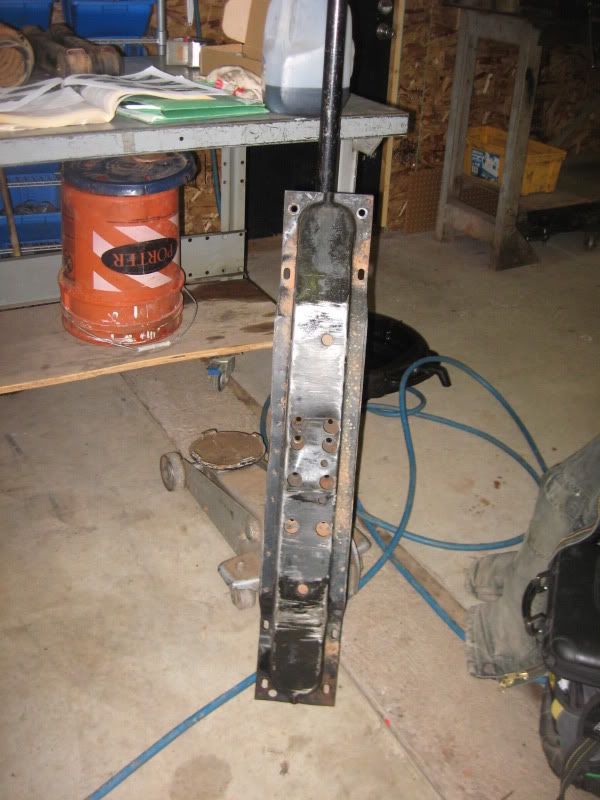

After that it was time to jack up the tranny and pull the old cross member.
The first new part to be reinstalled on the jeep was the cross member.

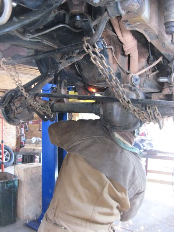

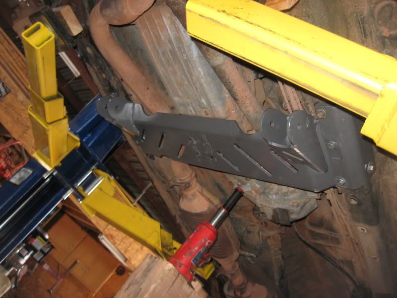

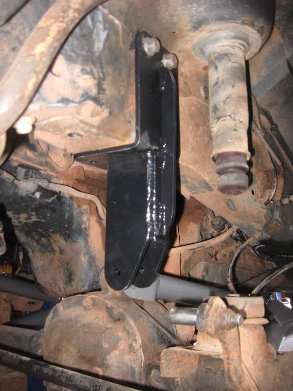

After a few trial runs and some tweaking the cross member was installed and it was time to bust out the torch and cut off the old lower control arm brackets. This was kind of tricky since they are welded to the frame pretty well. We ended up cutting off most of them but leaving the bottom plate.
Mark cutting away...

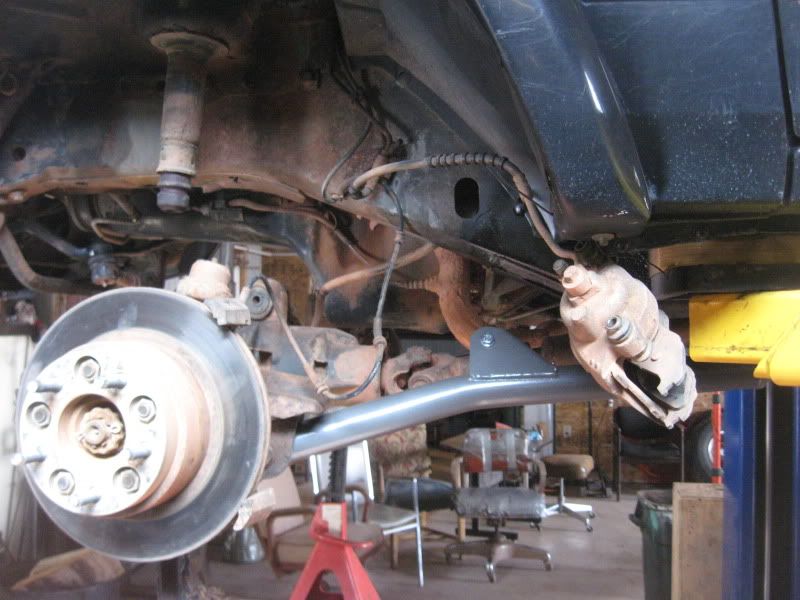

After those were removed it was time to install the new long arms!

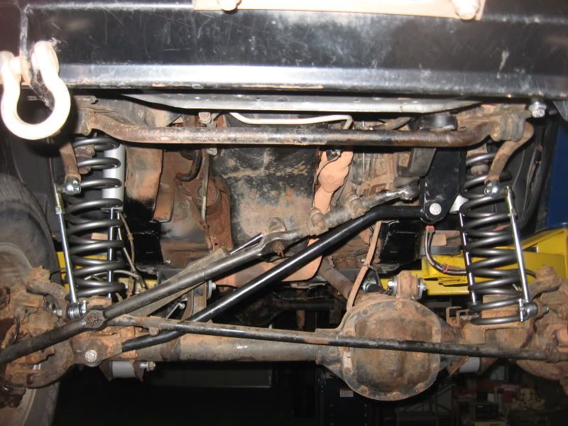

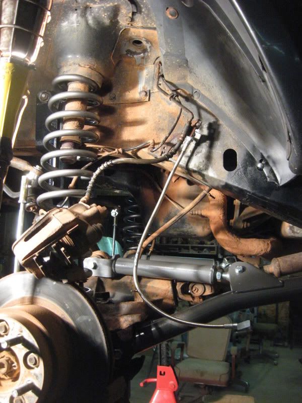

Next I did some work on the steering

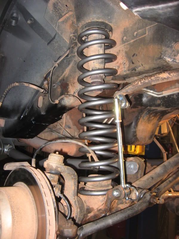

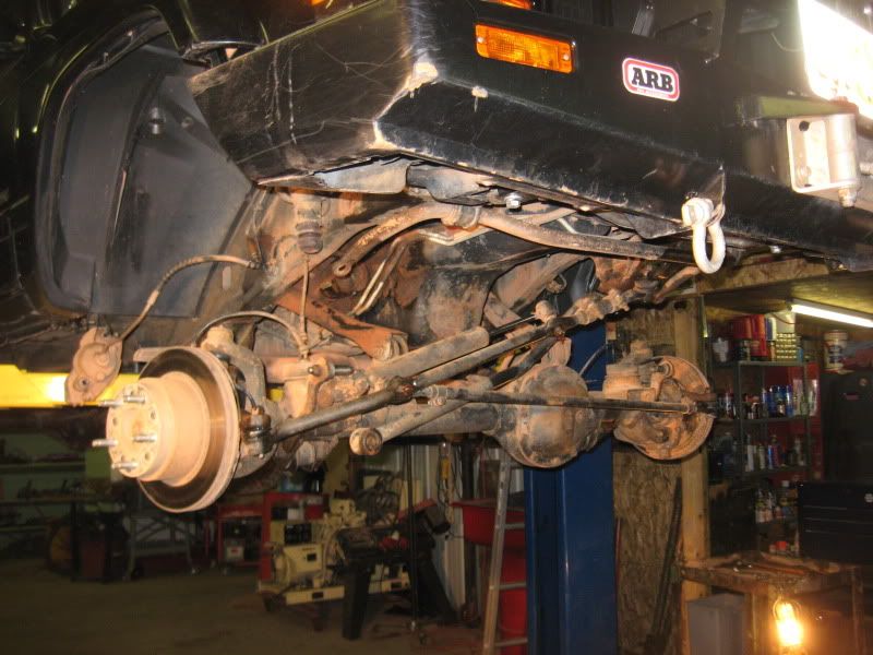

Then everything pretty much went on in the order it came off including the coils, shocks, new discos and extended brake lines.

Here are a couple pics of the front end basically done. Stayed tuned for the back!

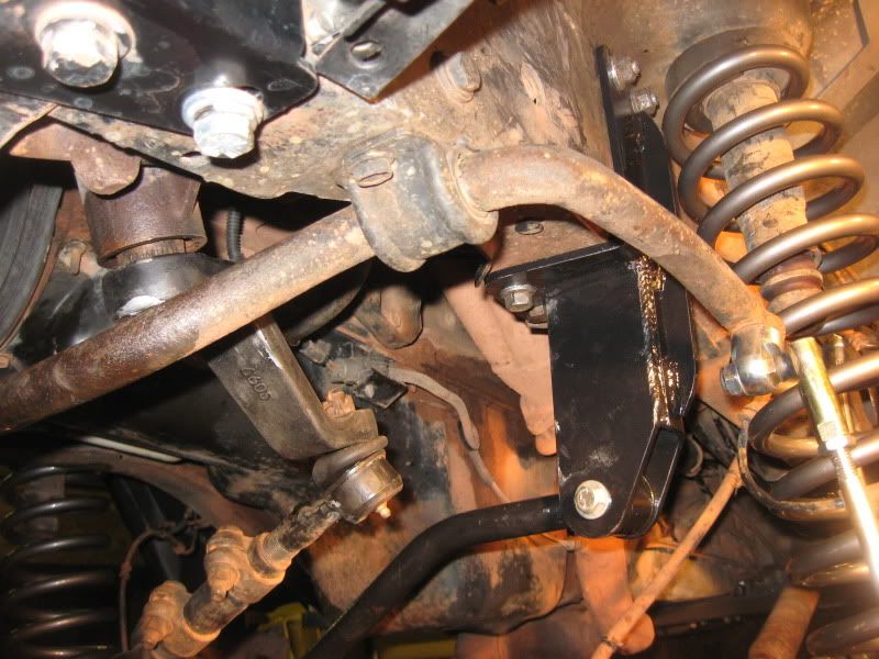

i think your swaybar links might mount on the inside of the swaybar? looks like it would straiten them up
jefro_97tj is offline
post #59 of 78 Old 01-15-2011, 02:03 PM Thread Starter
Cliff333
Location: 20 Minutes From Moab!
Posts: 394
Yeah you are right... I realized that and changed them the day after that pic was taken.
