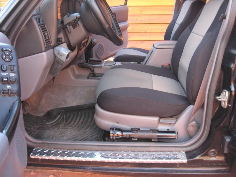

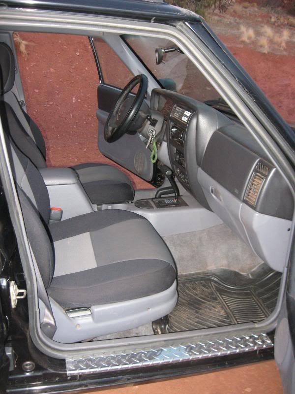

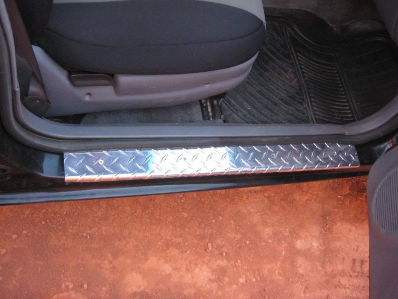

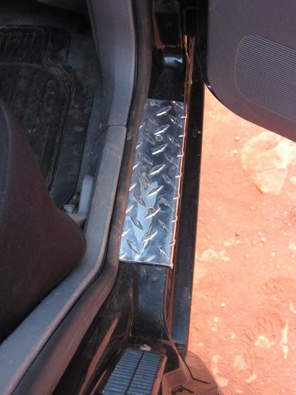

Next I picked up a set of diamond plated door thresholds made by Howler_GT from Cherokee Forum. I got so sick of trying to clean the mud out of all the little ridges in the stock ones. These screw right in place using the existing screw holes.

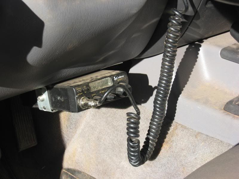

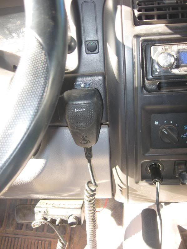

I had an old CB for a while that had broken a couple months before so I figured it was time to get a new one. I headed down to Rat Shack and picked up a Cobra CB and new magnetic antenna. On my previous CB I had just stuck it between my seat and center console but it was kinda in the way and I didn't like the cords hanging all over the place. So while I was in town I picked up a piece of metal strapping found at any hardware store. I then bent it around the CB and made a bracket for it. I put some allen bolts through the bracket into the CB and then got some longer screws and used the existing holes that hold the plastic cover on the dash to mount the bracket to. I then ran all the wires under the dash and inside the trim on the pillar and ran it out the top of the door and up to the antenna. I mounted the mic to the right of the steering wheel. There is just enough room where me feet and legs don’t hit it at all under the dash and it’s a lot neater than before.

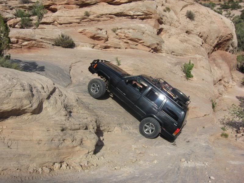

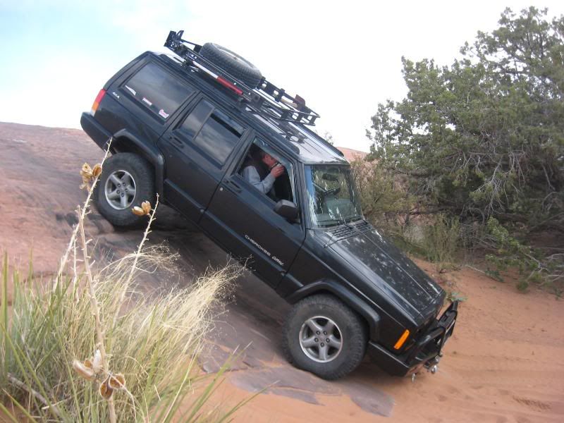

Thanks! All those pics were taken in the fall of last year or early spring of this year. Here is a bunch from this past summer from different trails around Moab.
Top of The World
Fins & Things
Poison Spider Mesa
Hells Revenge

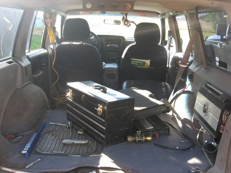

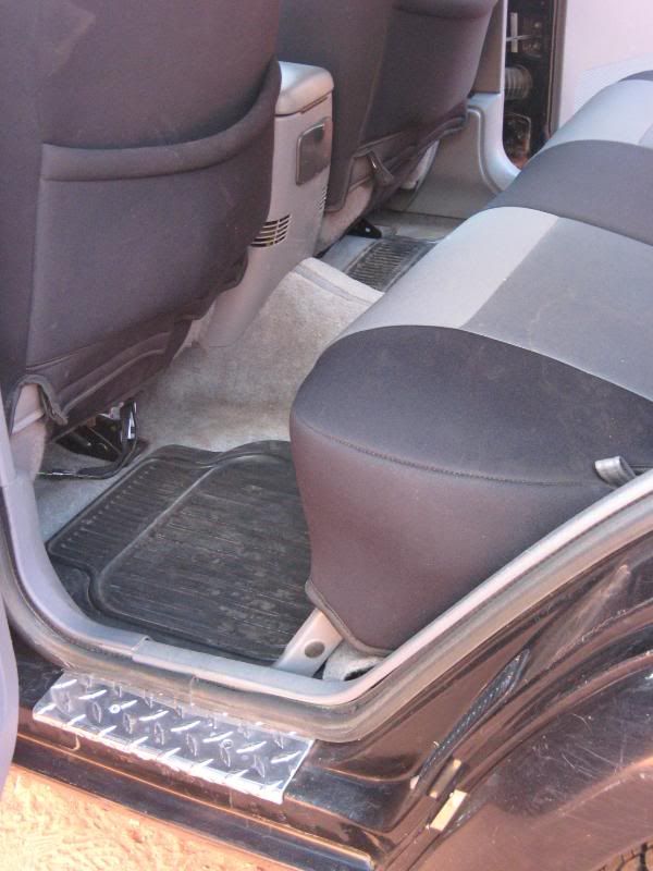

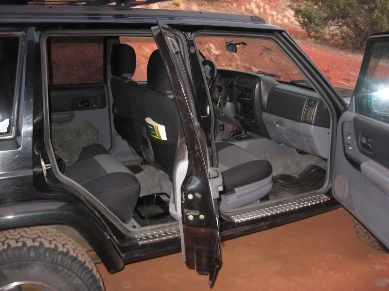

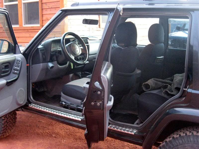

Alright here is an update on the jeep. This is a project that I have started but not gone that far on yet. A few weeks ago I took out the rear bench seat along with the driver’s side rear seat belt. I picked up half of the rear seat out of a 2000 WJ. The plan is to mount it behind the passenger seat so there can still be room for 3 people in the Cherokee. Then I am going to mount a tool box behind the driver’s seat to store all my tools and other stuff along with a couple more draws I am going to build into the back. If I get the right sized tool box and mount it high enough I believe and can make it so you open the rear door and then pull out the draws to the box. Although due to the small size of the rear door openings it may have to be mounted so the draws pull out in a different direction. I haven't picked out a box for it yet so I am not sure about the size and stuff. Here is a pic of the rear seat out. You can also see the WJ seat sitting in there which still needs to get bolted in.
