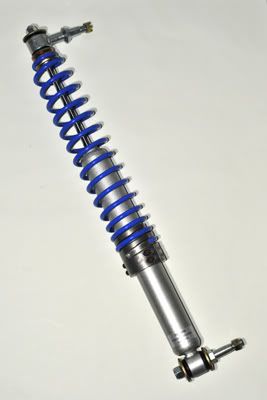

Any thoughts on something like this?
The Profender RTC steering damper acts as a stabilizer and helps to return your steering wheel to the center.
The coil-over design helps keep the steering centered; no matter the road surface or terrain. When compressed, the spring pushes back to the neutral position. When extended, the spring pulls back to the neutral position.
REDLYNER is offline   Reply With Quote

Waste of money.

Ever had your tire spin your wheel back at you? Want to increase the power of that?

agreed not the best idea

it does look cool tho

um, wouldn't hydro assist be a better idea? or is that illegal for your class?

woulden't there be increased resistance at the steering wheel when trying to turn?

Agreed, it looks cool, but why add more strain to the steering system than 37's already provide

No, just an increase on the amount of work the steering box would have to do to do the same job as before.

I've been pondering this since my last post, and I can't come up with a reason why you would want a faster "return to center" at the expense of losing turning force. Desert racing is the ONLY thing I can think of, but they run some variation of hydro don't they...
