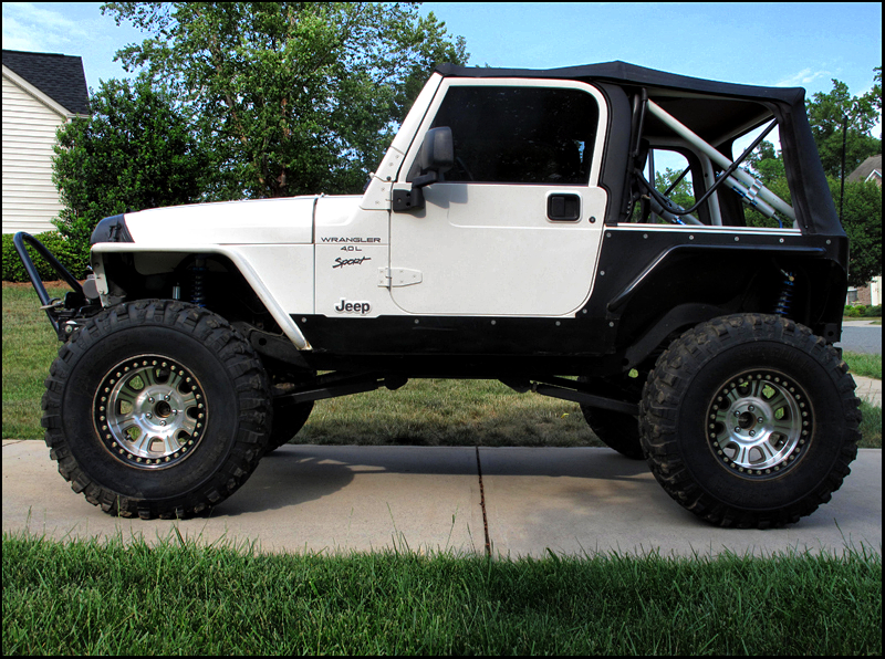

I don't think I posted the final picture of the steering- Ironman4x4 HD track bar with Carolina Truggies custom mount. It moved the bar down 5" which should get me all of my down travel back:
The jeep is basically complete at this stage. I can drive it to South Park mall today and then go race it on Saturday without any changes. Hard to be unhappy with that.
If I had to get extremely particular, one last minor change I may have corrected is the driver rear coilover tab. Three of the four coilovers have 2" of lowering adjustability, but the driver rear is completely maxed out (unthreaded), so I can't lower the rig at all. The current height is perfect for going fast, but for daily driving and rock crawling, I would like to be a little lower, so that tab will have to be re-worked. Hopefully that is fairly simple.
Current ride height:
