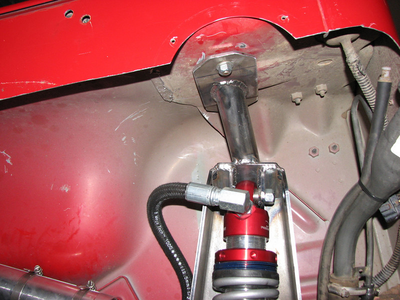

Anyone have any objections to the Poly Performance rear coilover kit? It looks like it would fit pretty close to the frame cuts I have already made for the Clayton kit.
I'm currently at 22" eye to eye on my rear shock, the Fox 12" coilover is roughly 19" closed, 31" open. So this kit would need to mount at least 2" higher than the Clayton bracket. No way of knowing until it arrives....
It's probably what I'll go with eventually. I like the strength or the mount but can't you just bend some tube and box in the gap?

I think it looks pretty good. I should be ordering a set of CO's for the front and was thinking about the poly axle brackets that weld to the lower shock mount. My Hoops from TNT should be all set. I'm liking the idea of Profender but still undecided.

I would go with them also except the c/o's i got for the back already are 2.5".
I'll have to do custom stuff now.

You just don't trust my rock donkey opinion anymore do ya? The polypro kit is nice.
Originally Posted by E_ROCK View Post
A C/O would eat that up shock mount up anyway. You can buy a half back kit or go with the poly pro towers. Great job Jay!
Like you said....Half back kit (or custom) or Genright/Poly Pro coilover towers.
I wanted to do rear C/Os and rear stretch on mine. I ran out of money, but I still put in the PolyPro tower and made sure a C/O will fit. The hardest part is deciding where you want everything to line up and making sure you trim enough out of the frame to clear the tire and not rub the C/O on the mount. It just takes a lot of testing fitting and trimming. Gusset the **** out of everything.
You can even plan your "C" pillar cage mount to line up with the shock mount.
It fits a 14" just fine.
If you plan it just right, a "C" pillar frame tie-in can go to the top of the mount.

Your towers look much taller than the Poly pic. Taller would REALLY help me out. I love that last picture and will most likely copy it.

From Poly's website:
Standard bracket measures 10.5" from bottom of bracket to center of bolt hole
Extended bracket measures 17" from bottom of bracket to center of bolt hole
The extended bracket set is $300 vs $250 for the shorter ones.
