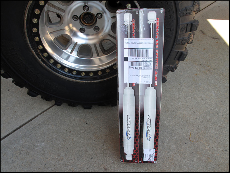

Greg Slade (manager at 4Wheel Parts in Raleigh) has been a huge help yet again. He's sending a pair of Pro Comp 3000 series shocks to me for a hell of a deal. Their measurements should give me 4" of up travel in the rear with about 6" of down. This is just for this weekend, but considering my current shock bodies are so long, these should be a great little band aide until I can get my Profender Resi's on.

Of course I'll be adding more weight with the cage additions, spare tire, tools, etc for bigger races, but for this weekend it should be as nimble as it will get. Also, my DJ helmet and Pro Comp bandaide shocks arrived:

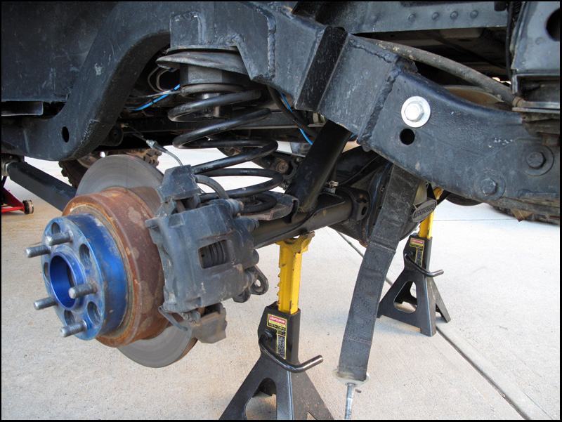

Picked up some Spidertrax spacers today (thanks Schwabe!)
Decided since I was adding spacers, I might as well rotate the tires (and rotate in the spare- it's been 500 miles). I know I should have added my 2 extra jack stands. :

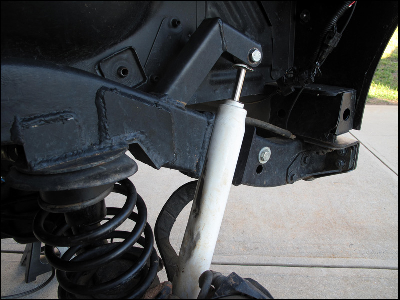

Next up was taking out the old shocks:
All out:
Good comparison of the old busted BDS 12" vs the new (temporary) Pro Comp 10". I had to go shorter since it was lowered:
Installed- twice as much shock shaft showing now. No bottoming out on pebbles!:
