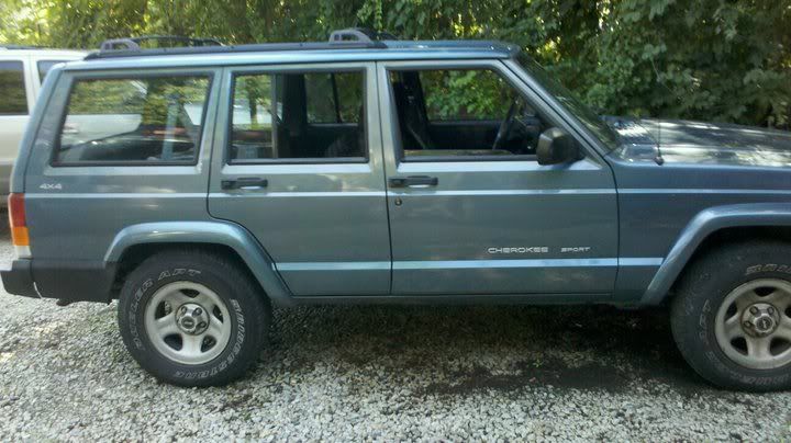

When I first got it:

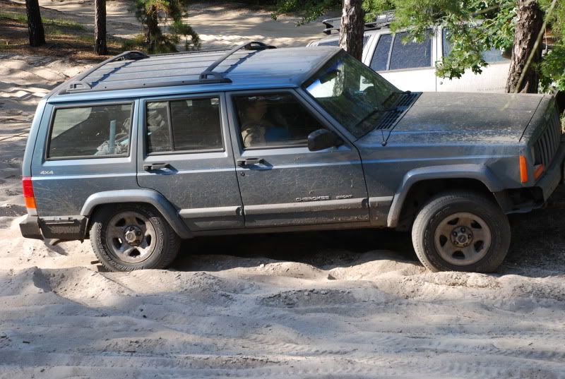

First time flexing with sagging leafs:

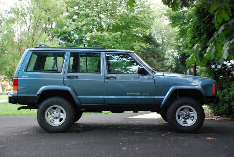

Current Status:

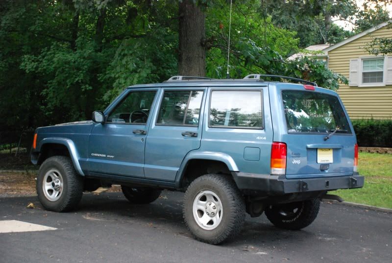

This week I removed the trim and pin striping, then today my dad helped me with installing my JCR Lower 1/4 Panel Armor. I bedlined them this week as well as fixed a few rust spots on my rear bumper and my lower 1/4 panels.
Outcome:
Bought a magnetic roof mounted CB antenna and ran the wire for it so my CB is now working. I just need to tune the CB to make sure it works right. Tried installing my Teraflex Steering Stabilizer and didn't work out so well, so I'll have to wait til I do my lift to install it.

So after almost a week of working on my XJ, my dad and I finally finished installing my Rusty 3.5" lift, teraflex steering stabilizer, and tires.

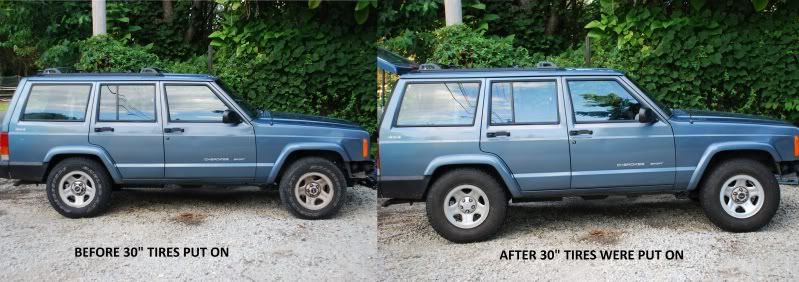

My XJ going from stock tires to 30" BFGs getting ready to go over my folks:
When the front end finally got finished:
When my lift was finally installed:
Now I just need to extend the brake lines, put pads & rotors on, and get my alignment done (appointment with STS tomorrow) and i'll be ready to wheel. Thanks to my 2 friends shadyvito and onabudg3t for their help as well as my dads, if not for them my XJ would still be in pieces. hopefully I can get my brakes done by Saturday so I can wheel with some friends come Sunday and test out my flex
