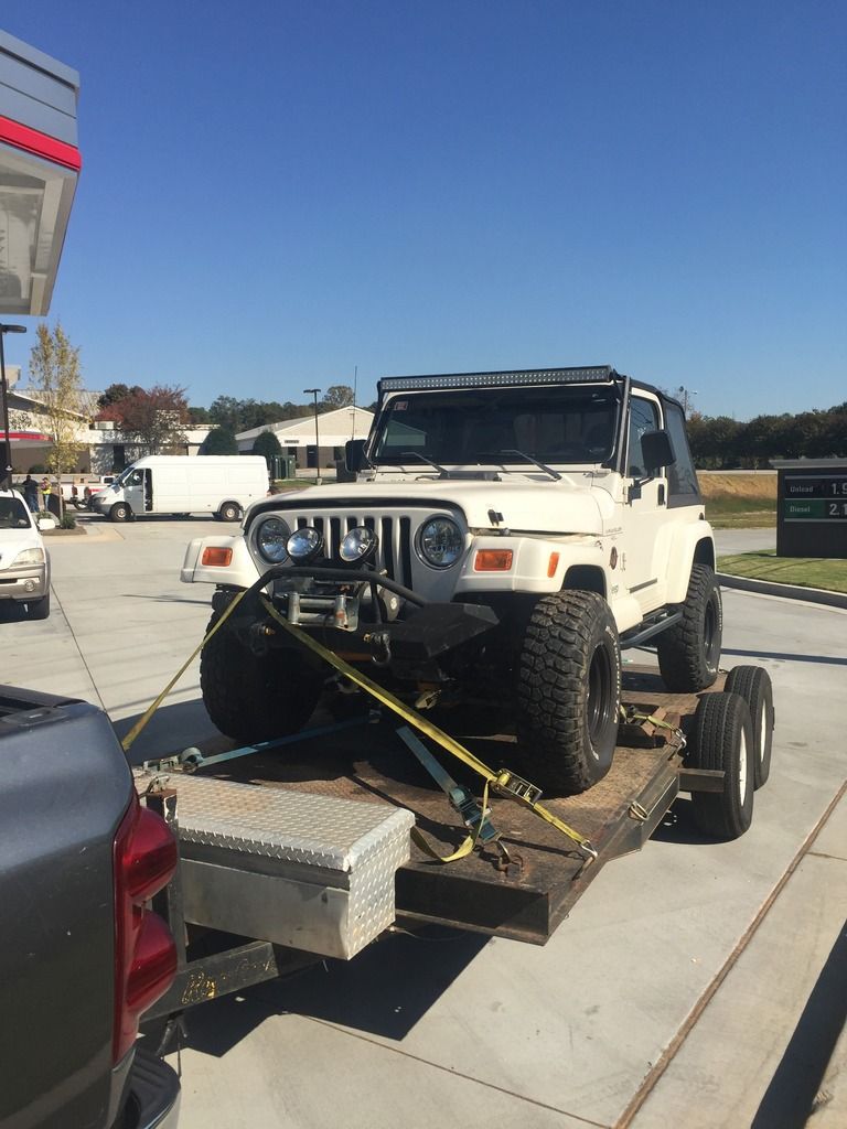

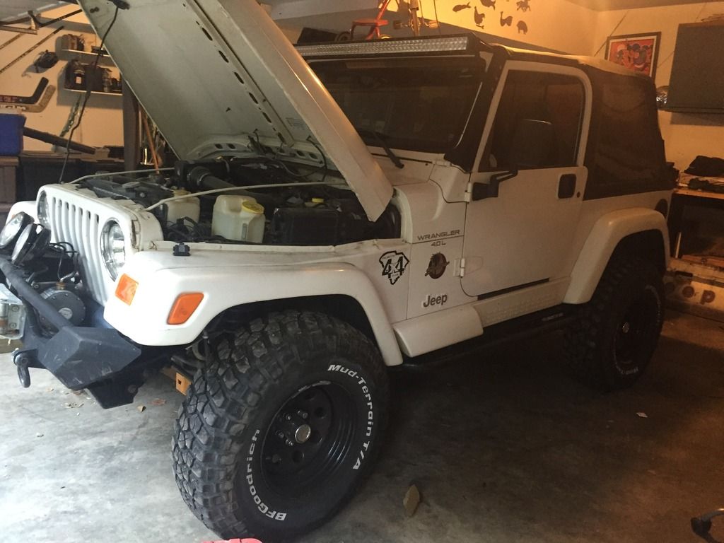

Finally part of the TJ crew..... maybe. Picked up this 1998 Wrangler Friday. It was in a minor front end collision with another car but do to insurance issues the other party was paid off and the Jeep was scooped up and dropped off at the owners house where is sat for almost a year. Therefore the title is clean. The frame is also straight, the car must have went up under the Jeep because the passenger lower was ripped off the axle and all other suspension links were bent. There are a few other issues that need to be addressed but from the looks of it nothing too serious. Not really sure what my plans are for it at the moment but for right now I plan to just get it fixed as it is to start and go from there.

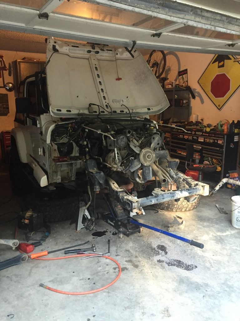

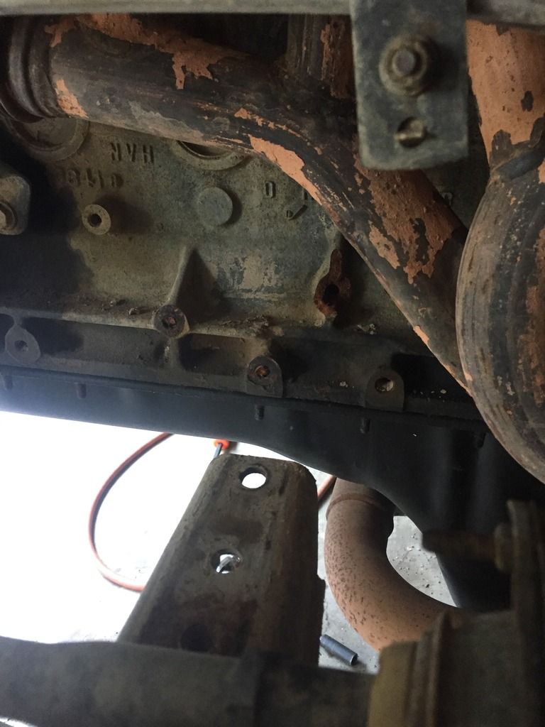

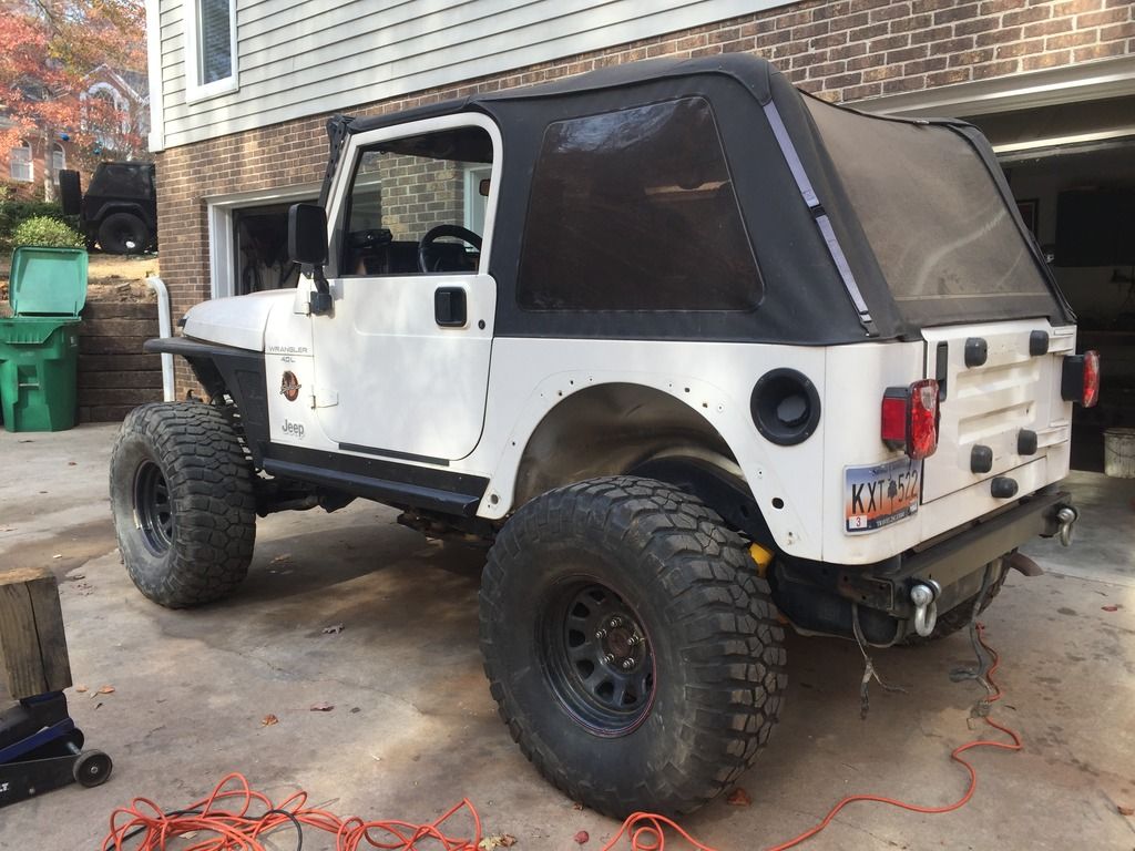

Okay so I know it's been a few weeks with no updates.. Been super busy with either this Jeep, school or work so finally have some down time so time to catch everyone up. Got most of the Jeep fixed and it driving around the neighborhood. First thing I took care of was the drive train. Both motor mounts were destroyed along with the trans mount and tcase. Got a new case (4cyl) and swapped the inputs, new motor mounts and trans mount and got it all placed back where it's suppose to be. Noticed the header was cracked as well so got that fixed. After that it was the body. Having a body lift in the wreck the body shifted forward. When I bought the Jeep I figured the bolts were just bent or broke. I was wrong, the nuts in the tub were what was bent. Cut some holes, drilled out the weldnuts and put in new nuts and bolts. So that was taken care of. Picked up some tube fenders to replace the wrinkled fenders and got them on. The 30 turned out to be still straight surprisingly so ordered some new lowers and some RE adjustable control arms from a buddy and got the axle back in. Also sold off a few other things that weren't to my liking like the rear bumper, rocker guards and 33s. Bought some 35s from a friend going to 37s and picking up some new rock sliders and a rear bumper tomorrow to finish off some of it.. once I get some front shocks and the interior back together she should be ready to roll!

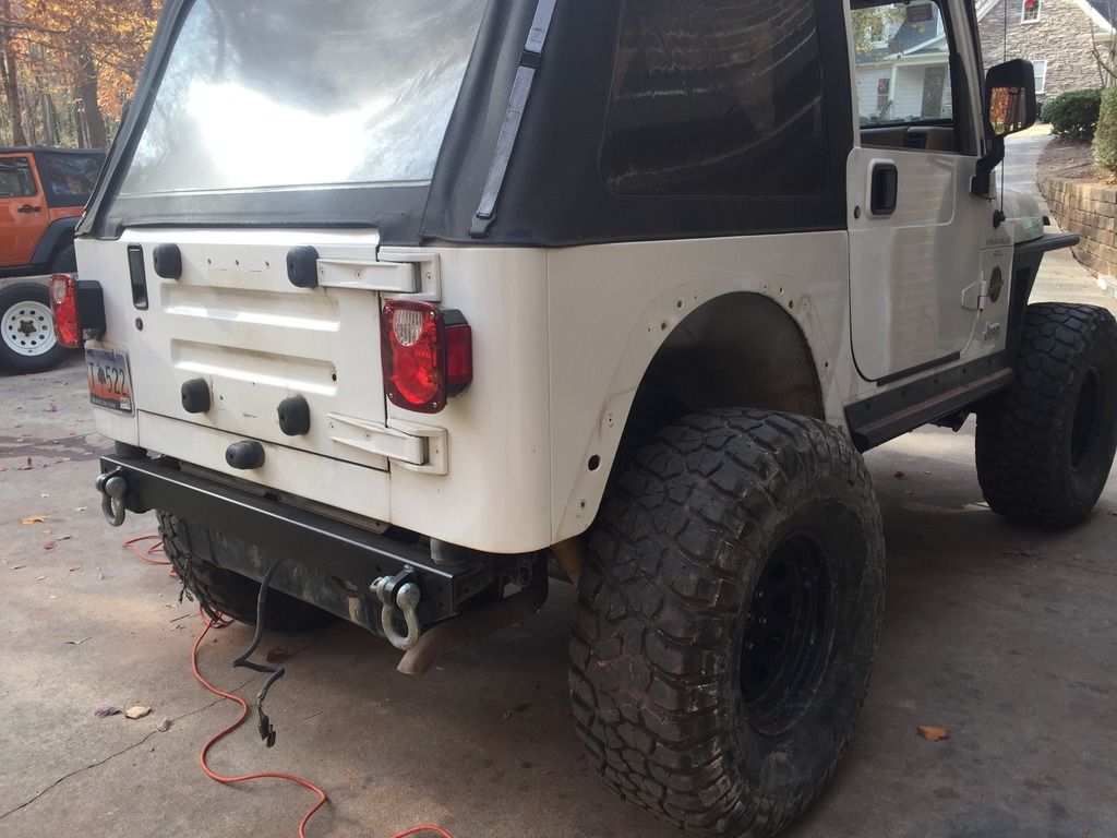

Picked up my rear bumper and rocker guards yesterday. Not sure how how I feel about the rear bumper and the body lift. So that might end up taking that out but not real sure at the moment.

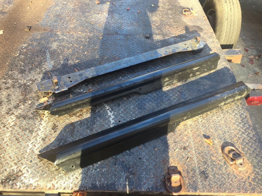

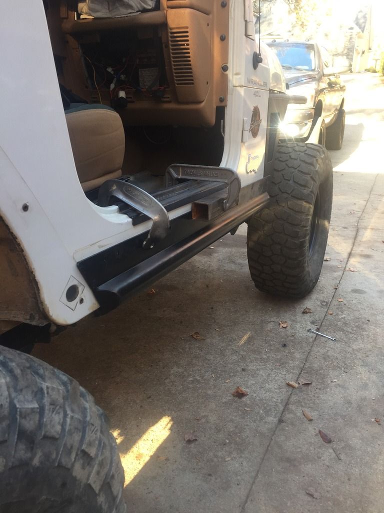

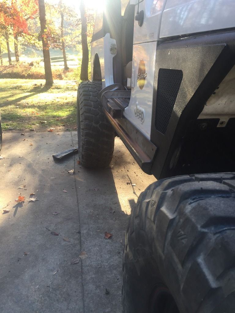

Got the new rock sliders on and the rear bumper on this past weekend. Still need a few more bolts in both to complete. Should be picking up some front shocks this weekend. I'm wanting to get some rear corner armor to clean up the rear but not sure if that is going to happen yet or not. Also getting all the wiring and odds and ends tied up.
