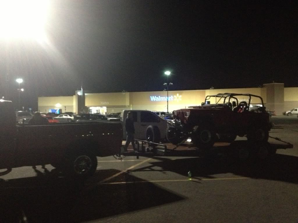

Well the TJ build is on hold again. The money I had set aside for the TJ went elsewhere. 95yj 302 3550 8.8 4.10s and arbs 35s
It's not a wheeling trip for us unless we go to Walmart

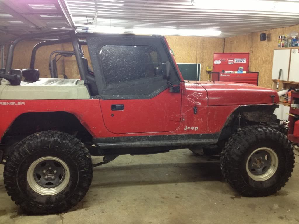

What did ya pay for that cool lil yj?
Seems like a nice catch

4500, which is the same price as most clean YJs in my area with a 4 Or 6 cyl stock.
