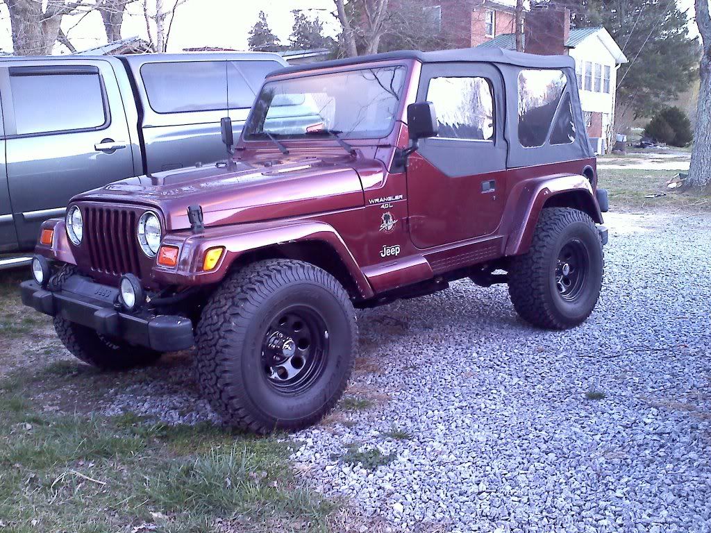

So here she is with the 33's and stock suspension....
[IMG][/IMG]
Yes it ran close to scrubbing...
under normal daily driving it never would scrub enough to notice, even hitting road to parking lot dips.

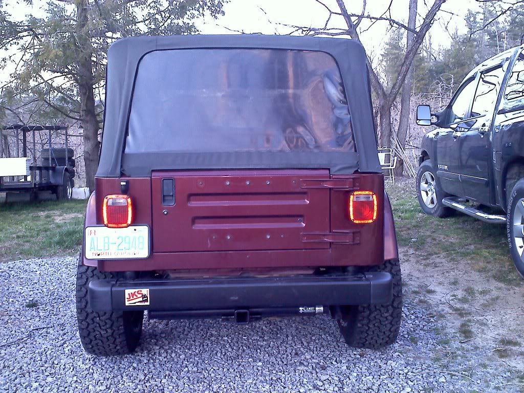

I got the JKS 1.25" BL and a 1" MML...the install is super easy. The only question I had was the directions said..."If you are doing a motor mount lift in conjunction with the body lift, do the body lift first, and skip steps 1,2,5 and 6"...which are the loosen fan shroud, loosen this line, etc. I kept a close eye on the fan anyway, and all the other lines and such. When the last puck was going in, the front one, my fan was pressed rather tightly against the fan shroud. Needless to say I expedited the removal of the old motor mounts to ease up the pressure.
Otherwise the only snag installing the MML was that the driver's side bolt head is facing the front, which you can not get out because it was hitting the A/C pump (iirc), so you have to loosen the 3 motor side bolts until its loose enough to slide past it, then when you put it back in, go from back to front.
Both were done with my bro's help...good to have a set of hands above the engine while you are below it.
[IMG][/IMG]
[IMG][/IMG]
[IMG][/IMG]
You can see it best from the back, not that you really want to, but i figure that will not really be seen after the rear bumper is on.
