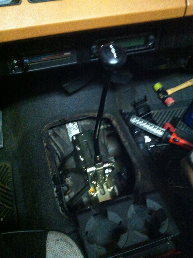

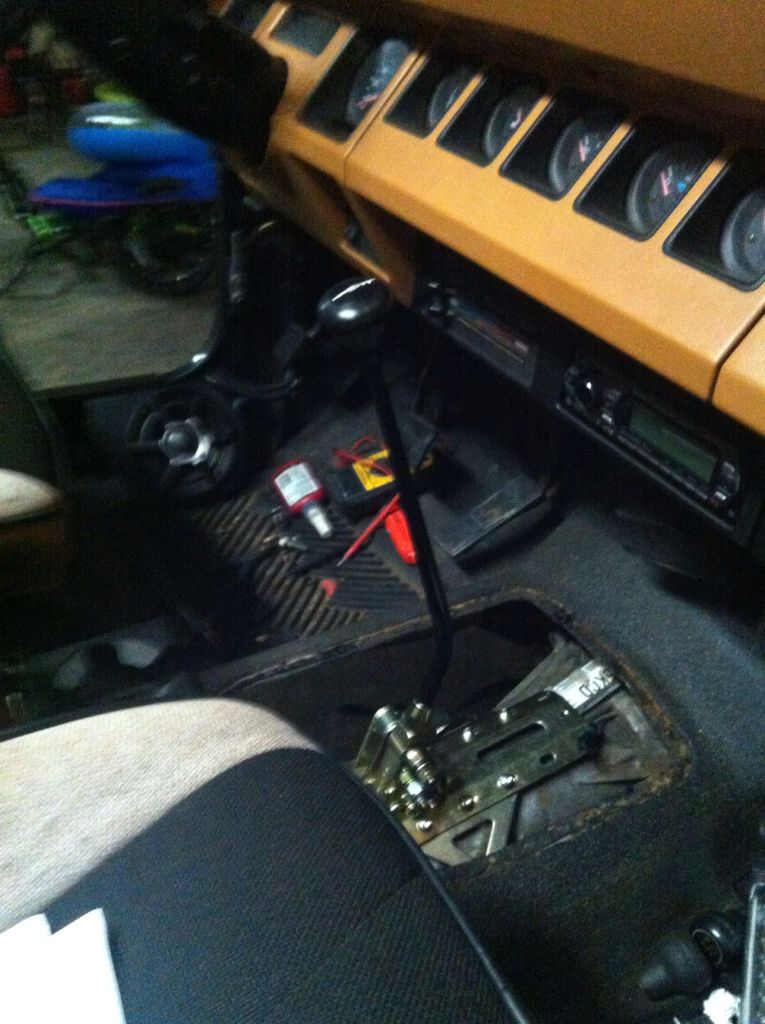

Here are some pics of the Lokar midnight series 16" shifter.
From the driver seat:
angle from passanger side:

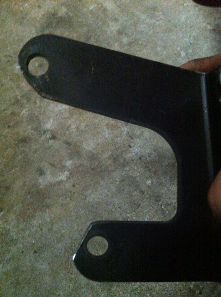

After some cutting and cussing I got the Novak tcase shifter installed. Still lack the shifter stick. I need to get the trans mount and skid plate in place to make sure everything lines up well. With the AA trans to tcase adapter you will need to slightly modify the Novak shifter bracket.
No big deal.
My trans mount should be here on the 4th. after that I can finalize the trans shifter and tcase shifter. Wiring should be close behind. I still need to order my rad but I need to raise some funds first.
