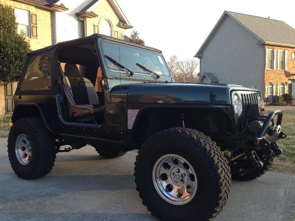

Picked up a new Bestop Trektop NX for a Tj and put it on last night. The brown Santa has some toys for the Heap that should be here on Thursday.
Until then the boys and I have been enjoying the nice weather.
