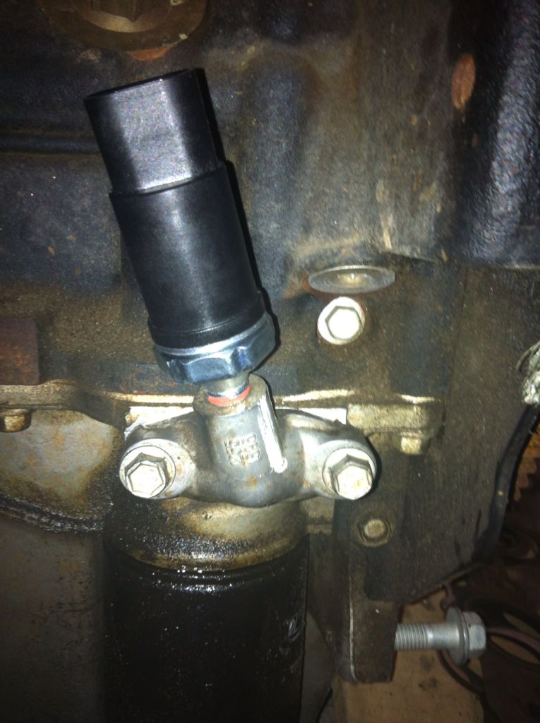

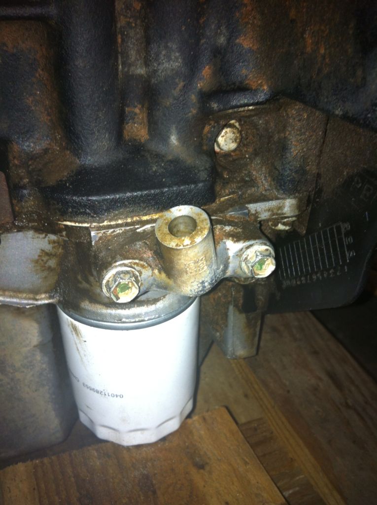

I was able to get the stock Jeep oil pressue sender mounted to the LS motor. Easy really. Drilled and tapped this:
Drilled to 21/64", tapped to 1/8 npt.
Still working on the temp sender, needs to be adapted from 1/8npt to 12m-1.5. Thats really it untill parts start showing up or my wifes van gets out of the shop.
