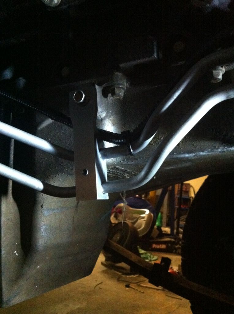

I used a conversion radiator For an automatic I bought on EBay. It is made by Superior Radiator in Michigan. Just call them and they will get you squared away.
tel 58620463208722
But make sure that it has the correct size inlets and outlets. Upper is 1.25 and lower is 1.5.
I ended up using a flexible rad hose that was 15.25" long x 1.5. That I cut a little of off each end to make work. Ill dig up the hose part number and post it.
OK thats whats throwing me off. Mine is a stock gm waterpump and has 1.5 upper and 1.75 lower measurements. 1.25 seems small like a stock YJ hose. Maybe mine has a different waterpump. ?? Who knows. One other question is did you radiator have tabs on it to mount your stock fan shroud to?
OK Im not ashamed to admit when Im wrong. LOL I measured my waterpump in the dark. You are correct on the 1.5 and 1.25 measurements. Superior radiator does make a radiator with those size outlets both on the same side for 300.00 and 450.00 with electric fan setup.
