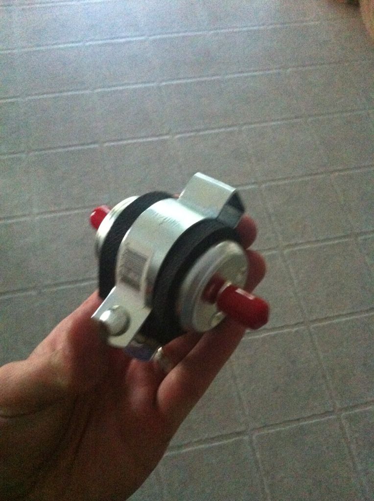

Also figured out what fuel filter I am running. I needed somthing small that is easly found found at a parts store and has a 3/8 inlet and 3/8 outlet. I found a Fram G15 filter and a mount made from a piece of foam padding and a conduit holder
I just need to flare the hard lines and bolt this bad boy in. My AN stuff showed up today so I will be running that tonight.
