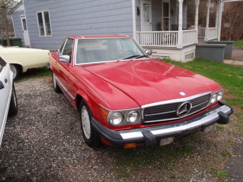

My wife tolerated my YJ, and my CJ2A, so this time it was her turn. That's how you make it all work
Wife's new toy
87 560SL
