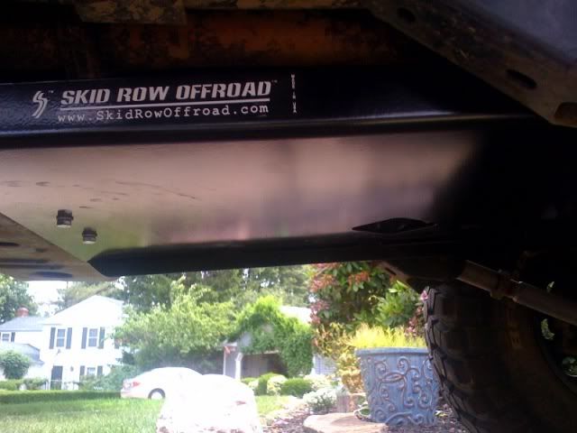

Well after banging up my driveshaft last weekend and seeing how close I was to losing an oil pan...I installed a Skid Row engine skid

Looks good. I think I can make one of those with the steel I have lying around. Only thing is, it's another thing to collect salt in the winter.

It is a pretty simple design...If you wanted to I could let you take some measurements of everything sometime so you could make your own if you wanted. And yea it'll be a salt trap oh well

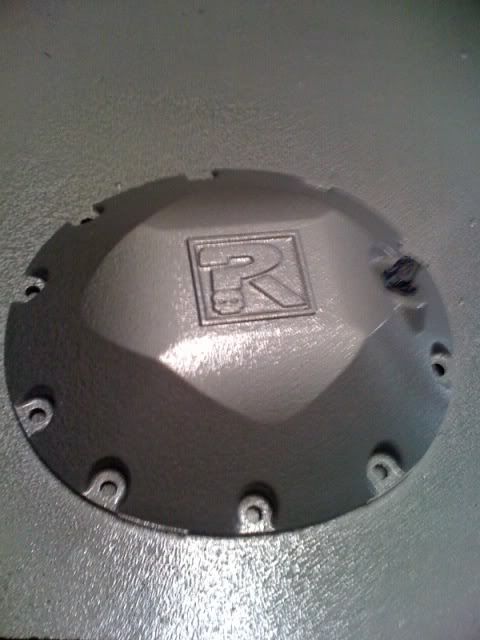

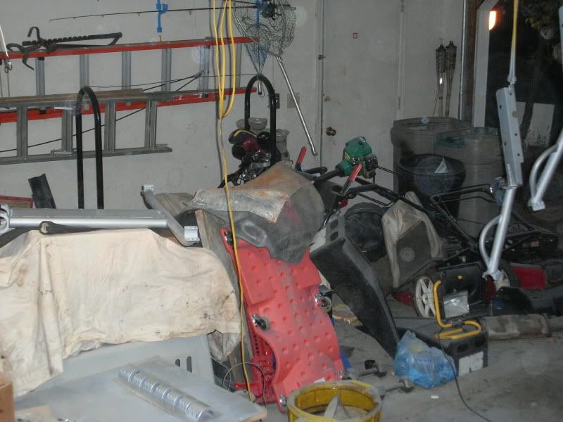

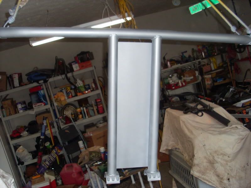

Newest additions to the heep.
Rockhard cage...in the process of paint. Install tomorrow.
Riddler cover...
No pics of it installed...I'll get some.

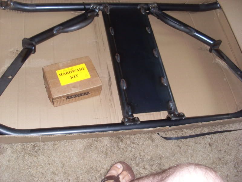

Finished my sport cage install today. Went very smoothly for the most part, until the very end. I couldn't get my windshield bolts to line up on the driver side...so I sorta forced the issue. But in the end it all worked out.
The install is very straight forward.
T-bar first. I just cut notches on in the padding as you'll see in the second picture.
Then comes the windshield channel bars, or whatever you wanna call them...Getting these to line up so you can get your hard upper surrounds on is just a matter of getting the clamp ALL THE WAY FORWARD up against the windshield frame. I used a rubber mallet and a towel. I held the towel so I wouldn't damage the paint and I just pounded it until I got it lined up (yes it scratched the paint as it moved )
Once you get the one side in place you put the windshield spreader bar in there, don't clamp it just yet though...Cause you need to put the other windshield channel in there.
Then you just clamp it all together (the spreader just goes as low as you want, I left a slight gap between it and the dash, about 1/4")
I like it, you don't lose any headroom and you can for sure tell a difference in the rigidity.
Any questions regarding the install or anything, feel free to ask.
